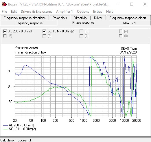

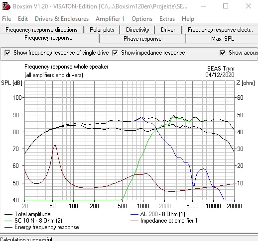

Anyhow, ran the old Visaton Boxsim up the flagpole with similar drivers to the SEAS TRYM. If you use the T35 tweeter instead of the T25, you just change the 3.3R/22R attenuator to 5.6R on both legs. Seems to give 6dB attenuation. Curiously the notch wasn't quite where I expected it to be. But SEAS know what they are doing.

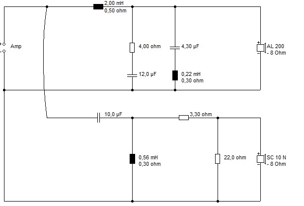

Original circuit:
One of my more demented efforts:
And another one:

Can you post the current crossover used with the morel? I can design a crossover and can try to optimise the parts (re-use what you have).
I personally wouldn't pair these to drivers as the 3rd and 5th order distortion will come through from the W22 in the midrange... maybe that's where your problem area is and you are blaming the tweeter?
In anycase - happy to help you.
Thank you for the offer Dave but this old crossover is consigned to junk. Wasn’t even able to ID the inductors as there were no markings on them. New crossover will be a quality build.
