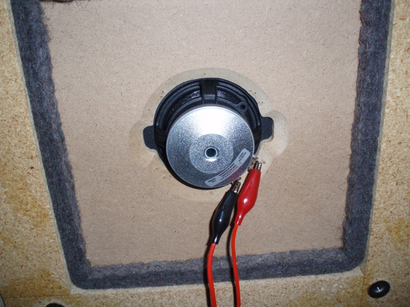

6" not 5" sorry typed it wrong.Baffle is 5" in width. Around 150mm(15cm)
Is installing a 132mm driver on 150mm baffle bad.
You only need sufficient air-flow and mounting.
Note: with smaller drivers (actually any driver without a substantive low-pass 500 Hz or lower), you are often best off doing a chamfer to the rear of the baffle around the driver inset. This largely avoids resonant conditions.
