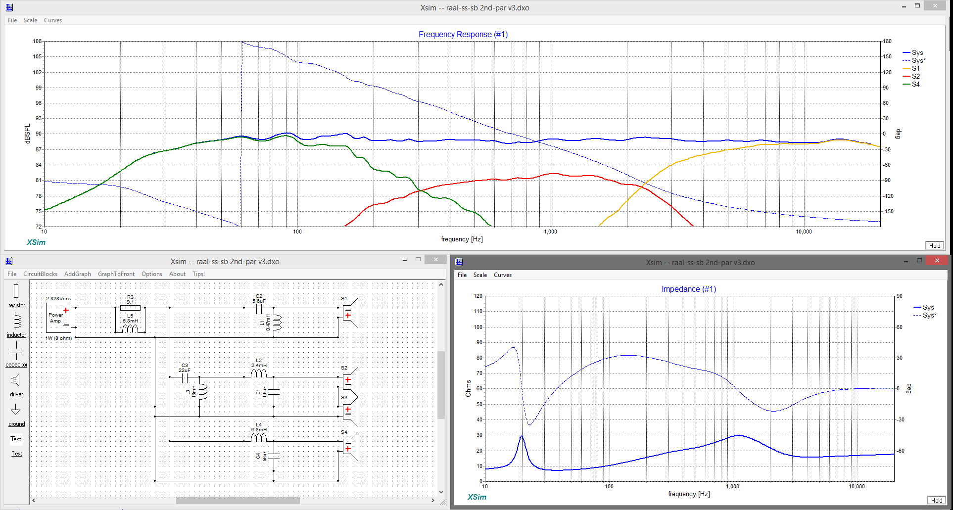

I don't think that is a better solution. Because you're pushing both drivers to it's frequency limits to make them meet. This will have a lot of resonance peaks arround the crossover frequency. With the Scanspeak/Raal combo you have more space to put the crossover, and less peaks wich gives a more flat and in phase response and impendance. About that distortion below 300Hz you're right, but then better find a sub that can high enough, in the last example i use a SB acoustic sub that can do that, i've adapted my rough draw for the CR so you can see that.

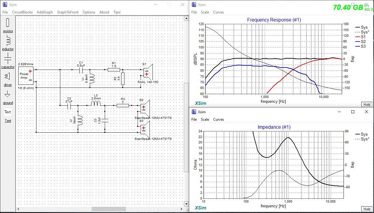

I tweaked it a bit to use ScanSpeak 12MUs as Mids and clip them at around 200Hz.I went, just for the fun, a bit further with your id and added a subwoofer. The driver is the 12″ SB34NRX75-6 and i would put it in a 75L sealed box for this. That should give you an F3 of 36Hz and a F10 of 23Hz. And the crossover would be like this.
Just throwing arround with ID's. And again, this is a rough sketch, use it at own risk.
Is it the right thing to do or will it better to just let them roll off.
The high pass filter on the scanspeak looks ok, but i would not use a straight resistor on the midwoofer, if you need to attenuate it, use an L-pad like i use on the tweeter. It puts less heat on the resistors and attenuate smoother. And it's actually not needed, just optimise your curves a bit and the response is smoother
That is great.
Now getting back to point, as I plan on using Sub-woofer for low end will it be better to clip the mid-woofer at 200Hz or should I let it be.
That is great.
Best is to build a sub that can go high enough to crossover it at 300Hz and use two standing under your left and right tmm speakers. You can do this active with a dsp or a analog active crossover. Or you can do it passive like i did in one of my examples above (but then your centerspeaker will also need a sub to keep up with the topsection).
The driver i've used, wich is fit for that is the very good 12" SB Acoustics SB34NRX75-6 in a 75L sealed box. it efficiency (90dB) and power (200w) makes it fit for active and passive crossovers, and it goes low in a sealed box (wich i like) But many other options are availeble if you like it different.
Using multiple subs will take up lot of space in my room. Instead I can go single large sub enough to cover entire room. Will it be fine.
Not if you crossover that high, so if you insist one one sub, you need a different bassmid driver that can go low enough (+/- 100Hz or lower) to avoid messing up your stereo image.

With all respect, but you are searching for the impossible. You want it small, low and loud at the same time, you can only choose 2 of those 3. A 4" that reach 100Hz in +/- 90dB efficiency does not exist, as this is physical impossible.
The closest you can get is a 6" i think, something like the SB Acoustics SB17NRXC35-4 or a FaitalPRO 6RS140. They go low enough, are efficient enough and will make it work to use a sub below 100Hz.

Note though that the Scan Speak mid.s really only provide about 600 Hz higher low-pass than the Zaph driver (..2.5kHz vs 3.1kHz, and even then - the higher in freq. you go the worse the combing artifacts), but they do have lower odd-order distortion in the upper midrange/lower treble.
The Viawave ribbon is still the better ribbon for this design.

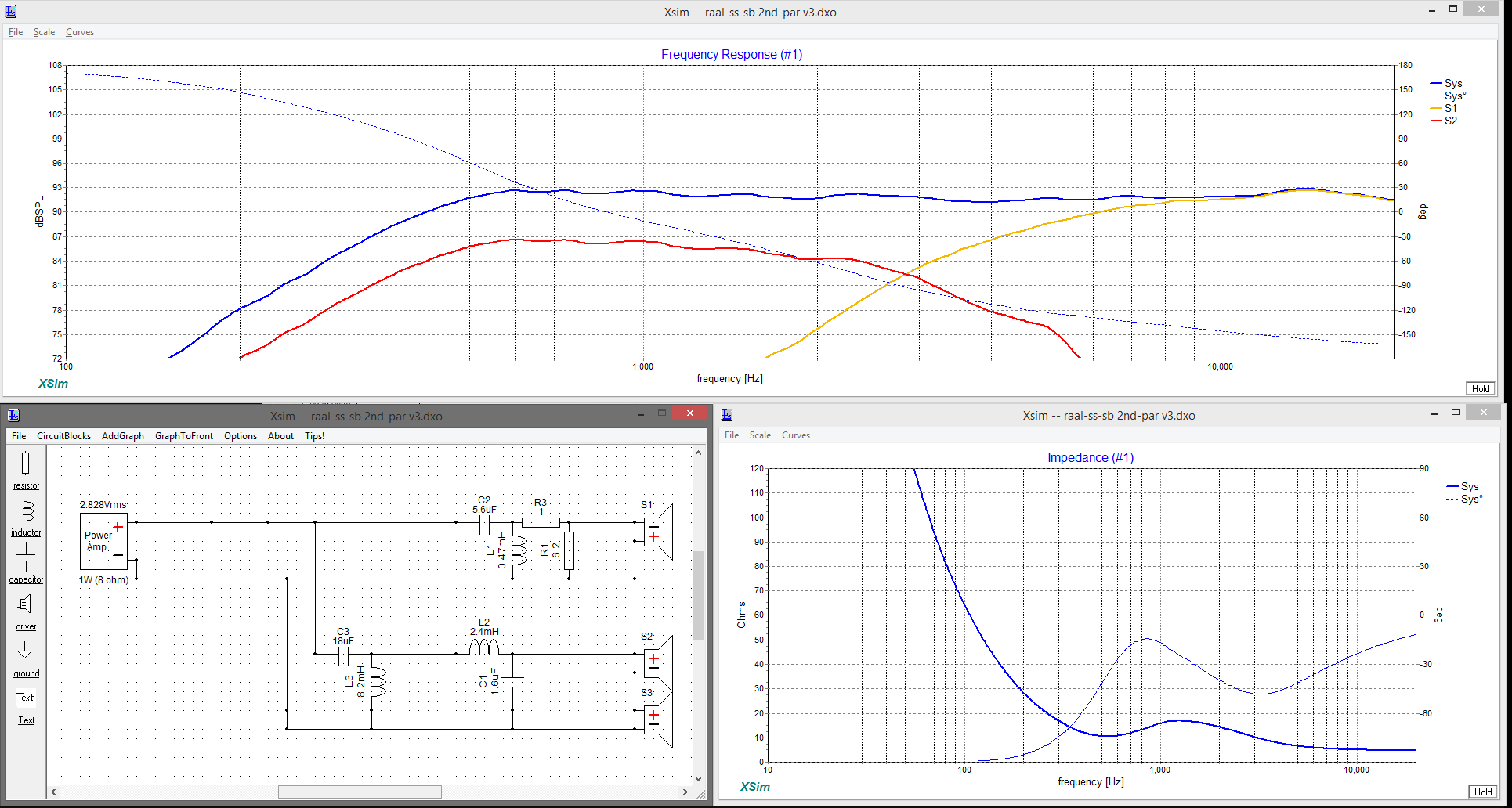

Isn’t a high x-over point a bad idea anyway with an MTM? That Raal is already 140mm, giving a C2C spacing of about 20cm, giving around 1700Hz.. to avoid lobing, you should cross below that.
-yes, the "combing" issue I mentioned.
It's a progressive effect (worse higher in freq.), and you can minimize it by off-setting the tweeter and pushing the 2 midbass's with their frames nearly touching together. You can even improve upon any diffractive effects from the tweeter in relation to the midbass drivers and the overall diffraction elements of the baffle/box/wall by making the midbass drivers horizontally off-set from each other.
ex. I8 (left) 8I (right), and the offset can help with a bit of delay for the crossover depending on the design and in relation to the listener. "I" = ribbon and "8" = two midbass drivers on top of each other (..vertical)
Lower freq. crossover is of course better, and a faster "slope" for the filter is also better.
- Crossover for RAAL 140-15D x ScanSpeak 12MU-4731T0
