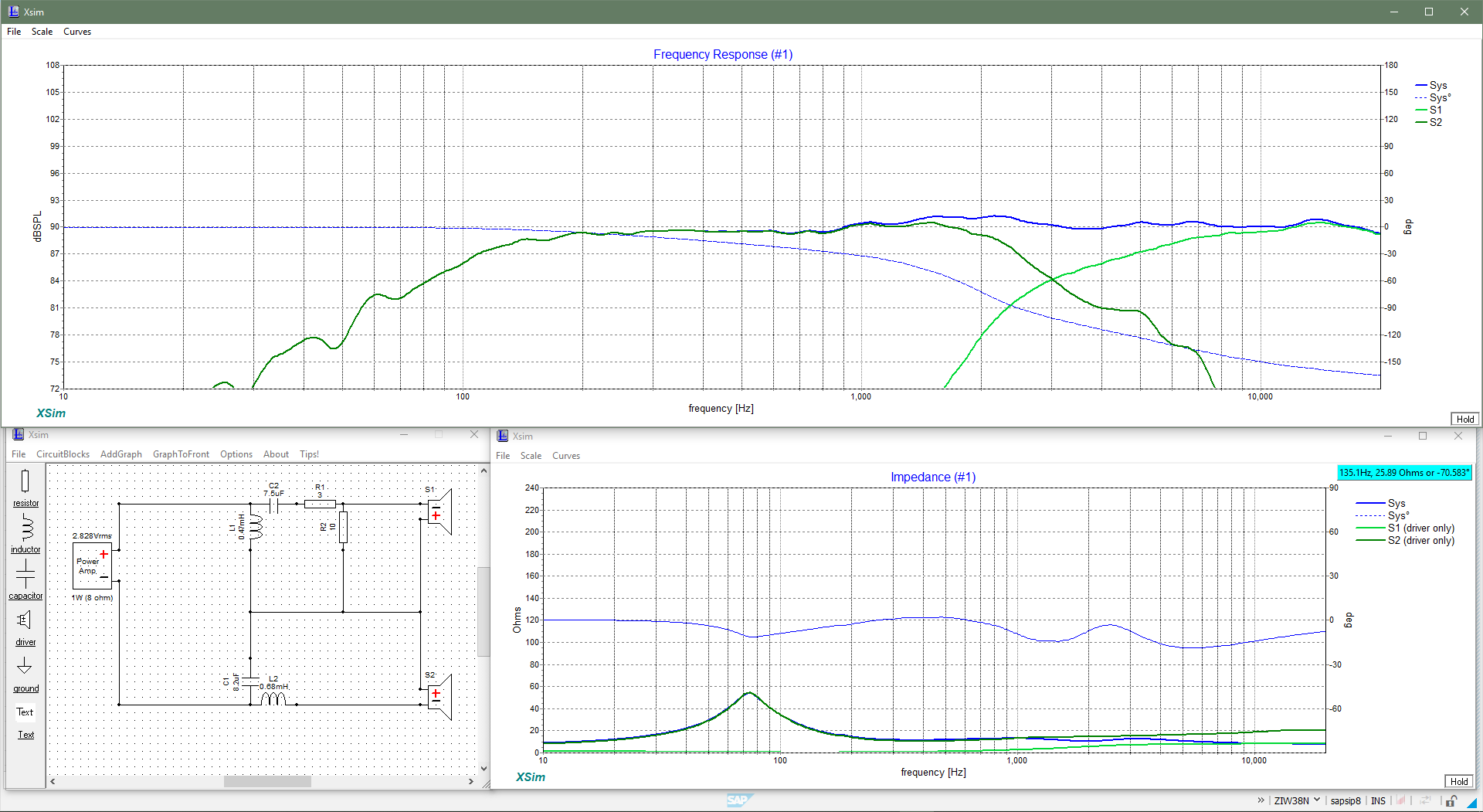

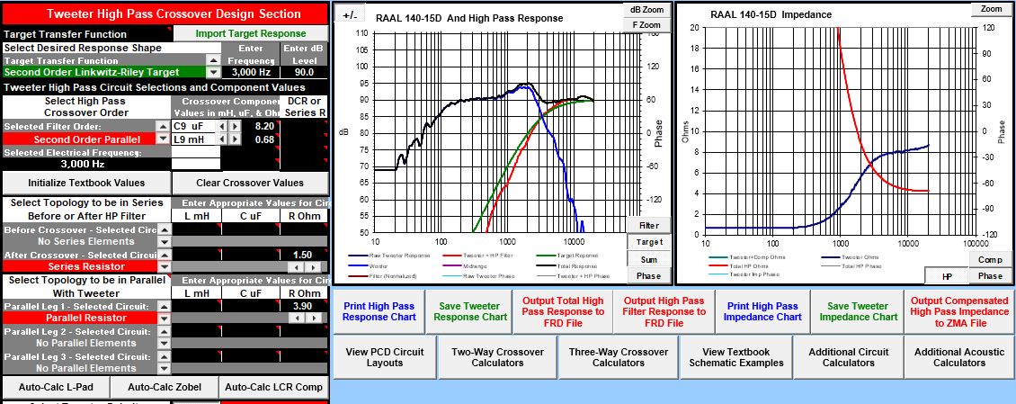

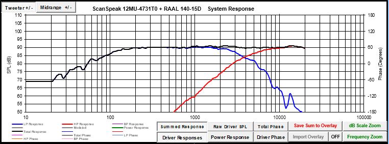

Well, i did a fast rough sim for this setup of the OP (more out of curiosity) and get this rahter ok response, as long as you add a woofer for below 200Hz. I included the zip file with the xsim project i made for this. This can be a starting point for a crossover, but it's definitly not finetuned, and you can use it at your own risk.
Thank you very much for the input. Would like to stick with parallel setup as for starters series crossover will make it more complicated.Well, i did a fast rough sim for this setup of the OP (more out of curiosity) and get this rahter ok response, as long as you add a woofer for below 200Hz. I included the zip file with the xsim project i made for this. This can be a starting point for a crossover, but it's definitly not finetuned, and you can use it at your own risk.

Well, no problem, while i was on the train home after work i had some entertainment messing arround with it...Thank you very much for the input. Would like to stick with parallel setup as for starters series crossover will make it more complicated.
Again, this is a rough sketch, not a fine tuned crossover, and use at your own risk...

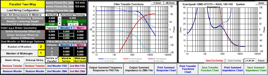

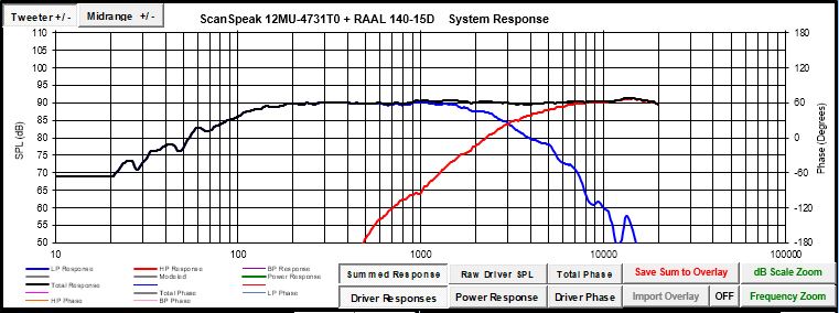

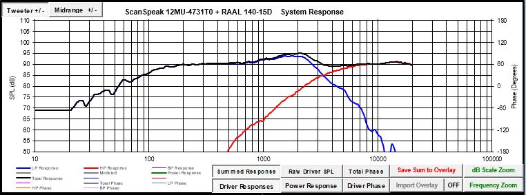

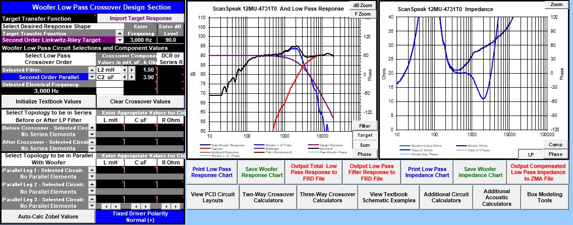

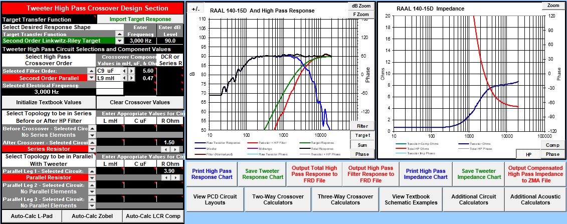

The result of your value:
Tweeter + Woofer(Perfect)
But as I plan to pair two woofers in series it is bit off.
If tweaked a bit it can be done.
But I would like to know the reason to cross it at 3000Hz and not at 2000Hz. Wouldn't it be better to cross it at 2000Hz specially for that ScanSpeak woofer and even RAAL tweeter is also known to do fine with that low crossover range unlike some lower end ribbons. Is there a reason for that which I need to understand.

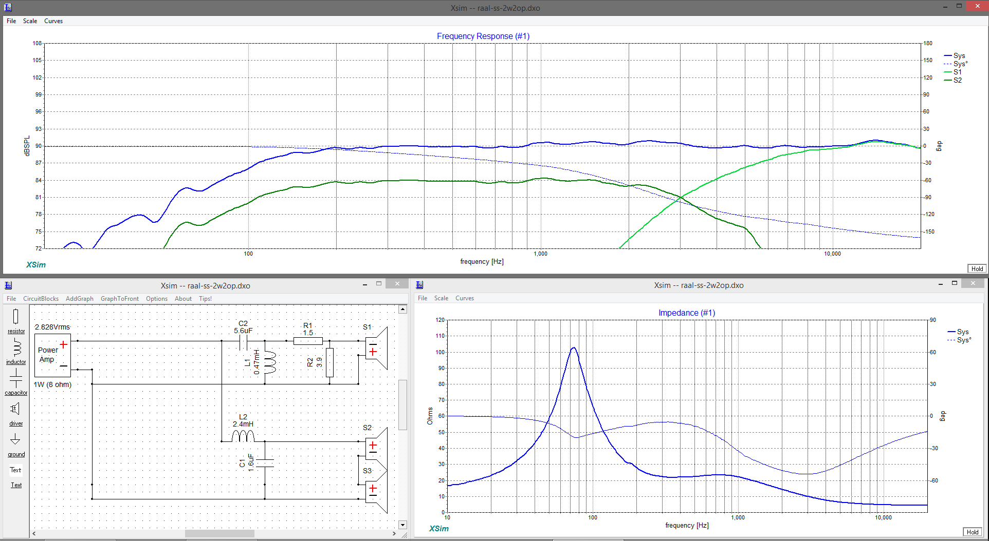

Because i don’t like to push ribbons to low. They sound better if you don’t...
And i did model with one driver, i can redo that for 2 also if you want to make an MTM.

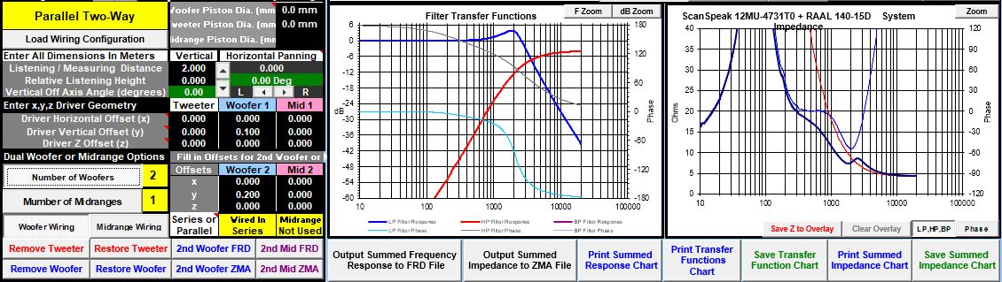

Yes Perfectly DoneThis should be it with 2 woofers in serie, and working for MTM and TMM setups
Thank you very much.
I will be taking this as my base point and working it up to perfection with drivers after finalizing and purchasing them.

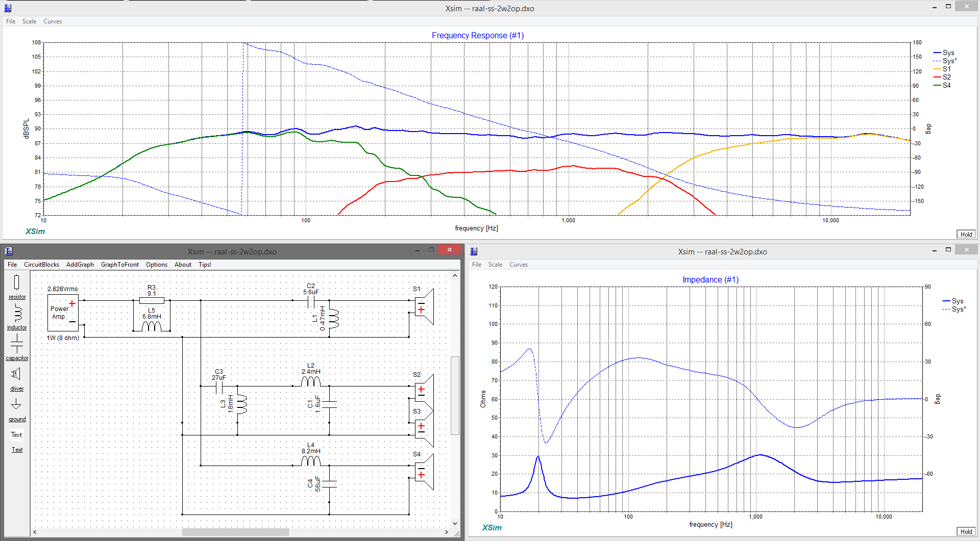

I went, just for the fun, a bit further with your id and added a subwoofer. The driver is the 12″ SB34NRX75-6 and i would put it in a 75L sealed box for this. That should give you an F3 of 36Hz and a F10 of 23Hz. And the crossover would be like this.
Just throwing arround with ID's. And again, this is a rough sketch, use it at own risk.
