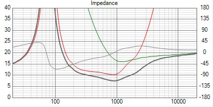

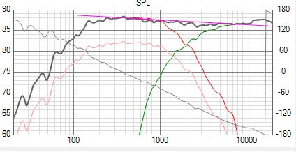

Crossover for RAAL 140-15D x ScanSpeak 12MU-4731T0

Yeah it can be fit into smaller enclosure but with roll-off at comparatively higher frequency. As it is Satori rolls-off at around 115-120Hz and Accuton at around 95-100Hz. Going any higher will be bad as I have been told going any higher than 120Hz on Sub is bad(correct me if I am wrong).
Yes going higher is not always good. But as long as I can get the best with little of improvement from its competitors I can spend as much as required let it be high or let it be low. So, yes if there is recommendation that outperforms ScanSpeak or Accuton or SB Acoustics drivers listed above for lesser budget I will take recommendation. Not the performance per buck, they should outright perform better in producing more transparent and clear voice.
You can go up much higher in freq.. it's not a physically disconnected driver from the mid. and tweet, instead it's next to those drivers. Additionally, these are small diameter drivers with very good upper freq. extension.
I personally wouldn't take them higher than 800 Hz, but it's up to you.
In that respect, most of the "character" of a driver (beyond eff./force effects) happens above this freq..
If it were me (with a near-wall) placement, I'd be looking at what performs best as far as integration with the midrange in relation to the diffractive result of the freq. response from the midrange. (..in other words, measure what happens when the mid on the box is placed on a wall w/ a 6" depth and a tiny baffle.)
I was talking about Sub-woofer when I said the max frequency going up to 120Hz.
Yes the Mid-woofers will be integrated along Tweeter and Midrange.
I think I will crossover Mid-woofers at 300-400Hz depending on what I finalize as drivers.
Yeah will have to consider the baffle which is 6" width and 6" away from the wall. There is not enough space at the back of the enclosure for the waves to get trapped and not be deflected forward.
I am still unable to decide on midrange drivers as finding one which is transparent and clean is hard. But I think as ScottG quoted earlier Accuton is more transparent and clean than ScanSpeak while ScanSpeak is much warmer and natural. I think as I am aiming to get transparent and clean highs I might as well get Accuton which is more transparent.
As of mid-woofer I think I am more inclined towards Accuton C158-6-851 as it goes as low as 95-100Hz even with sealed enclosure of 2.3-2.5L. I think it would be better as I can limit the Sub-woofer to 100Hz so that localization effect is negated to some extent.
"warm" is more a function of freq. response. Neutral is perhaps the better term for the Scan. Again, though - ask HiFiCompass: he has some experience with both.
Note: with the 3-way with 2 suitable midbass 5"s: you don't need a low-pass unless you are playing them extremely loud with music that has wide-range dynamics. Those 2 5" are the equivalent of a 7" driver. If it's in a sealed design with a small volume then the natural pressure loss alone likely wouldn't require any high-pass at all. The mid. still needs it though.
Sub result then: maybe 70-80 Hz low-pass.
