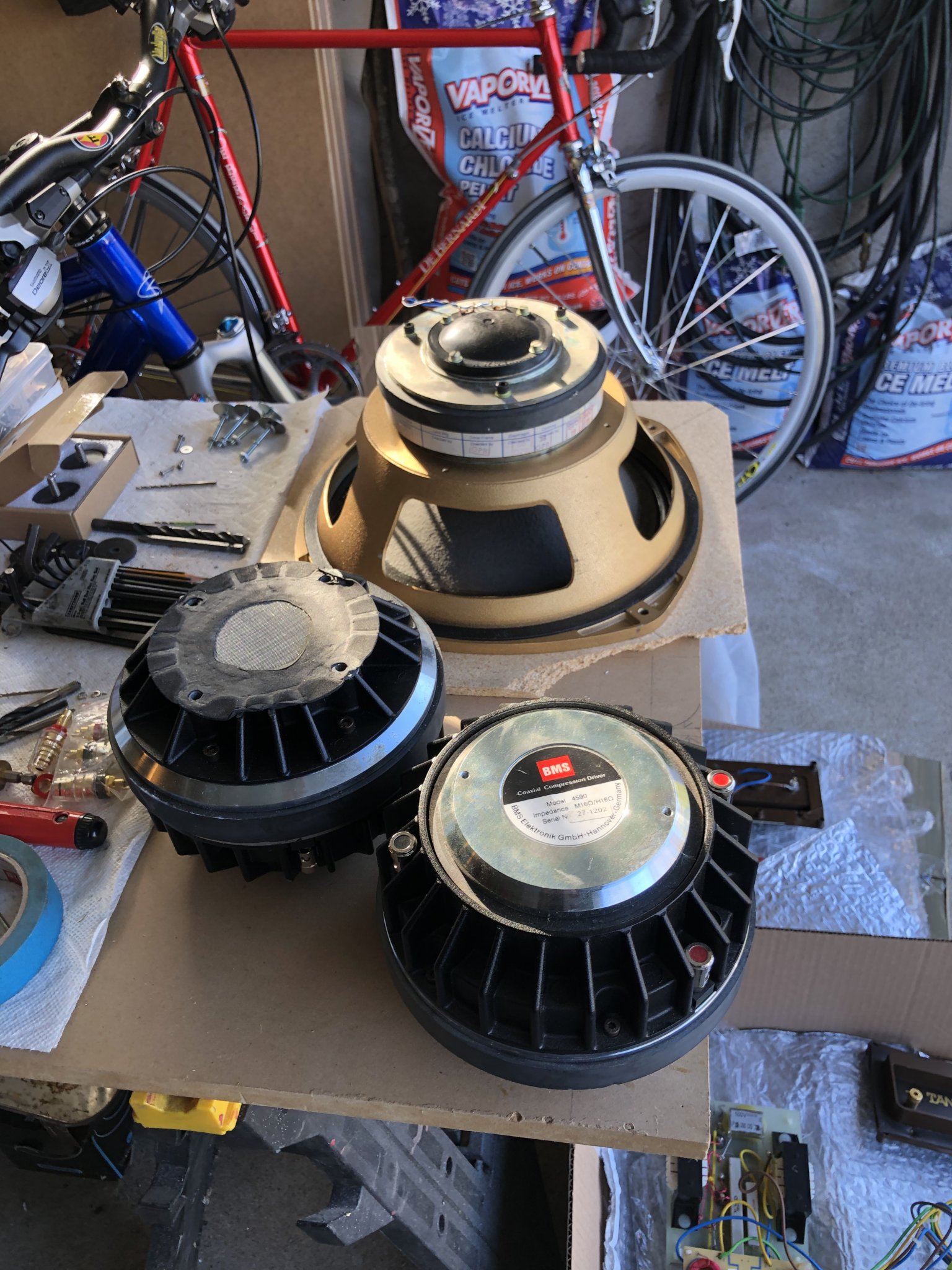

I just came into a used pair of the 4590 I’ve wanted to try for a while along with a second set of horns.
Personally, I’d rather end up with an active system using some of the Bi Amp crossover kits I have stashed…but I have to start somewhere and my second amp for Mids/Highs isn’t finished yet.
I have a MiniDSP to test with, but don’t want to use it as a permanent solution as I find its noise floor is too high with such sensitive drivers.

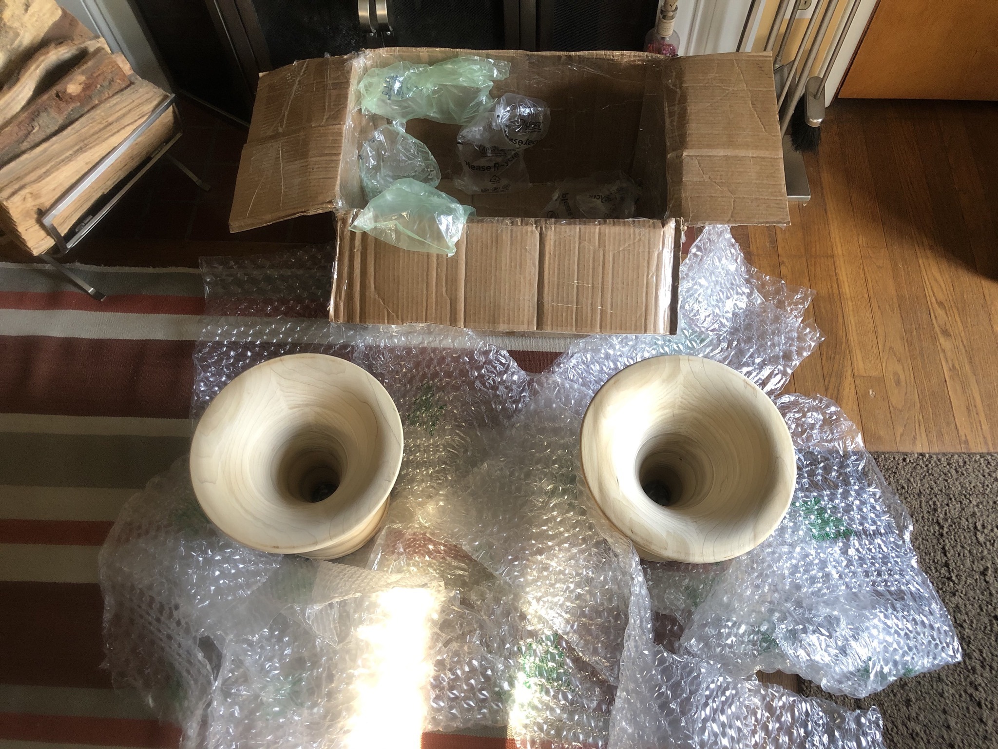

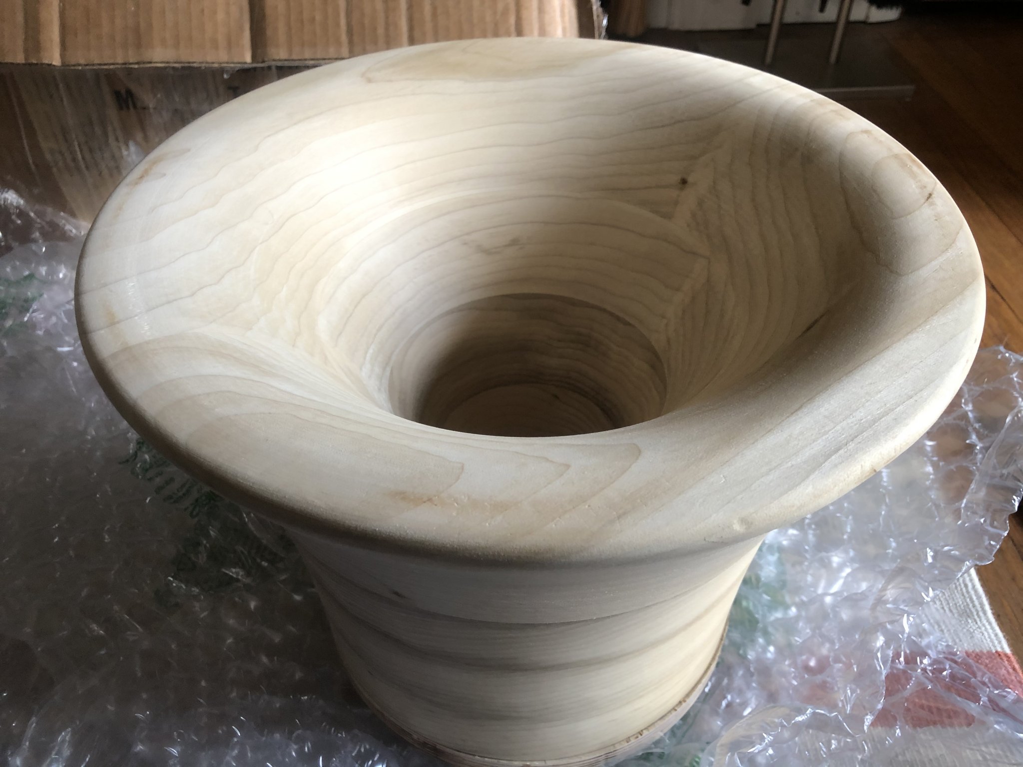

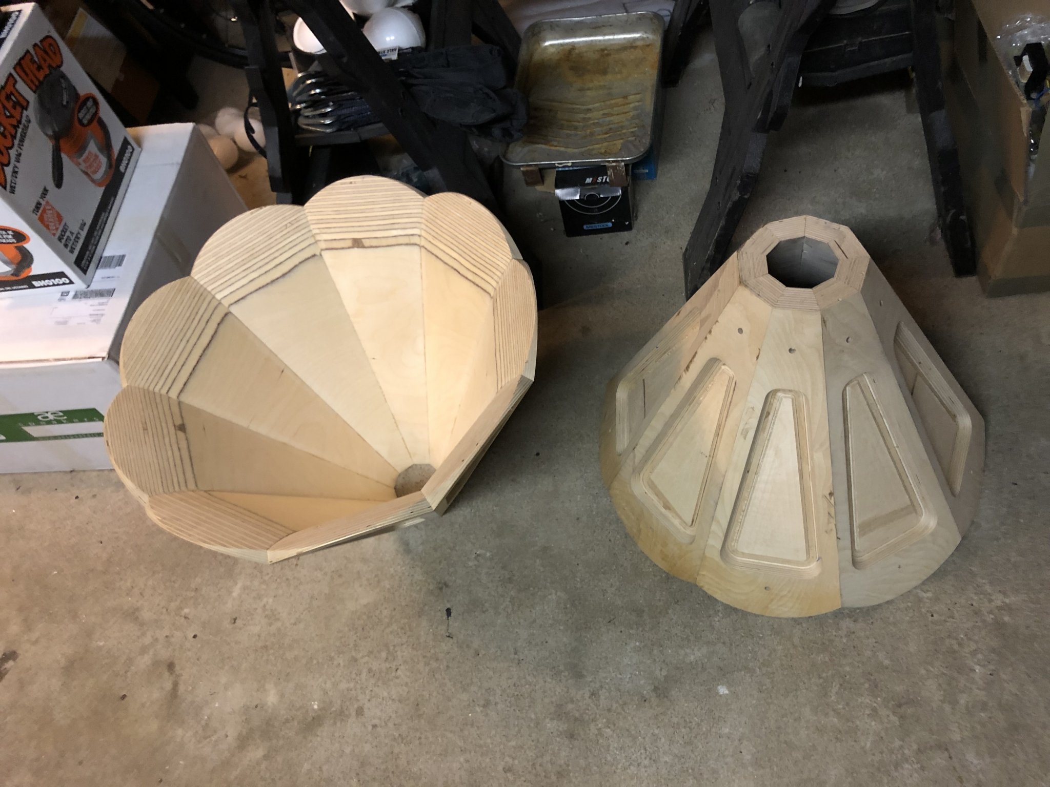

I have to make a throat adapter for the conical, but I also have a pair of Edgar horns (salad bowls) with 2”throats that should bolt right up. They are supposed to be a Tractrix 330-350Hz profile I believe.

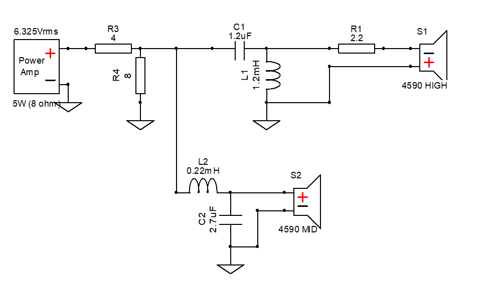

OK, here is a crossover that should get you started and at least playing music. Don't spend a lot of money on parts, just get normal quality, like Solen Jantzen, etc. At this point getting the crossover values correct will have far more influence than the quality of the parts. This is an easy build.
You will L-Pad to attenuate the horn (shown as R3/R4) down to your woofer level. I suggest using one anyway even if you have a separate amp for the BMS because it will help raise your S/N ratio. In this case DO spend some money on the L-Pad, as the cheap ones don't work well. When it's all dialed in, you can replace the L-Pad with high quality resistors.
This schematic shows the tweeter section in reverse polarity. That works best from the published specs, but in my measurements the tweeter in the same polarity summed better.
You can adjust or bypass R1 if you need to change the level of the highs above 6 kHz.
This crossover is something that should work well, but it is NOT optimized. For that you will need to measure both the acoustic response of your horn, as well as the driver impedance and do a good bit more work. The software and help are free, the measurement hardware will cost you a few hundred dollars. These BMS coaxials are very clean, very good drivers. It's worth the time and effort to get the crossover right.

just a curiosity does it work on 4592nd?OK, here is a crossover that should get you started and at least playing music. .......
It should for 8 ohm. I used the measurements of my 4692 as a double check. It won't be exact, but it should be a good start. You'll need to measure and tweak to dial it in.
sorry for hijacking the thread.It should for 8 ohm. I used the measurements of my 4692 as a double check. It won't be exact, but it should be a good start. You'll need to measure and tweak to dial it in.

Sorry if I missed it, but was this crossover designed for 16 ohm drivers?OK, mine are also 16 ohm, but I could not find any impedance measurements that I have run. I'll see what the published impedance looks like.

I don’t remember if the passive crossover was for 16 ohms. I would hope so! 🙂
