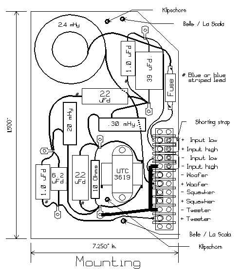

I just made a crossover for BMS-4590. It works very well.
I thread, but the image from amaco is no longer hosted. Any chance of a reupload for inspiration?

- Crossover for BMS 4590 driver
