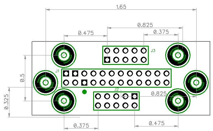

Is there any interest in a Cronus/B3 to Teleporter adapter?
You would use one at the Cronus with a teleporter connected to J2, and another connected to a B3 with teleporter connected to J3. In this situation the Cronus powers it's teleporter - and the B3 powers it's teleporter (both with 5V)
For those not using B3 you would just use the one at the cronus and then just direct wire the teleporter to the DAC.
The adapter is wired to transmit MCK, DCK, D1, D2 from cronus.
Using Teleporters is one of the options I have been considering. I thought you could just hook up the I2S wires but if an adapter makes it easier I would certainly be interested.
I've been thinking more and more about a pair of teleporters; this certainly solves my "where to fit all this in my existing enclosure" dilemma. Plus, it would allow the BBB-TP appliance more flexibility. An adaptor board that keeps the i2s lines as short as possible seems ideal.
Yes please!

Not really related - this would simply make it really easy to connect a Teleporter to Cronus/B3
You could use an OTTO-II and Two pair of Cronus(with their respective Hermes)
Doing a multiplexer between the Cronus and the Hermes modules may come at some point - but has some challenges of it's own. 🙂
I added pinout descriptions for the Hermes and output side headers to the first post.
