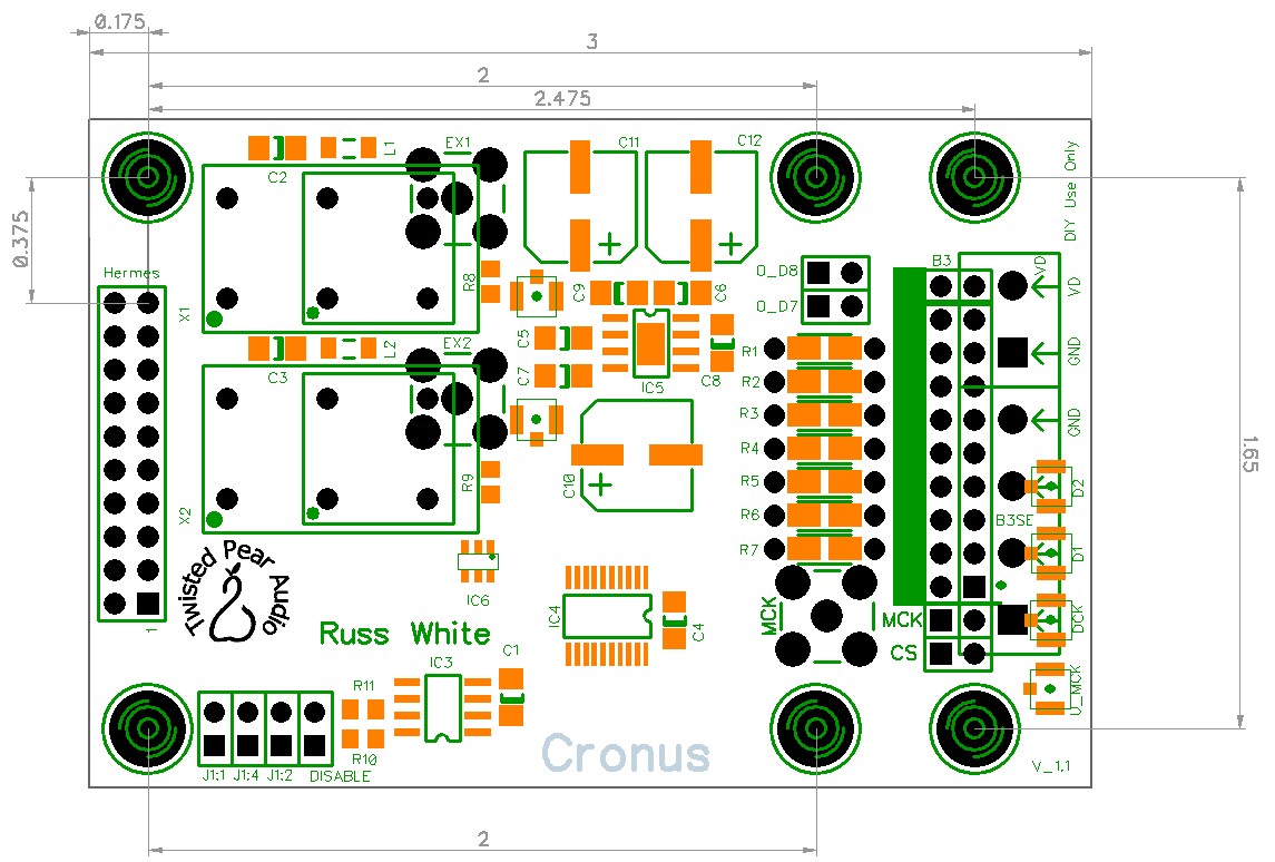

Here are the conus dimensions for planning:
