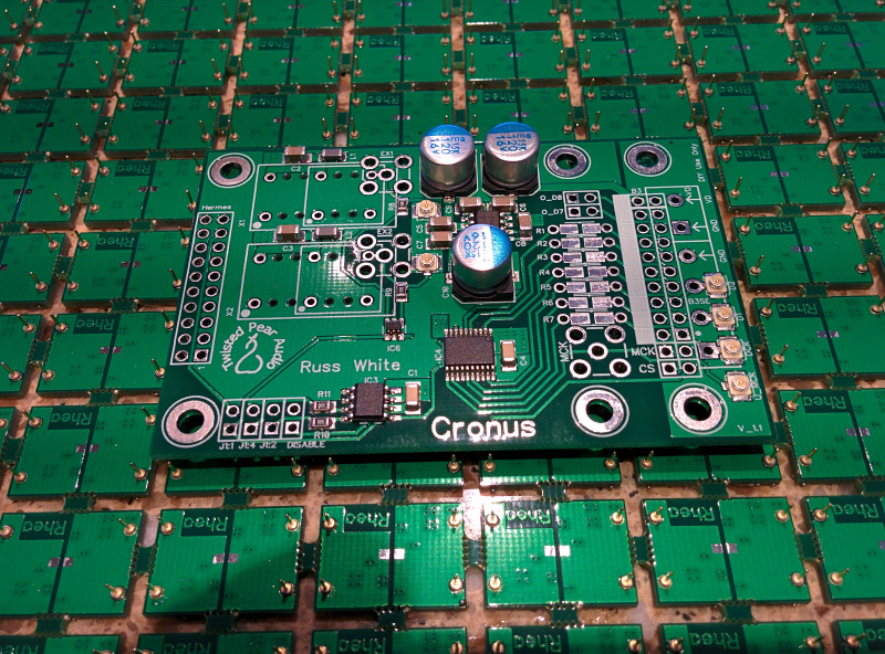

Here is a picture of an assembled Cronus I took this morning before running off to work.
attachment.php
These are your clock input options:
  • SMT clocks mounted on Rhea modules
  • 8- or 14-pin through-hole clocks
  • External clocks via u.fl connectors
  • External clocks via SMA connectors
Signal output can be via u.fls, 0.1" header (we will supply stacking headers), or terminal blocks.
Stacking header mates directly to 8-channel Buffalo, which will also supply power through Buffalo's VD supply.
MCK outputs are via pin headers, u.fls or SMA connector.
Output signal termination resistors will be supplied as through hole (mini resistors) and SMT parts to allow easy customization for your application, in case you need a different value.

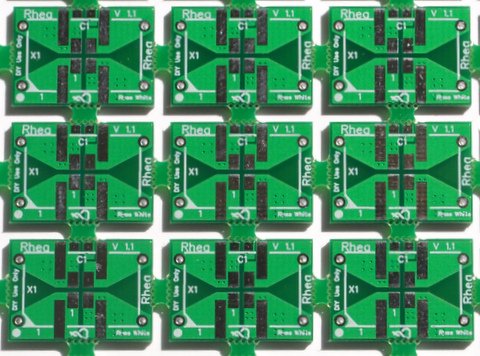

And here is the top side of Rhea - which may answer the question above. 🙂
You can use 5 x 7 clock and the larger Crystek CCHD-9xxxx clocks as well as the small NDK types. There is a spot for optional (some clocks may need it) local bypass cap on top and on the bottom.
