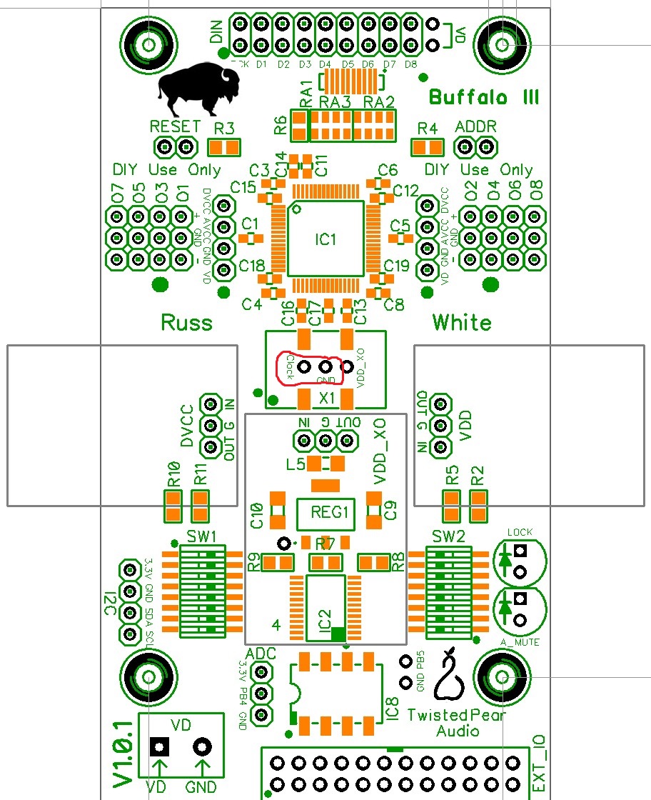

BIII input clock?
It's not clear how to connect the Chronus to BIII, of course I have to disconnect the VDD XO Trident reg. but where have I to connect the clock Chronus to the BIII, like in attached pic red circle?
It's not clear how to connect the Chronus to BIII, of course I have to disconnect the VDD XO Trident reg. but where have I to connect the clock Chronus to the BIII?
You don't have to - but if you want to (which is more complex DIY effort) you will access the clock header directly under the clock. I would strongly recommend you run async (keep the clock on the B3) until you are quite sure of what you are doing.
So to use the Chronus I have to take off the Trident regulator and use the clock header under the clock marked in my pic.
No you don't have to! (and you probably should not if you are asking the question) You only ever would if you want to use an external clock (which is not always the best). I would strongly urge you not to with your B3 - at least to start. If you have a B3SE is is simpler to use the external clock but my advice would still be the same until you have a strong degree of confidence.
No need for confusion - It is a capability - but it definitely is not the *main* idea. As I said earlier there can some distinct benefits to running either async (with a ES9018) or synch. You need to choose the right path for you. 🙂
The main feature is providing suitable sources with a high quality clock in the correct time domain - then making sure the audio data itself is jitter free and time aligned. It is a much bigger concept than just having the same master clock at the DAC (especially when an asynchronous natured DAC like the ES9018 is involved).
The important thing is to stay within your zone of knowledge and capability.
