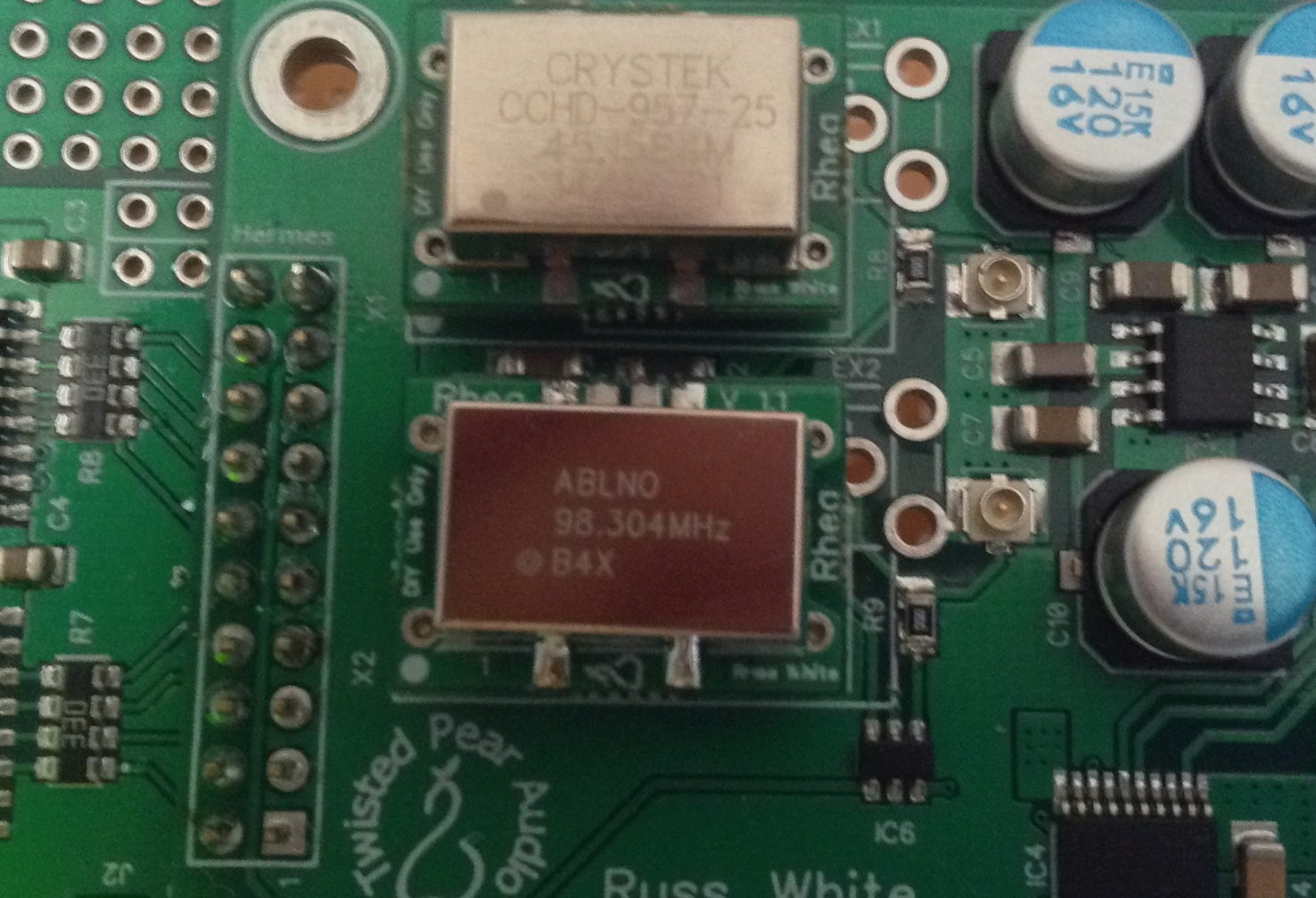

Hi Russ,
I applied a 98.304MHz VCXO (ABLNO) to the Cronus with J1:4 and confirmed the H/W divider on the board to work beautifully as previously suggested by you.
However, as expected, there was a trade-off to change the playing speed of other sources with different multiple of basic fs.
This can be solved by implementing a pair of H/W dividers which can deal with 48k and 44.1k sources, respectively. I hope this proposal will be included in your to-do list.
Thanks.

Hi Russ,
Thanks.
I probably would not do this - there are good reasons why.
Most important is because it is intended that the clocks be made available to DACs as a synchronous master clock. You would not want to mix ratios in that case because some DACs have very different configurations for clock rates.
Better would be for you to just get another clock of the same multiple. 🙂
Then your DAC will be dealing with master clocks in the same range.
There are other reasons as well - but this is the most important.
Cheers!
Russ
