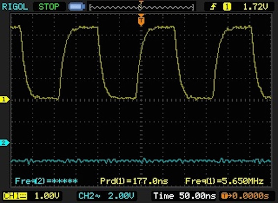

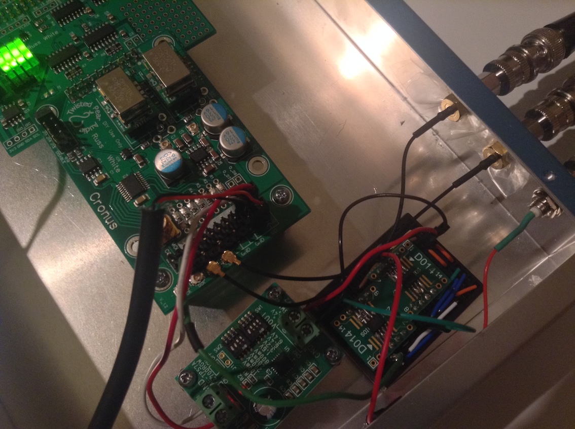

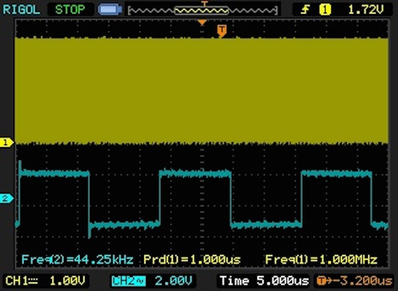

Hi there,
Besides B3 and B3SE, I’m an avid user of Stereo 192 DSD Dac from Mytek. The mastering version of this Dac has DSD inputs for SDIF signals (BNC) on the rear panel and I’ve already confirmed there was no problem with SDIF (both of SDIF-raw and SDIF-3) connection to it from BBB with Botic drivers as posted before.
This time, I set up the same SDIF connection of DSD128 sources to the Mytek via the Cronus board taking an advantage of ready-to-use uFl housing which can provide easy SMA-BNC conversion of D1 to DSDL (left) and D2 to DSDR (right) as shown in the first figure.
The word clock was obtained from DCK by a pair of clock dividers (ICS542 from IDT) with 5V/3.3V conversion from the VD on the board as shown in the figures. The result was quite satisfactory and I could enjoy the stable sound of DSD128 under rock-solid locking of signals.
This may be a rather anomalous use of Hermes/Cronus boards but I’m quite happy with the results. Any comments, particularly on the possibility of uFl-BNC impedance mismatch or selection of WCK sources (MCK or BCK?) will be appreciated.

Excellent! I am very glad it suited your purposes nicely.
As to impedance - they should be close enough as to not create any significant issues at all. Your scope shots look great!
Hi Russ,
Many thanks for your kind words. Appreciated very much. BTW, I always use a 75Ω terminator at the other end of WCK cable.
