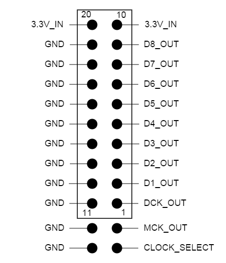

Sorry, I should have been more specific. I meant the connectors on the Amanero and the Hermes. I'm not 100% sure that it's all connected properly. I'm not keen on these stacking connectors, as they're not very flexible in terms of mounting options and I find it difficult to make sure the right pins on one board are going to the correct ones on the other. They're also really difficult to desolder if you need to move them!

Could you connect directly the phones to Chronus output D1 & gnd (one channel) output D2 & gnd (the other channel). Amanero has to be configured as slave and MCLK input Amanero connected to MCK out of Chronus.
