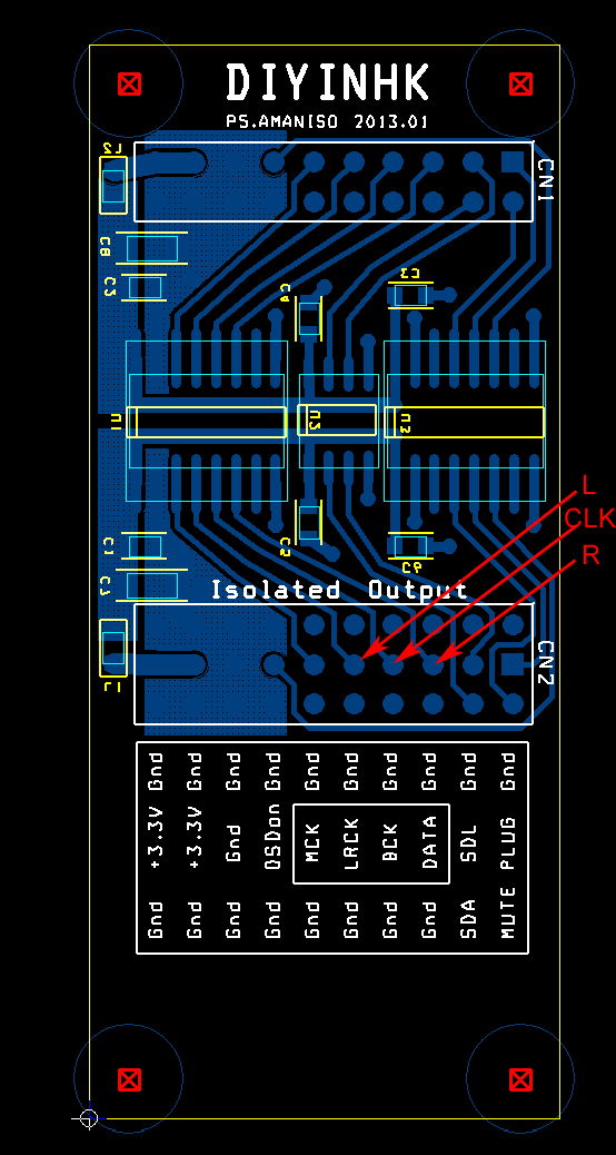

With the confinament I started mine long journey to install the Chronus but I can't listen nothing!
My setup consist: Amanero + I2S isolator + Chronus = noDac
Amanero is connected to I2S isolator properly:
-POWER from Amanero
-FSCLK
-BCLK
-DATA
I2S isolator is connected:
-POWER from Chronus pin 19 gnd & pin 20 3.3V to isolator
-FSCLK from isolator to pin 12 gnd & pin 2 D1 Chronus
-BCLK from isolator to pin 10 gnd & pin 1 DCK IN
Chronus is connected:
-DCK ufl connector to MCLK Amanero?
-D1 left channel output
-D2 right channel output
-One jumper is set to MCK+
-The other jumper is set to J1.1

I am not sure what you mean by "isolator"? Are you just referring to the stock:
Amanero-Hermes-Cronus stack, connected together by the stock pin headers?
A picture might really help here.
Because you are using a NoDAC, which I am not familiar with, can you give some explanation of what it requires for input? For example, does it just take:
DSDR
DSDL
Bit clock
For input signals?
Again, a couple pictures could help. What DSD rates are you feeding it, and what firmware are you running on the Amanero? And, are you sending DoP or Native DSD from Daphile?
I'm not using Hermes, I'm using diyinhk isolator attached pic of isolator.
noDac not requires clock only needs DATA & FSCLK, the Chronus clock is for Amanero configured the cloks as slave.

When you run the Amanero as "slave", the masterclcok from the Cronus has to connect back to the Amanero-looking at the connections you note have through the isolator, I do not see any mention of the masterclcok going from the Cronus to the Isolator and then to the Amanero?
Why not just use the Hermes as designed? That would seem to be an easier solution, and more likely to get working easily.
The masterclock output from Chronus goes directly to MCLK input of Amanero.
From Amanero outputs onlye goes BCK, FCSLK & DATA to DIYINHK inputs.
From DIYINHK outputs BCK, FCSLK & DATA to Chronus,
From Chronus outputs FCSLK & DATA to LPF noDac channel left & right, Chronus output MCLK direct to Amanero input MCLK.

Have I to connect the Chronus MCLK output to MCLK output DIYINHK isolator? And from input MCLK DIYINHK isolator to input MCLK Amanero?
I have no experience with the DIYINHK isolator, I use Hermes. But that is how the Hermes works, all lines go through the isolator.
By connecting the masterclock directly you defeat the purpose of the isolator, as it the Amanero is then directly connected to the Cronus via the clock and ground leads. If it were me, I would run all the lines through the isolator, otherwise there is no benefit to using it. With 27/24 MHZ clocks, make sure the clock divider on the Cronus is set to 1:1 as well.

Why files 16 and 24 bits sounds a little bit fast. I'm using 22,xxx and 24,xxx clocks all files are upsampled to DSD256?
Speed (pitch) has nothing to do with bit rate, it has to do with the clock frequency. X-1 should be your 22.xxxx clock, and X-2 should be your 24.xxx clock.
If they did not work this way, perhaps you had them in the wrong orientation? The dot on the clock itself should match the dot on the Cronus board.
