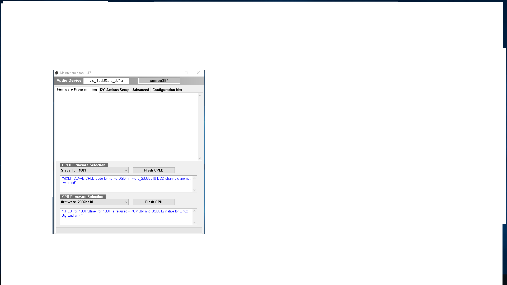

@ barrows, what settings firmware do you use for Amanero?
Last news I have from Amanero:
CPLD
Slave_1081_DSDSWAPPED
CPU
firmware_2006be10
Have I to change the Configuration bits or something else more?
TIA
Felipe
I have a couple. One is running the older firmware, I think it is 1099rc?, this is in my BuffaloPro DAC, so it is running CPLD 1081 slave. This firmware works perfectly for DSD 256 (on Limux from a Sonore Renderer), and that is how I run it on the BuffaloPro, with either Roon or HQPlayer oversampling everything to DSD 256.
On the new Amanero, I asked Brian (from TPA) to flash it with the newer 2006be10 which is supposed to work well up to DSD 512, also with CPLD 1081 slave. I do not have a Windows machine here, except when my GF is around, so I can only re-flash myself occasionally. I do not remember the whole flashing process since last time I did it, but if you Google it there are instructions around on the net.
This second one with Cronus is going to be paired with my DSC-2 build, and hopefully I'll get a new server built up which can run HQP with the new EC modulators at DSD 256 (there are no processors which can run the EC modulators at DSD 512, Jussi says, probably an 8 GHz processor would be required!).

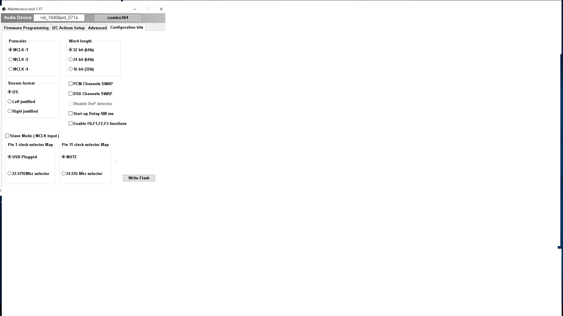

Ah, I understand. Attached images if someone else can help, I will also ask Domenico from Amanero. I you want I flash for you but I'm living in Europe so I guess anybody near you can help you better and faster.

Felipe, if you Google for information on firmware flashing for Amanero you will find some instructions. Thanks for the offer, my GF is around with her Windows machine often enough that I can change the firmware if I need to, it has just been awhile since I did it last. But I do not recall needing to change the settings much, if at all, just the main firmware and the CPLD for slave, or not. I do not worry about DSD swapped or not, as I only send DSD, so I can swap the u.fl to make sure channel mapping is correct.
@barrows & Micke
Domenico from Amanero advice:
You can use F0 to select the clock 22 or 24 in this way you don't need to assign the configuration Bits.
But if you use only 22 you can do it without clock selector so no needs to change bit configuration.
Best,
Dom
As I recall mine are set as in the picture, and I appear to have no issues with both 1099rc and 2006be, both with slave 1081 for use with the Cronus.
For the DSC-2 I will be using an adapter (with isolation) which allows me to get the mute signal directly from the Amanero board (isolated on the adapter) so I do not have to reconfigure anything to get mute through the Cronus' output.
The BuffaloPro does not need Mute, as the DAC itself is seems to be well behaved in this regard. But, i am always sending only DSD 256, so I do not have to worry about problems caused by sample rate switching.
