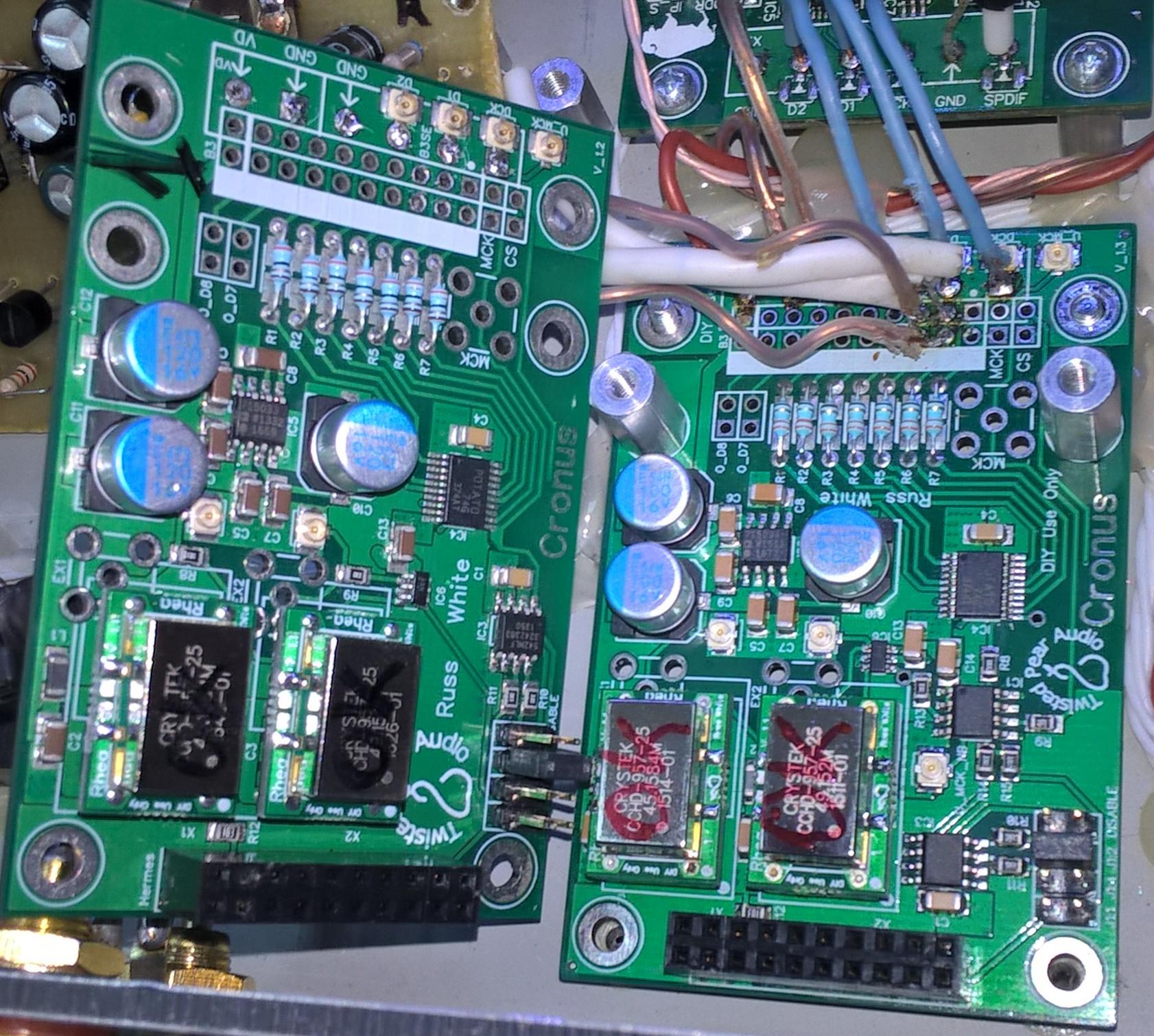

Just powered up the replacement Cronus, I have the 1.6v at the crystek 45 x1 clock but I have no output voltages at bck , d1 and d2, I can try to repair it with the first Cronus, which chip would most likely be defective?
How are you measuring voltage at the outputs? You need a scope.
Also, I assume the voltage at the XO it the clock output. there you are seeing an average of the sine output.
I am just using a DMM, no scope at this time. I swapped out the cronus I am using with the Amanero, and it works with the BBB, that's where I measured the voltages for comparison.
Fyi incase it helps anyone with a similar issue, the cause of the cronus not working was that the 45....rhea clock module is defective
I have at the end of last year received Cronus/Hermes/Amanero set. But he didn't work correctly - was similar that on Amanero the clock with cronus didn't arrive.
I have ordered the second set for check and I have received it recently. It has become clear that all XO working, other plates too workers, but the plate of Cronus simply doesn't work. In the second set of Cronus works, but there is a problem with him. In one channel there is a continuous high-frequency garbage (on an oscilloscope) which doesn't depend the signal on an exit is given or not. Directly with Amanero Ok signal.
I put a photo both versions of Cronus. In the first set the version was 1.2, in the second version 1.3 has come. I would like to send you back not working Cronus plate - as to make it? Also check, it is similar in version 1.3 the circuitry mistake causing high-frequency garbage in one channel.
Was this a clock module you received assembled from me? I hand build/test each of those, but will gladly replace it is not working.
Sure, I can take a look at it. Send me a PM.
Hi Brian yes it was, if you check your site , I ordered one from you last night
Cool. Refunded.
Thank you , just received it, did the trick, currently listening to music via cronus and hermes bbb
I am pretty curious as to what happened to the original. Any chance you could send it to me for some debugging?
Sure will ship it today.
