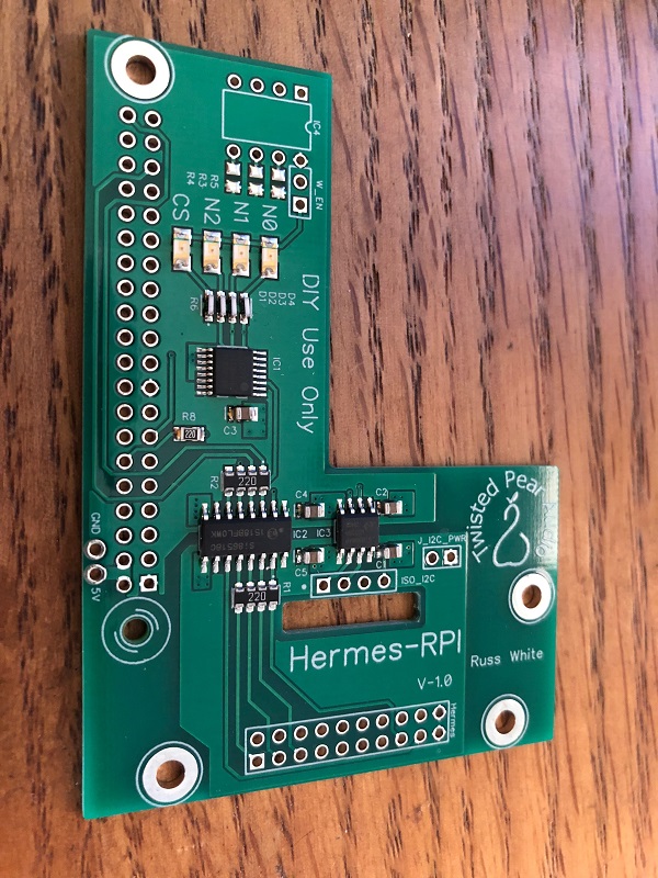

Russ,
So, any plans for RPI Hermes ? + Cronus + Buffalo III Pro + Mercury it would be my ultimate setup 🙂
Already done - just testing (probably today)
