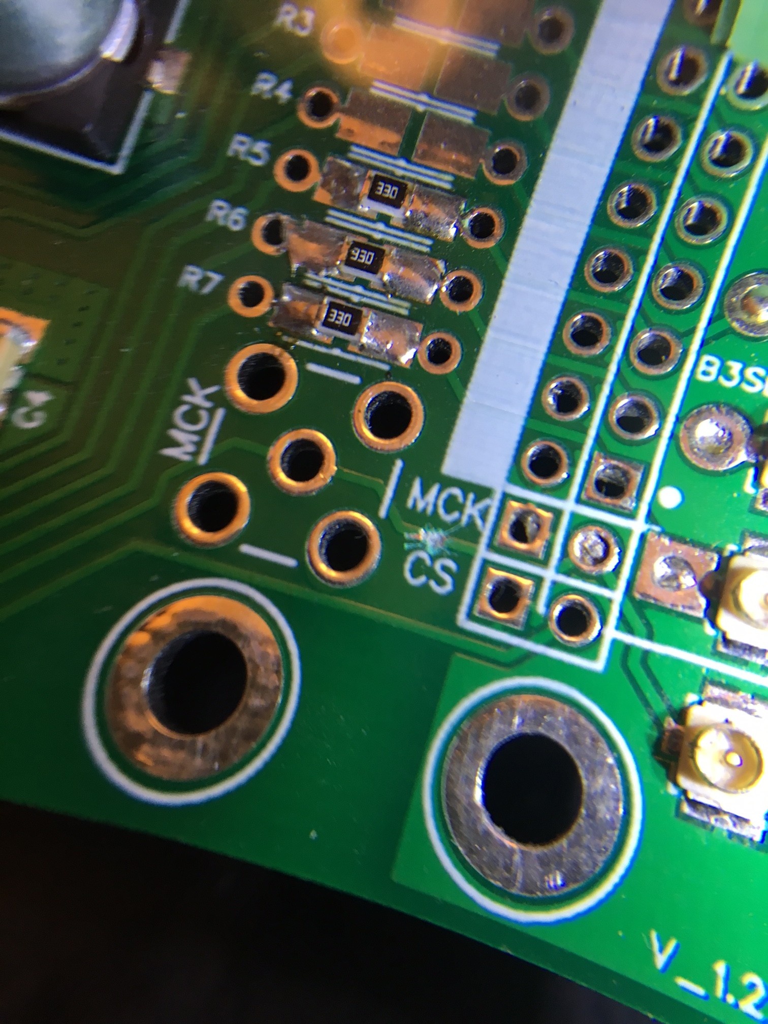

Just curious as to your configuration compared to mine. Does Cronus board revision have anything to do with it? I have v1.2 board, the first pics were of a v1.1 board. It looks like MCK has a different path between the two boards?

Images are taken through a close up lens.

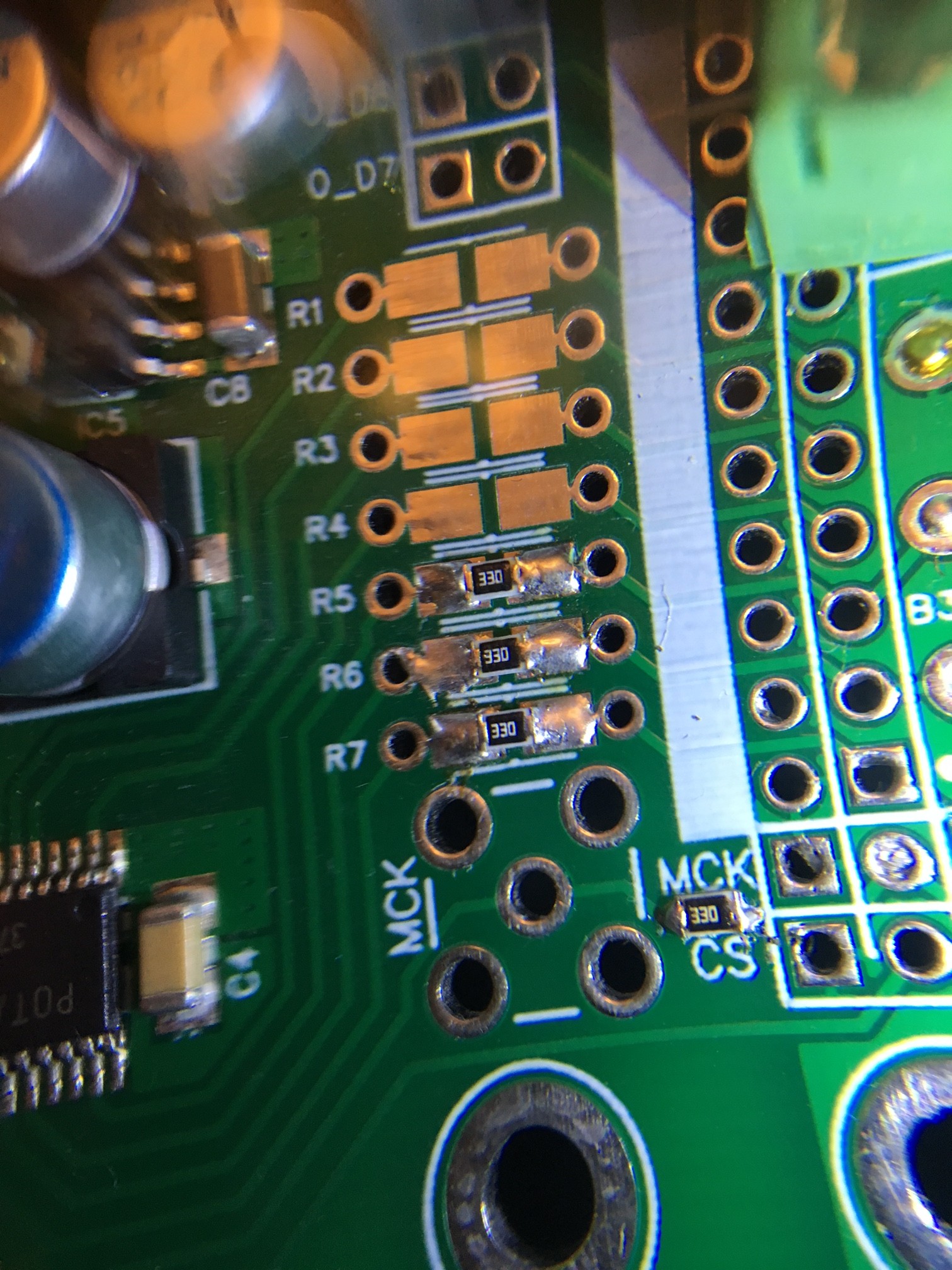

Finally it works :cheers:
Yes it does 🙂 this time is streaming flawlessly 384khz files in sinc. This is with my controller unit, maybe I will test it with yours too one of these days and report back.

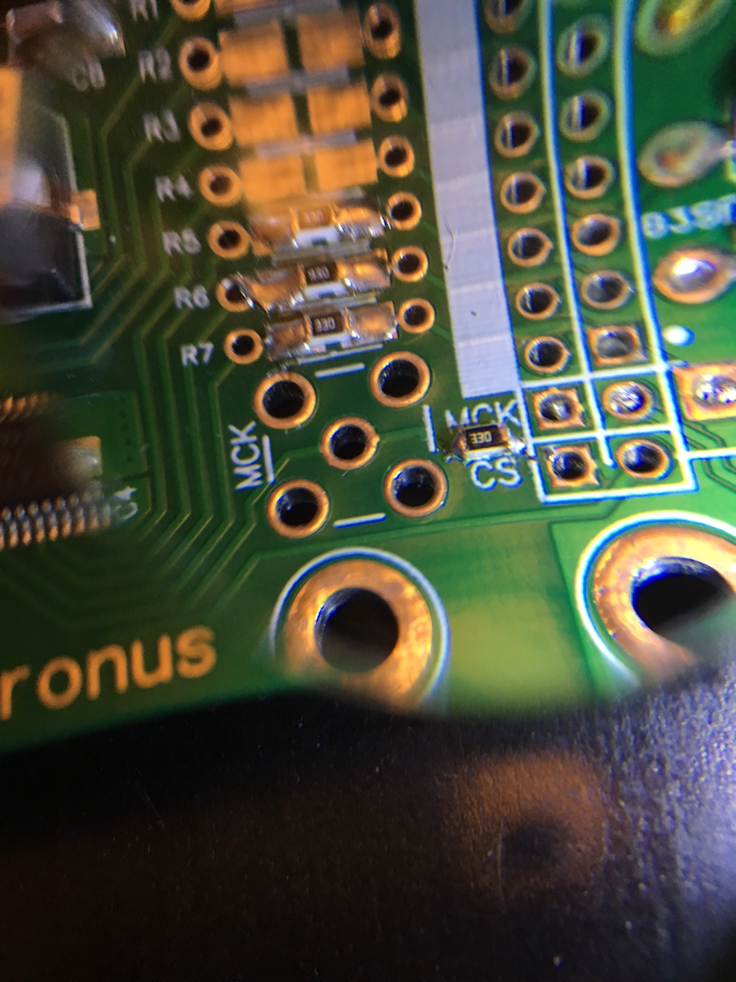

Cronus mck is connected through the 33r resistor directly to b3 mck input.
There was no buffer in the middle.

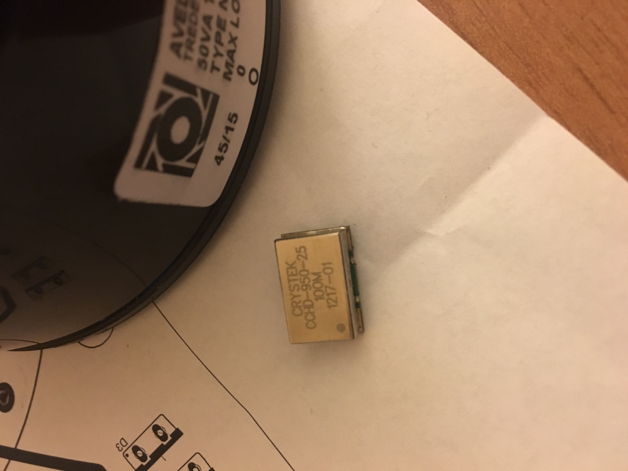

B3 100mhz vcxo was also disoldered.
And not in the end A BIG THANKS 😉
I don't think it was the 100mhz vcxo. It didn`t worked with the vcxo disoldered until I have inserted that impedance matching resistor.
