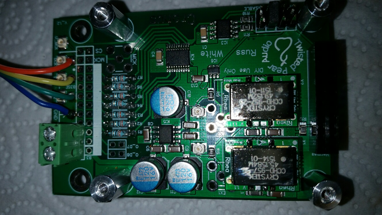

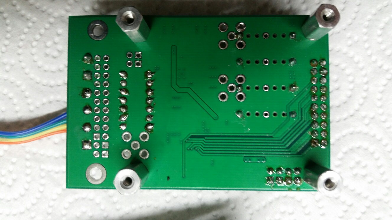

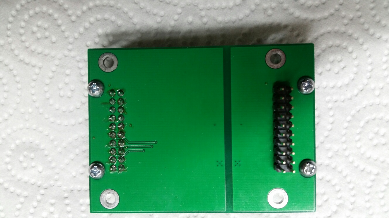

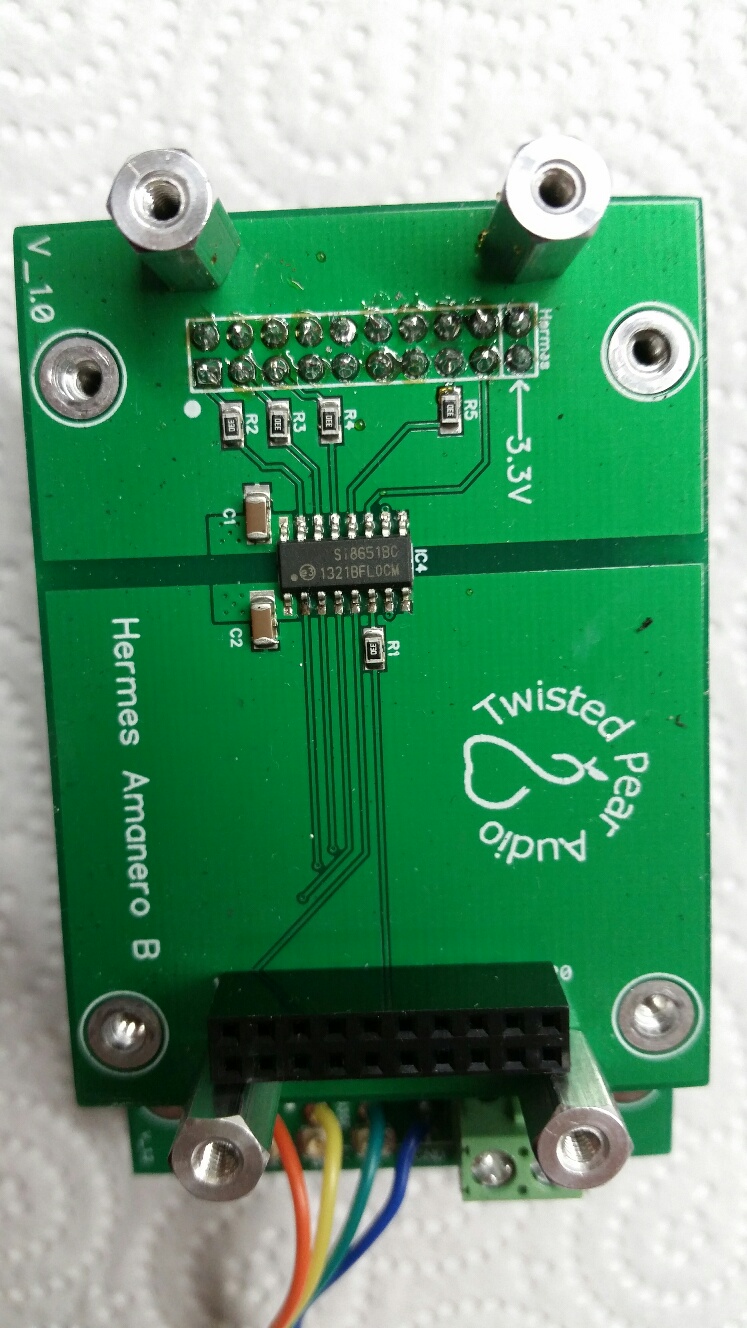

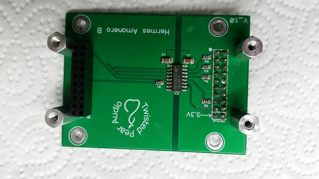

Hello!
i need some help with the amanero/hermes/cronus/rhea.
i got mine one a few weeks ago. today the last missing crystall came. i put all components together, flashed the amanero in slave mode - set the configuration bits... and nothing... daphile and windows found the device, but no sound. i checked all multiplier jumper, resistors, cables, conf. bites - nothing.
i got 2 amanero boards - no board was running in the setup. then i try to use the hermes without cronus. in normal mode an in slave mode... no sound. any ideas?
regards
limbik 5
can i check the hermes an Cronus seperatly without an osci?
When i only use the hermes for a function test.... do i need an 3.3V power supply for the clean side? normally it should be possibe to connect the isolated output from the hermes to my dac...
can i do the same with the cronus? directly th the amanero an than into the dac? if it is possible i can find out whats not workling...
i was not sure about the i2s output from the cronus. can you pls give me the right pins for sdata, bckl, gnd and LRSKl? after reading over 400 postings... i still was not sure.
THX a lot!
