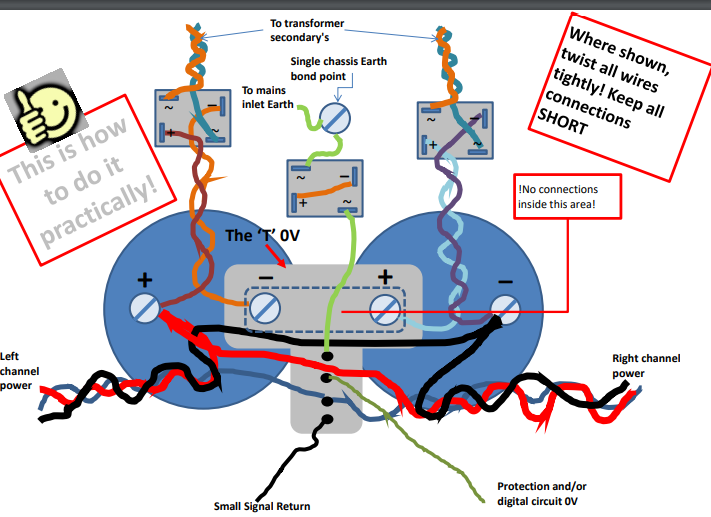

Yes you could use off board caps after the crc pcb
Thanks Prasi, if I understand you I can take the DC output (+ / -) from the PSU and connect to the external cap bank and from there I can connect to the amp boards right? This way I still will have the flexibility of maximum capacitance for a class A amplifier without effecting anything else in the chain!
yes, I think you should move the ground connection(of amp and other aux circuits) too to the o/p side of your new capacitor bank. read the recommendation from Bonsai on hifisonix site.
