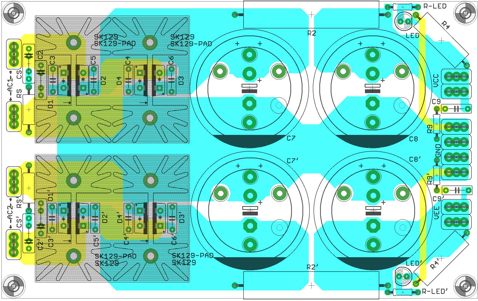

Hello Prasi,
To get airflow up through the rectifier heatsinks, could I drill a few strategically placed holes?
Hello Vunce,
Yes you could, but take care not to thin out traces above or below.. Also you could use kapton tape (2 layers) over places where heatsink is likely to touch the pcb. grey area as shown.
regards
Prasi
Hello Prasi,
Hi Vunce,
The MUR880, for example has a max operational temp rating of 175C. If you are running at say, 65C or 70C even, probably no big deal. Mine are at 65C and I am not going to lose sleep over it.

Hi Vunce,
You’re probably right X, the rectifiers I’m using are rated to 150°C . Since there is a third output on the PWM fan controller, adding a fan would not be a problem if I lose sleep over it, LOL
