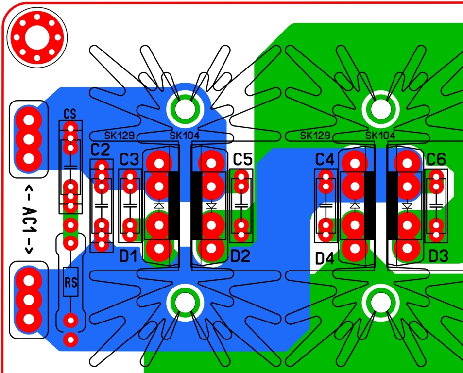

One question regarding the TO220 radiators, these are very close to the copper traces, what is preventing these from shorting? I know that there is that layer of coating that isolates but it can scratch off, did any of you placed any isolators between the board and the heatsink (radiator)?
Thanks.

two layers of Kapton tape between the PCB traces and the heatsink/s
The heatsink will work better, if there is no isolator between semiconductor and heatsink.
Just use a good Thermal paste.
Strips of kapton on pcb where heatsink fins rest would also be a way.

Andrew and to others,
please see attached layout of this PCB.
Isolaters are must, otherwise there will be short, as 2 diodes are mounted on the same heatsink.

Please be careful, already manniraj has experienced sparks because he did not use isolator (plastic to-220 bush and sil pad between diode and heatsink).

That is true Prasi, but the heatsink as you can see is crossing between two AC lines, potentially shorting them, that's why I was asking about any insulator in between the PCB surface and heatsink, it can be very problematic if one manages to make a good connection from AC 1 lines, I was under the impression that there are some fancy insulators that we can buy and install nicely under the heatsinks. Thanks.

1. option 1. raise the heatsink by 1-2mm if it has solder pins.
2. option 2. use kapton tape between heatsink and PCB, if you want to rest heatsink on PCB.
3. not option but compulsion: use to-220 isolators between heatsink and diodes (if using metal tabbed diodes), unless you are using plastic isolated package already like TO−220 FULLPAK
CASE 221AG (https://www.onsemi.com/pub/Collateral/MUR1520-D.PDF) . see the second image, its all plastic.

take a nice piece of automotive gasketing sheet. ask for automotive gasketing sheet, if there is a automotive workshop near you, its damn cheap.
Roughly Cut it as per the heatsink, Puncher holes where ever necessary, solder the PCB and be worry free.
Afterall, its DIY.
We need very good insulation that can withstand high temperature (may be 100 deg. C) . Any insulating material, that can withstand high temperature should be ok here.
Thats why I orginally suggested kapton tape. make as many layer as you want to feel safe for long term operation. You could even place something like this between heatsink and PCB.
