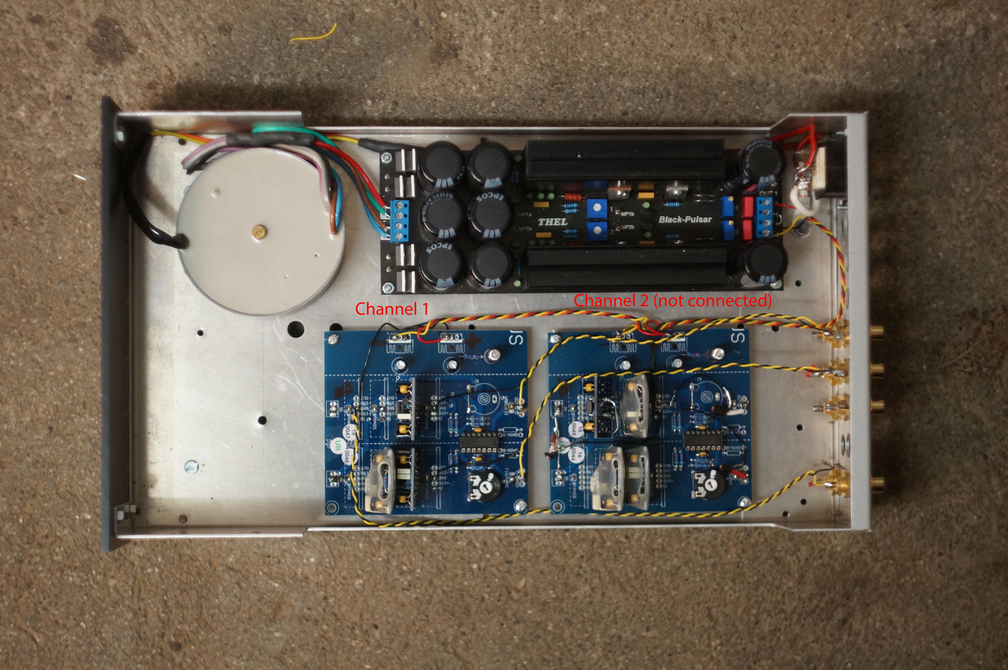

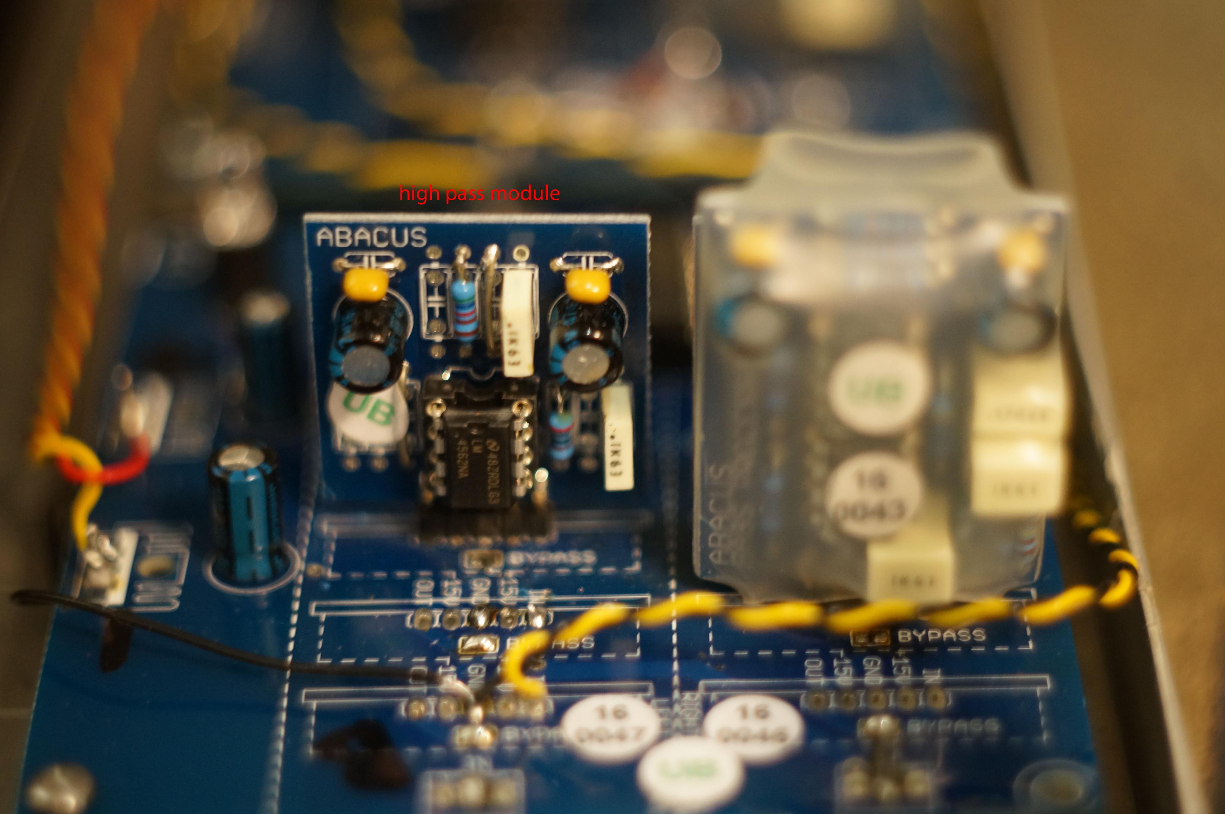

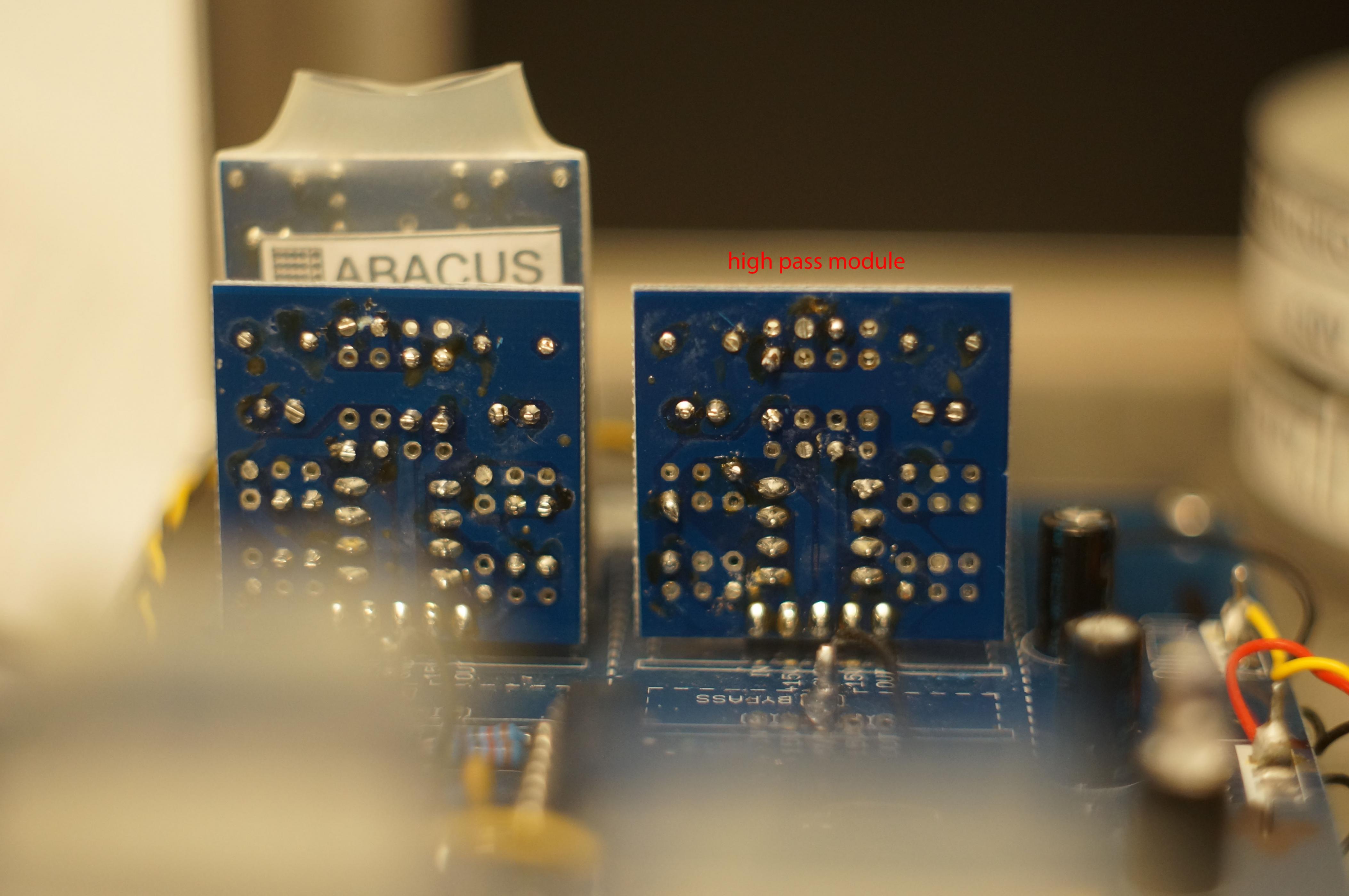

I attached a few pictures of the xover (whole board, and details of the little high-pass module where the headaches seem to start).

I think we haven't seen a picture of the situation yet ?! Would help just like gathering data.

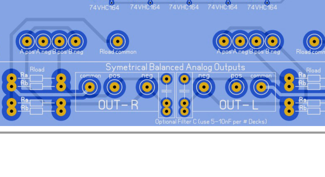

There is a provision for an optional cap of between 4.7 nF and 10 nF.
Did you place this cap or not ?
This seems to be the the least that should be done.

And don't forget to place the two optional 10nF caps on your NOSDac.
It's better to do this as the first step,
See Picture
Hans
THANKS for the attachment, now I understand what filter caps you're referring to. I have an older DDDAC board that does not have the optional caps, so I was a bit confused. But I can still add them and see what it does.
