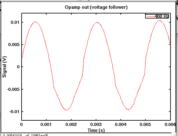

Ok, I removed R1, bridged C2, changed R2 to 70 kOhm and left C1 as is (100 nF). This left me with a voltage follower with coupling capacitor at the input (100 nF) and a 70 kOhm resistor that provides GND reference at the pos. input of the opamp (RC constant is 7 ms).
Result: output signal is still distorted, but looks different than before (see attachment). Yes, the input signal to the opamp / voltage follower is clean (confirmed this).
So the distortion is happening in the opamp. But why?
(just to repeat from post 25: the distortion goes away at higher volume settings of the TVC, so it must be a combination of the TVC setting and the inner workings of the opamp).
the distortion goes away at higher volume settings of the TVC, .
smells like some crossover distortion of op-amp.
I have no idea about opamps. Is this something that opamps tend to do?could the opamp be reacting to seeing a high input impedance?
OK, that was a good test. Distortion is less. Now do the same and leave out any input cap. So short C1 and C2 (DC coupled yes). Only do this when using OP275 (JFET input opamp).
I already did this. Result was the same as with the capacitor.
Did you also try out various values resistors ? Or a potentiometer ? Just to see if things change then.
Will it be possible to connect a sinewave oscillator to the input.
When the problems persist, the cause concentrates on the small pcb with the filter.
