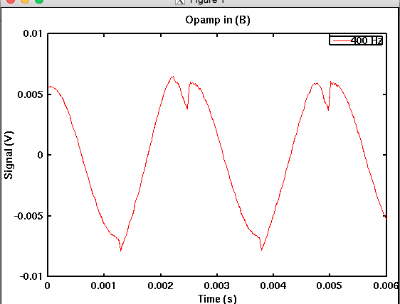

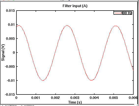

Still trying to combine all results, a number of things can be used to exclude possible causes.
1) a generator instead of DAC / TVC results in a normal signal from the filter.
2) placing a resistor in line with the filter, with DAC and TVC in place attenuates the effect somewhat bit distortion is still there
3) placing a buffer before the filter does not solve the problem, so the filter cannot be the cause, the signal is already there before the buffer.
4) The filter cannot produce distortion from itself, unless it is oscillating for which there is no prove at all.
5) So the distortion is caused by the input signal, and although this might look clean, this because the oscilloscope cannot catch HF glitches.
6) steering the filter straight away from the DAC results in a perfect signal.
7) This meand the DAC is also O.K., just as the filters.
8) what remains is the TVC being the cause of the trouble.
9) since the TVC cannot invent new signals at its output, the distortion is already there at its input, pointing clearly in the direction of interaction between TVC and DAC.
10) So either one of following solutions should work:
I) A termination load at the output, working it's way back to influence the DAC to TVC interaction.
II) Buffers at the input to isolate the DAC from the TVC, probably the best solution.
III) Or a combination of both.
Other changes are nothing but cosmetic symptom fighting.
The Filters are O.K and so is the DAC.
The TVC is the cause, so try to tame this beast.
Hans

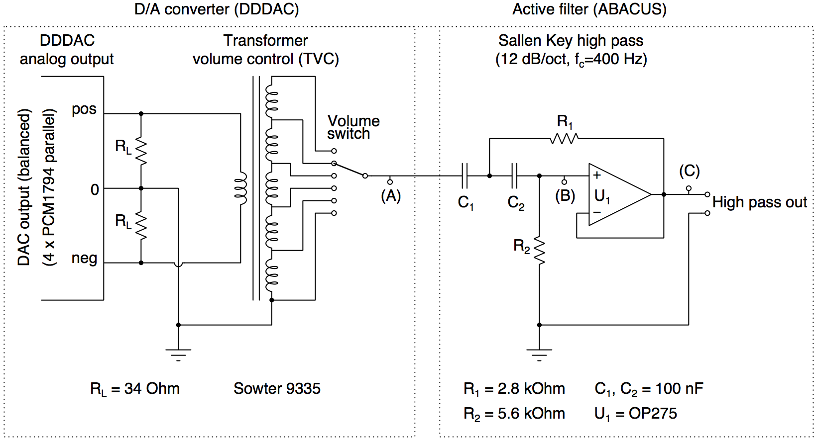

Has he tried driving the TVC and filter from another source which cannot have spikes?

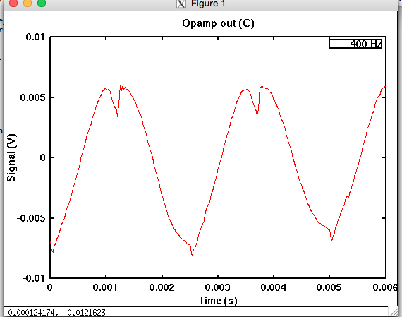

It is possible that the problem is a combination of two issues:
1. the DAC is sending out spikes or other HF
2. the TVC presents an impedance to the filter which causes a near-instability - it isn't quite oscillating but nearly.
Then the spikes trigger ringing in the instability, which manifest themselves as distortion. Changing either of the two issues will change the result.
There is no evidence that the filter is oscillating (apart from the circumstantial evidence that adding an attenuator pad improves things) but there is no evidence that the filter is not oscillating. The buffer could suffer from the same problem, if it is constructed in a similar way.
When driving the filter from a signal generator or directly from the DAC without TVC in between, there is no distortion making the probability of oscillation very small.
The 3K load termination load on the TVC attenuates things but a buffer isolating the filters doesn't, so it is not the filter that causes the attenuation.
And when using a completely different filter with buffer there is still distortion.
So the filters are not in the line of fire, it is definitely the TVC.
Hans
No. All that shows is that the filter does not misbehave unless the TVC is present. What happens when the TVC+filter is driven by a sig gen?

With the 5532 the Bips where back again, so there is still something in the input signal causing this. That one opamp is less sensitive, does not mean the problem is solved, that was what I called cosmetic symptom fighting.
Remember that your scope is the big limiting factor here.
That the output of the OPA2134 looks right, tells very little, since the output of the TVC also looks right, but as we know this is not the case.
Also, remember that the distortion goes away if I change the TVC volume setting to 12 o'clock or so. I'd expect this to change the complex impedances in the TVC, which in turn might remove the interaction with the opamp filter.

Another thing to try is adding a passive low pass filter between the DAC and TVC. The aim is to reduce any spikes without affecting audio. Note that any competently engineered DAC will already have a filter, but maybe you are using a NOS DAC?

My advice (being a transformer winder with TVC and AVC experience): run a frequency sweep through the TVC primary to check if there are HF resonances (which might give these distortions in combination with the NOS dac).

have you terminated your TVC already with a much lower resistance as the 3Kohm that you recently tried and that positively influenced the problems.
Ok, first I removed the series resistors from the T-pad and left the 3kΩ in place (from signal to GND at the TVC output). The pips were back.
I also tried different resistor values; result didn't change a lot.
Then I removed the resistor from signal to GND and put the series resistors in the connection from the TVC out to the filter input back. Pips went (almost) away.
So it seems the termination of the TVC secondary (signal to GND) is not the issue. Looks more like the coupling of the TVC to the filter to me.

Ok, tried that. I used 33nF from pos to GND and 33nF from neg to GND. Didn't change the pips a bit.
The RC time constant is 34Ω x 33E-9F = 1.1E-6 seconds, corresponding to a cut-off frequency of about 140 kHz. Should be enough to take care of HF spikes, or at least to reduce the effect -- but since the caps didn't change anything I don't think there were any problematic HF spikes to start with. While I don't have a scope to "prove" this in my own setup, I found a few scope shots from the DDDAC output at Doede's website. I don't see any spikes or similar issues.
My conclusion from all this is that the issue is related to the coupling of the TVC to the opamp filter. So I started modifying the KMTech filter to give the exact same filter transfer as the ABACUS (high pass), checking for the appearance of the pips in between the various modification steps. No pips at all.
So unfortunately I didn't learn what's going wrong with the ABACUS. I guess I'll just replace the ABACUS high pass with the KMTech and leave it there. I need to get the system playing music again...
