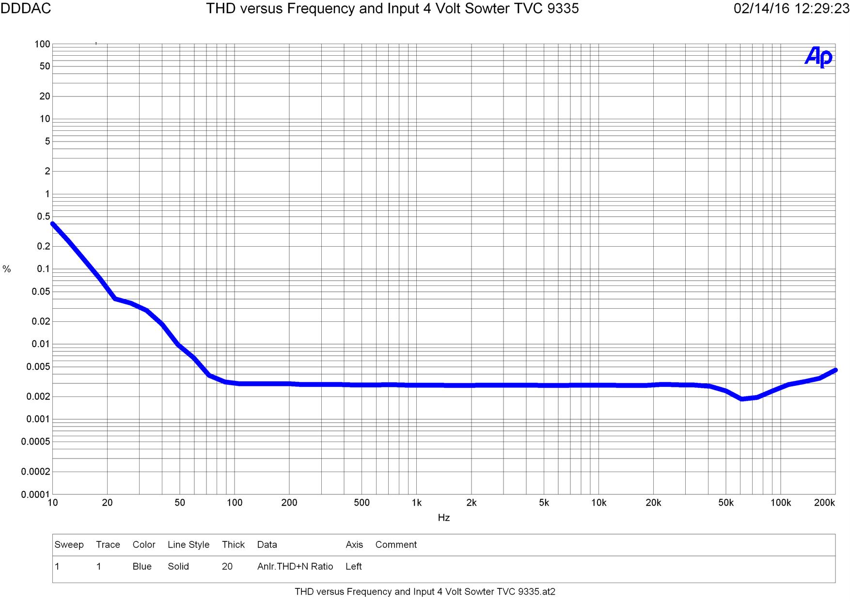

That's a good point. That's why I checked and double checked that DC is as low as possible on the primary of the xformer. My DVM says 0.000 V. Doede (the guy who designed the DDDAC) tested my xformer in his own DDDAC, which has a small DC imbalance of about 5 mV. He found no issues with his AP distortion tester (see attachment).

Let's try to recollect what you have done to prevent turning in circles.
1) when driving your filter with the trafo, you have a clean signal at point A, but not on B & C.
2) when driving with a 50 Ohm signal generator you have no distortion [I missed this point].
3) when removing the 100nF filter caps while steering from the trafo, distortion at C is still there.
4) when inserting a buffer between the trafo and point A of the filter, distortion at A,B and C is as in point 1).
Is this a correct presentation of facts ?
Especially 2) and 4) seem to be in contradiction since one may assume the buffer has a very low output impedance.

Yes, it's socketed. I already tried an NE5532 a few days ago, and now also an LM4562. The distortion effect was the same (the signal shape of the distortion may have been a wee bit different, but not much). As far as I can tell, these opamps all have bipolar inputs. So the FET input idea might indeed be something to test. But I don't think my junk box has anything to offer here, so I'll have to get some first. While I'm at it I might just as well get a complete Sallen Key filter module with FET input opamps (there are some at eBay), just to make sure the culprit is not in the PCB design.

Take a look at my first post and also post 25.
In summary:
- The distortion is most apparent at the lowest volume setting of the TVC and gets less apparent at higher volume settings.
- I set the TVC to "12' clock volume" and attenuated the test signal in the software before it was sent to the DAC to get the same signal amplitude at the TVC output. The result is that the distortion at the filter output was gone.
This smells like parasitic oscillation. What happens if you insert a pi or T attenuation pad between the TVC and the filter? What happens if you insert a Zobel network at the input?
My guess is that the opamp, although unity gain stable, presents a negative resistance at some HF frequency and this happens to react with the impedance presented by the TVC.

Almost surely it is an oscillation, as other people already indicated, but no relavant answer or act had happened.
There are many possible reasons, and not neccessarily restricted to the OPA in the filter, but for example the unused OPAs also can oscillate if not deactivated correctly.
The root cause of distortion is
- NOT the transformer, since A is undistorted
- not the OPA alone
- affected by leakage inductance
A high speed oscilloscope is needed to check oscillation.
Probably the leakage inductance with input and other parasitic capacitance forms a parallel resonant circuit near the GBW product of OPA where the fully fed back OPA has gain, and can maintain oscillation.

I have simulated the filter circuit in LTSpice and no matter how I try to screw up the circuit, I can't get the waveforms that you show us.
It is as if a spike of very short duration is overloading the input of the filter, leading to this effect.
That could explain why your input signal seems clean, because your scope is not fast enough.
That would also explain why a buffer does not make a difference because it simply transfers the spike.
Jan's suggestion to try other frequencies could possibly confirm whether the distortion is directly related to the input frequency.
Does your scope have the ability to catch spikes ?
