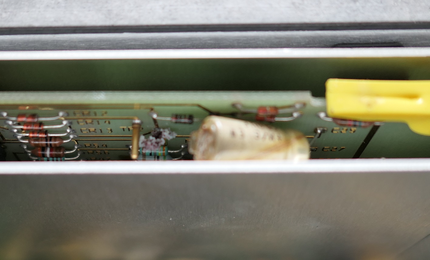

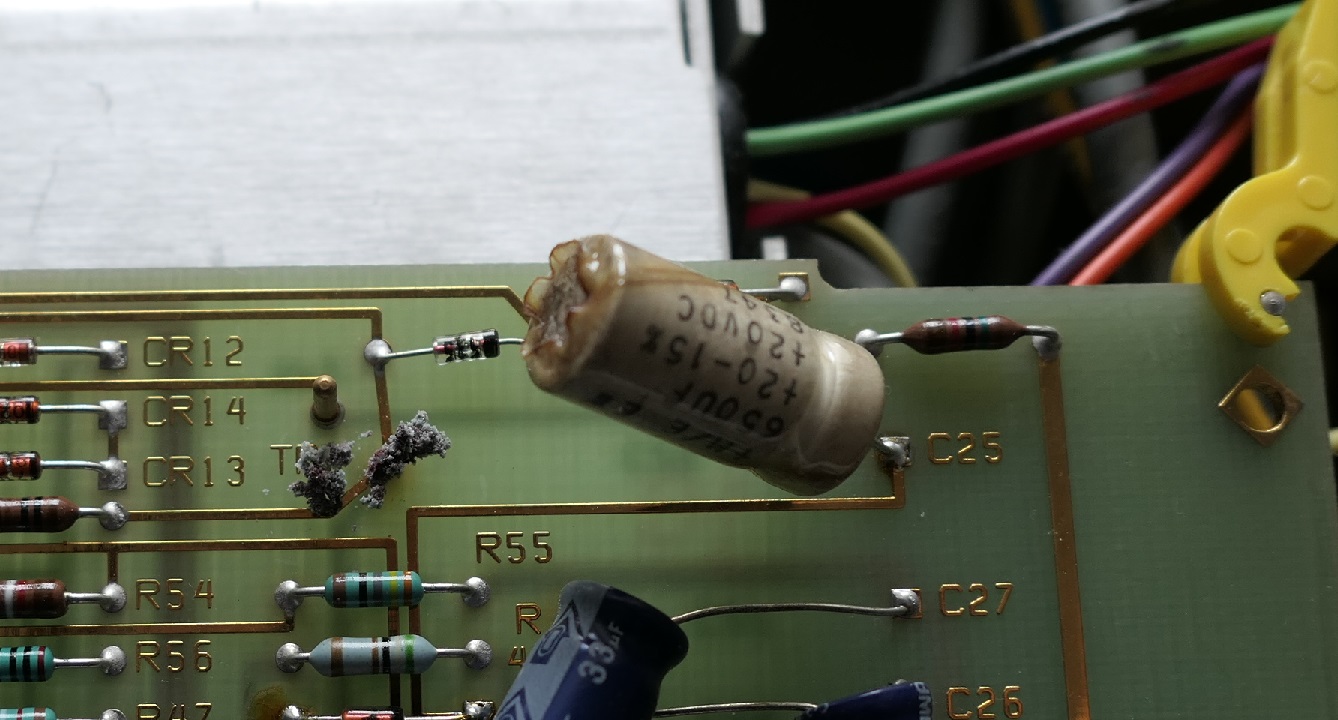

Oh, oh, does not look right
Opening the bottom up I saw this capacitor....
Now how to get the board out since the removal lug on the other side has broken off and this side is not much better too....
Got it out, not too bad to remove.

If the instrument is that mangled anything that tech worked on is probably trash. It astonishes me to see these badly abused essential tools. It's on a par with a carpenter using a chisel to turn a screw.
HP stuff is not hard to work on. No excuse. . .
C27 and C26 were both replaced with 33uF, not 22uF. I cannot locally get 650uF so used two 330uF parallel and I replaced the 33uF with 22uF. There have been some other capacitor replacement as well and soldering is shocking. Some IC's now have sockets and one IC was not even seated properly.
Not pleasant but one has to remember purchase price and that shipping from other location outside New Zealand runs between 150 USD and 200 USD. Knobs are costing me about 70 USD but if I can resurrect then it may still be worthwhile for the few occasions I need it.
Voltage across the 650uF (actually measures about 664uF, still within spec's) is about 3.6 V so suspect the 9.09V zener is toast.
I'm living rural and there is one parts shop but they have only the essential basics. Have to check what there is in stock with him but first I have to do another coat of paint on one of the walls in the lounge. (needs to be done before some new curtains arrive and while the weather is still good enough to open the doors).
I agree about bad workmanship, I hate it too. But nothing else available and I do not want to spend the money for a Picoscope 4262. Today the software is supported but not in 10 or 20 years.

Replaced the 650uF capacitor with two 330uF and replaced the two 33uF to the proper 22uF (C25, 26 & 27) and replaced the 9.09V zener (CR11).

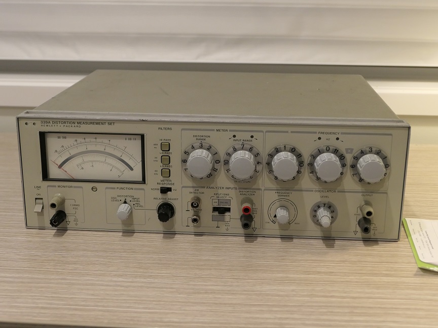

Managed to score a free clean working HP339A unit as everything is digital these days.
Will sit on my repair bench.
1 Pascal=94dB
The boatanchor has risen from the depths and is now aboard
