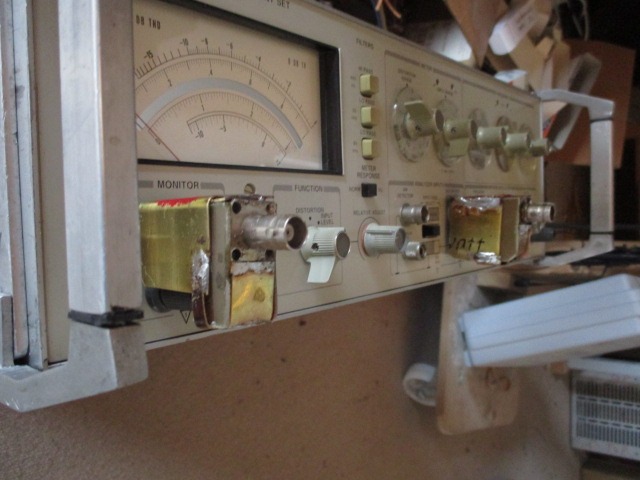

I bought the 339A at quite reasonable price claimed good condition which it is. Apart from using switch cleaner on all the wafer switches (obvious) which made a drastic difference. When using the instrument on high sensitive settings, strangely, when using flying leads on the monitor terminals I found this monitor output susceptible to oscillations, which can be suppressed using one of the on-board pass filters but I don´t like this method. It tells me the RF bandwidth goes back beyond the RMS detector (U5) on the autoset level and meter circuit board even though there is a 1K resistor in series with the monitor out lead. It is quite possible there is a later modification regarding this issue.
I decided the move to BNC connectors.
One of the shortfalls of the equipment of that period are those 4mm working terminal outputs (which aren´t really noise immune) which I converted to BNC with shielding skirts and 4mm lab pins, with a little soldering skill and tin plate. see pic. I can recommend this modification, as screened cable is really the right way to go.

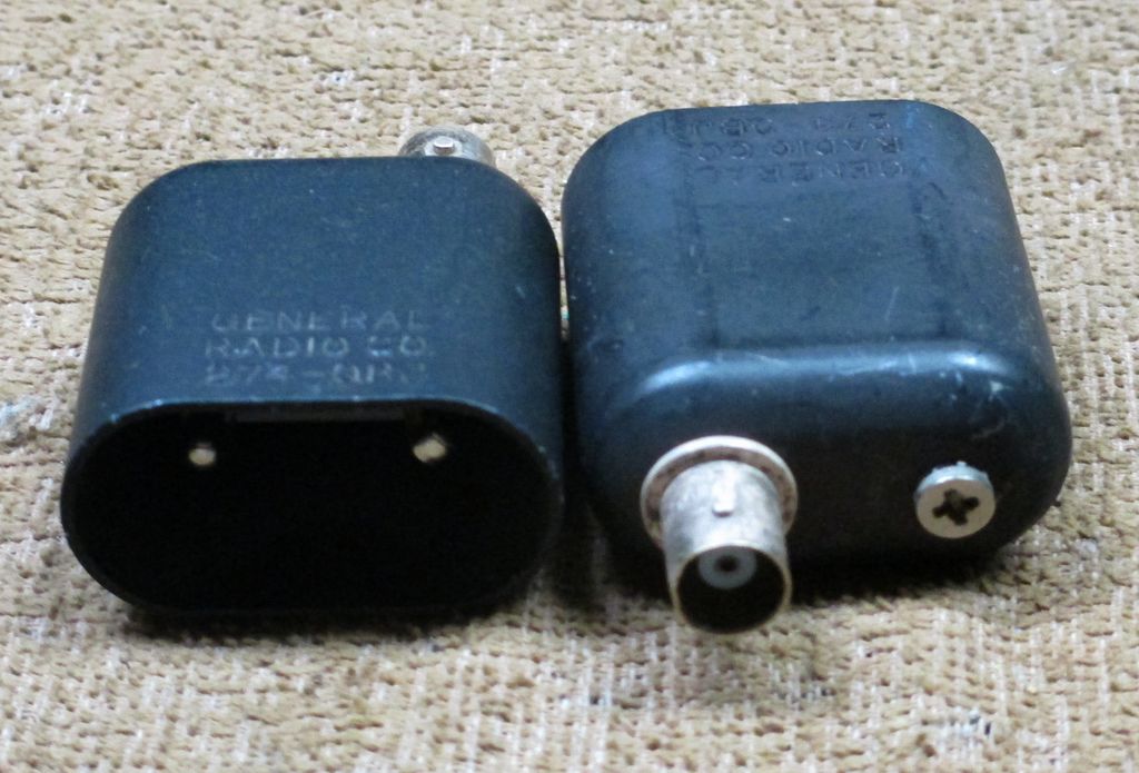

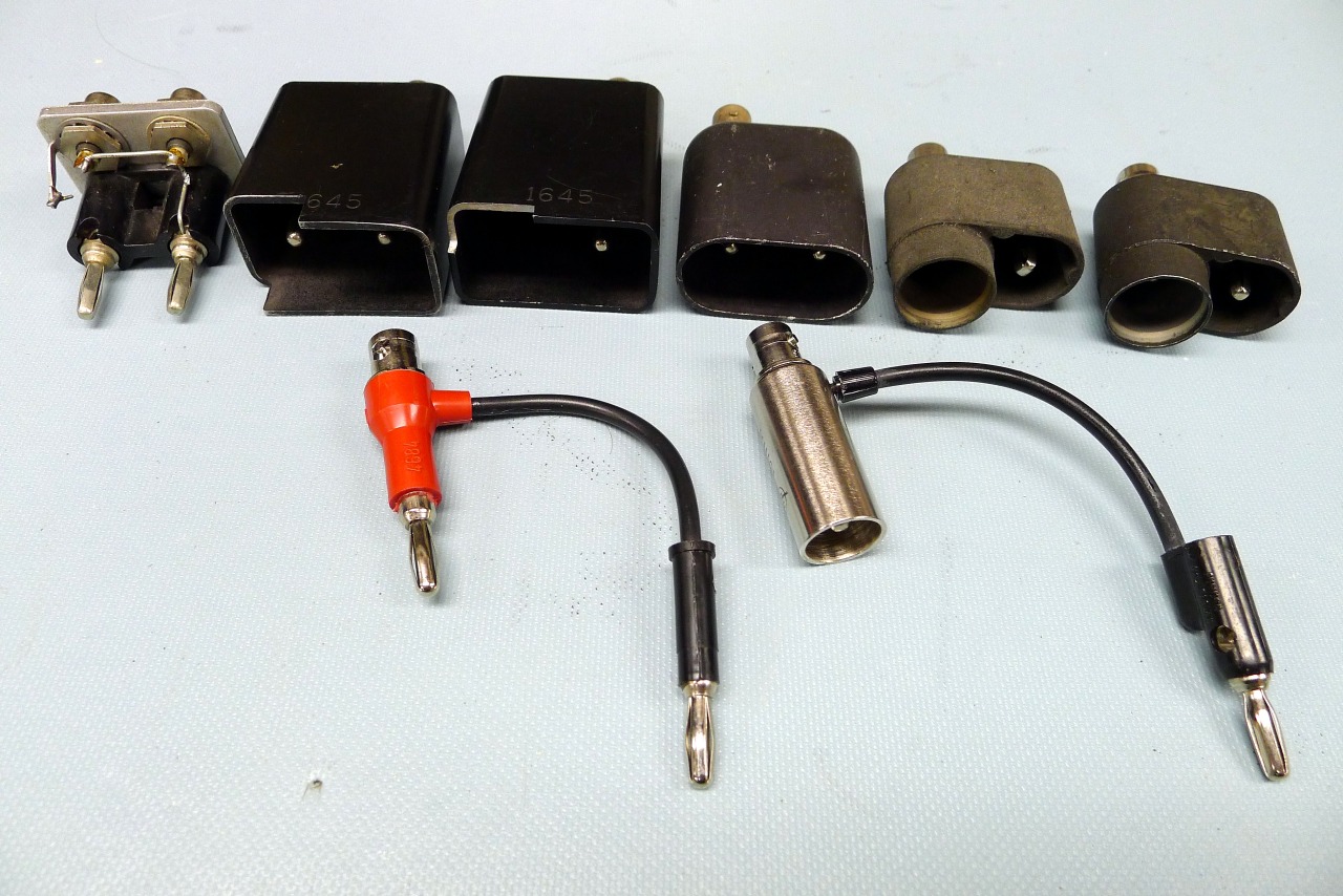

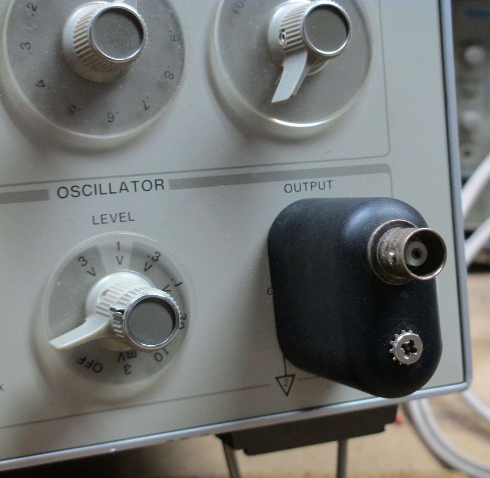

Though I agree that sometimes shielded ins/outs are needed, I prefer to retain the versatility of the binding posts, and use a shielded adapter when needed. In those situations the typical Pomona banana-BNC adapter doesn't cut it. These old GR 274-QBJ are perfect.
The GR's are great and hard to find (they must have been discontinued 30+ years ago). Pomona had a similar shielded adapter also really hard to find. Maybe someone will pick up on the opportunity?
The hardest and most important parts to find and own. Been doing audio since 1966. Having owned most of the important audio measurment devices since around 1957, you quickly learn that the specialized accessories, like these connectors and adapters are as important as the instruments they mate with...
