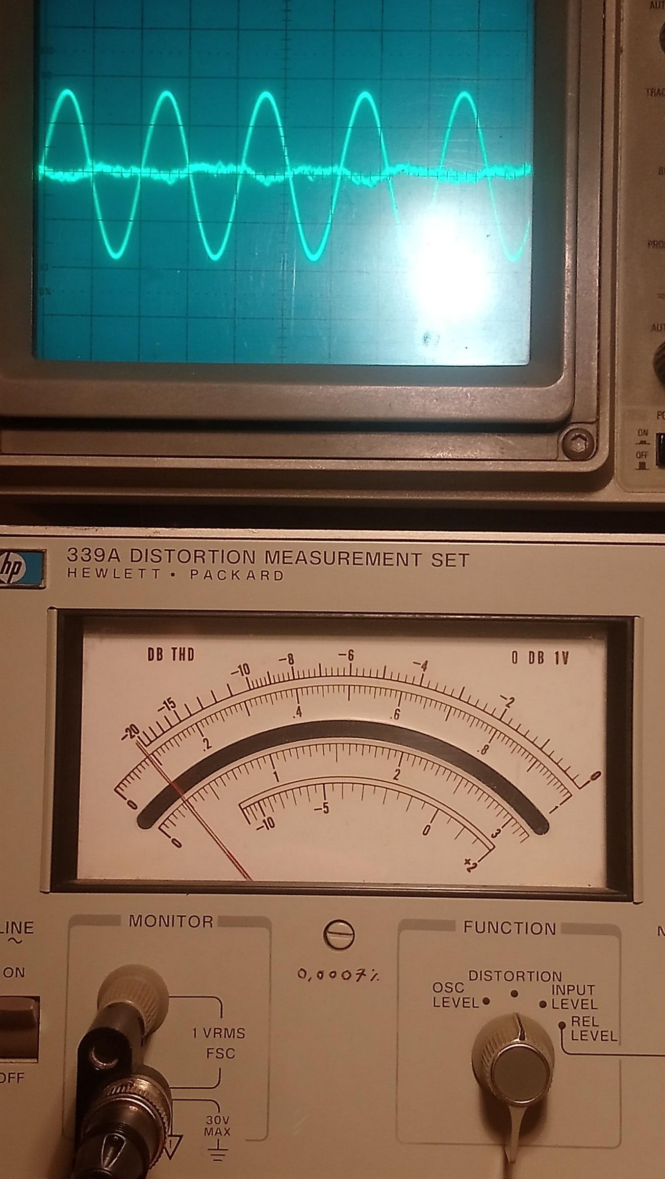

WAIT! Something is different.. I got ..somewhat... working autonulling.. at about -84dB after re-adjusting the potmeters R16, R43!
Hoeraaaah ! 😀
Thanks sooo much for all the help!
EDIT: -92dB after some more tricky nervous adjustment of R16 and R43
Hoeraaaah ! 😀
Well, the HP339A is working great again 😀
here I ajusted the analyzer to a sweet spot, at 1KHz (10x 100), 1.7Vpp, and GND lift, resulting in a residual distortion of -100.5dB, or about 0.0009% (dominated by a residual of the fundamental, some 2nd harmonic and noise).
Thanks you guys. not only did I get my HP339A working, but I also learned alot about fault finding!
Have a great new year!
Managed to get it to 0.0005% (-106dB) with the KH-4400a after replacing two LM318 opamps at U125 (main oscilator opamp) and U183 (output buffer) in the KH-4400a,with opa134, and carefull adjustment of the THD trimpot.
On my computer sound interface, a Focusrite Saffire 26 I/O, I measure -108dB for both the HP339A internal oscilator and the KH4400a. Guess I am hitting the limmit of the HP339a distortion analyzer at -106dB.

3.53:
i: meter indicates about -2.4dB
j: meter indicates about -2.8dB on the next range. Next lower keeps meter at same setting and does not move at all regardless of input level settings.
3.54:
e: pass (-3.6dB)
g: pass (-4 db)
i: fail (-5.8dB)
It looks like the lower input levels of the analyzer is not functioning properly.
Knobs have been ordered but wrong ones were shipped. Waiting for these to arrive in order to ship them back.
Great news about frequency accuracy of the oscillator section.
I still advocate a thorough cleaning of switch contacts, but I also like Demian's suspicion of power supply hum--- especially since you mention hum in the monitor output. The 339A has separate supplies for the oscillator and analyzer sections isolated from each other. All supplies should have no visible hum on a scope at highest AC sensitivity. To ensure good supply behavior, all input filters ahead of the +/- 15V regulators should have modest AC ripple and several volts of drop-out headroom.
When you're ready to focus on the input amplitude issue, the symptoms point to the Input board A5. Monitor TP103 with your scope as you manipulate input range switch S4. Because you mention misbehavior at 100mV and below (I'm making a big leap here with scant data), scrutinize especially switch section S4E--- R120 is active at 100mV and below. Section 8-28 has a description of the input section.
Good luck--- you've already made good progress!
