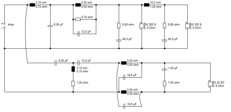

There is a simple analysis that you can do to better understand that network. At the lowest freq, DC, inductors are shorts and caps are open, note that the tweeter is connected to the network with one polarity. At the highest freq caps are shorts and inductors are open note the opposite driver polarity connection for the tweeter. The network flips the phase 180 deg from DC to max freq.

I just spent an hour modelling this speaker. The tweeter delay circuit is rather neat actually. It effectively recesses the tweeter about 3.5cms which really lines it up nicely with an 8" woofer on the 3kHz crossover. The tweeter wires in phase AFAIK.

I won't repost the schematic since we are about to turn a page anyway, but C1 and C2 on the bass filter must be very critical if deteriorated. Treble shunt R4 and L4 would muck things up if they went O/C too.
C3 and C4 on the Zobels won't be very critical IMO.

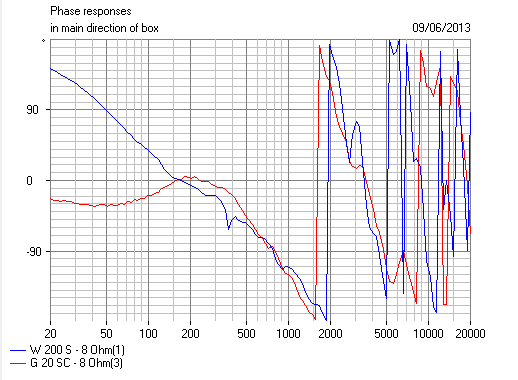

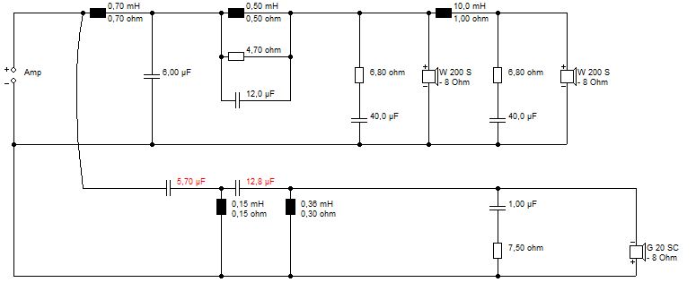

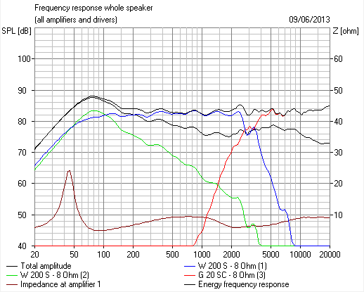

I could simplify the bass filter to second order coil plus series resistor and capacitor, and add a tank notch across the coil at 7kHz, but what is extremely interesting to me, is that the time delay circuit on the treble can be replaced by a 4th order filter and get almost identical alignment. 8" bass plus 1" tweeter on a flat baffle is a stinker of a problem that has beaten me for years because the time alignment on a deep bass unit goes horribly wrong . Suddenly we know what to do with it. Thanks, man, I'm excited! 😎
(BTW, the modelling isn't exact, because I've used a 8 ohm tweeter, but the principle applies! Tweakers note, you add input resistance to the treble filter to attenuate the treble. )

It's a 3kHz crossover. Given I now know these are 8 ohm polyamide tweeters (@ 6 ohm DC), I would suggest you add a 3.3R 7 or 10W wirewound at the input to the treble filter. That will quieten down the tweeters about 4dB which should do the business towards a more civilised brightness level.

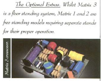

Looks like MKT (polyester, Harbeth-style) capacitors to me, but could be MKP.
