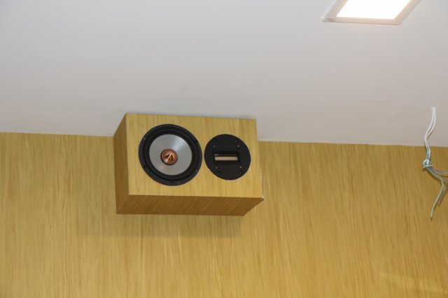

My rear speakers (W16NX) for this system are aluminum cone. My bedroom rear speakers are Mg cone but oddly enough they are not affected. These speakers were not veneered and polished but wall papered (with the same wall paper we applied on the wall. (see pic). Thing is we let the polish dry for 2-3 weeks before installing the drivers. So I don't think it is the polish.

I got a reply from SEAS. I am quoting the relevant sections below. The rest is about contacting my sales channel.
"The white powder is Magnesium corrosion, which stems from the speakers being stored (or used) in a hot and humid climate. I think you know this already. The corrosion doesn’t affect performance (until there’s an actual hole in the cone), but we admit it doesn’t look good. The only way to prevent this from happening is to make sure the speakers are kept in a fairly dry condition at all time.
Please go through the sales channel to process your complaint. Maybe they’ll give you a good offer on the replacement drivers, as you suggest. SEAS doesn’t manage end-users directly, since we’re strictly an OEM business. Our limited manufacturer warranty is 3 years from production date...."

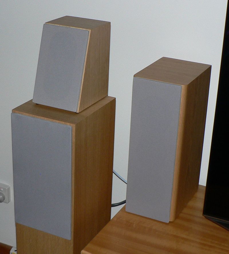

Me, I would clean the existing drivers as best you can and add speaker grilles so out of sight, out of mind. A lot easier than redesign and rebuild plus you don't have to use black grille cloth as other options are available such as where I bought mine.

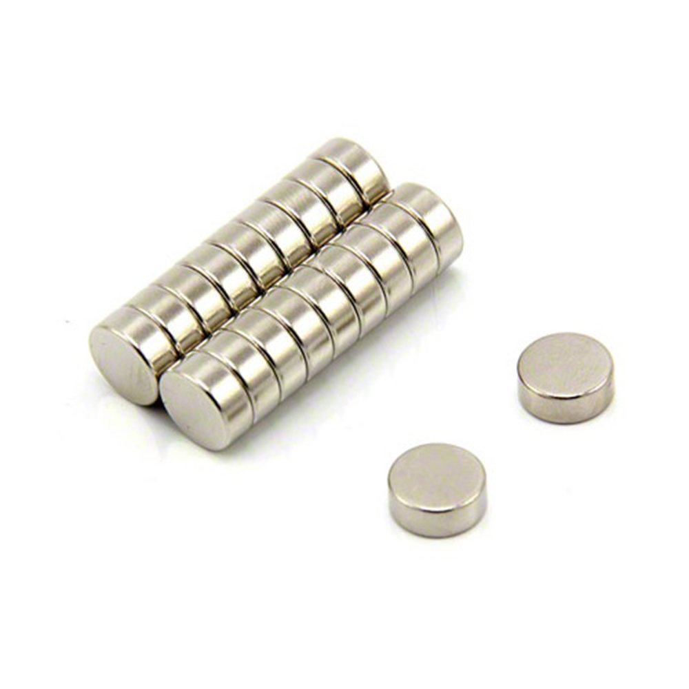

I do have a speaker grill. There are small 10mm NdFeB magnets below the veneer and on the frame of the speaker grill (I took care to make sure the poles were opposite). In fact this grill is so seldom removed that it was only when I removed the grill to show the construction (of the magnets) to a friend is when we noticed the corrosion.

"In fact this grill is so seldom removed that it was only when I removed the grill to show the construction (of the magnets) to a friend is when we noticed the corrosion."
Goes to show you shouldn't remove grilles. 😉
