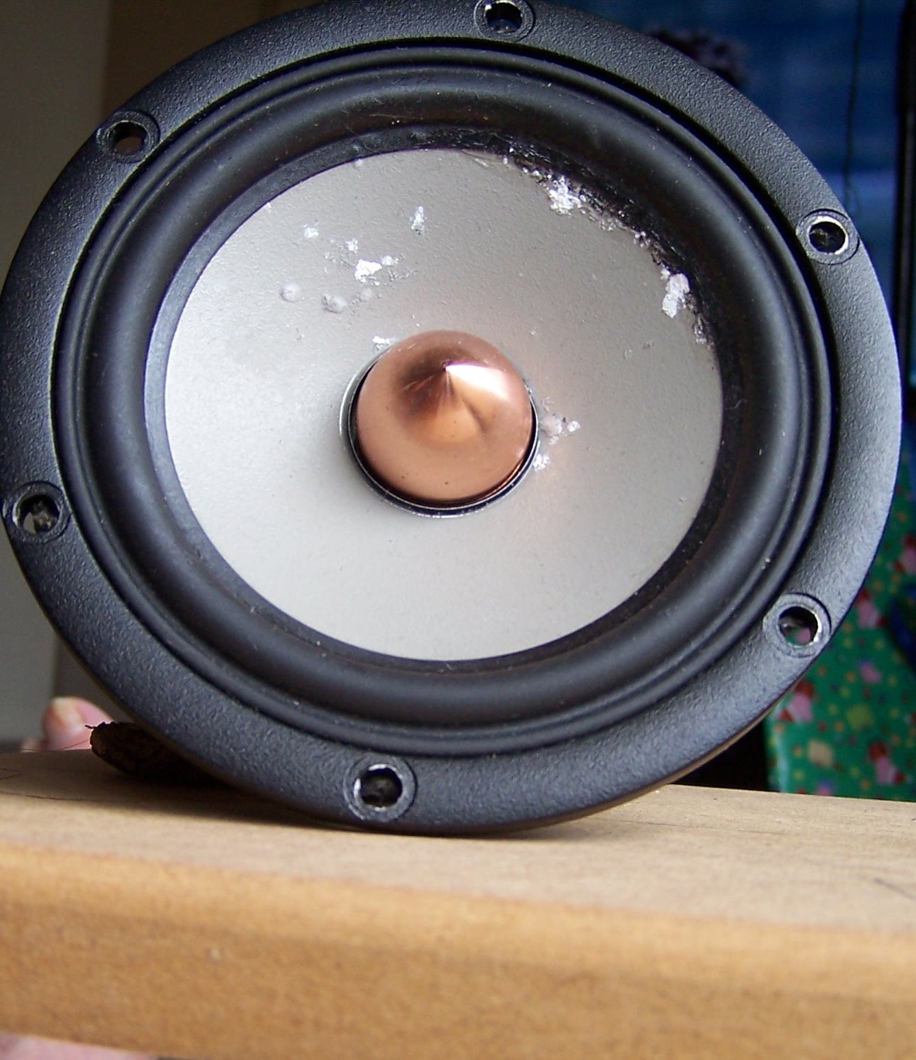

About five years ago I bought some SEAS Excel drivers (W12CY001). I put them in a pair of loudspeakers I built for a friend. Recently he informed me that the drivers had developed corrosion on the magnesium cones. I have attached some images of the drivers. One is much worse. The speakers were located in an old and somewhat damp house, but not excessively so. I assume that the protective coating on the magnesium cones was not applied properly.
Well, it's very unfortunate but that's not a problem of how the coating had been applied. I can't believe it's formaldehyde though, you'd need a that high concentration of it to cause that, your friend would still be sitting beside the speakers, looking good, a bit dead but well preserved.
Now how did that happen? The coating is aluminium which builds up a oxide layer which protect itself and what's beneath or more precise, usually. It's still very close to the coast, 1km isn't much for the air. So the air is still humid from the sea and wind and with the humidity comes the salt. Salt and humidity corrodes the aluminium layer and after it's through, the magnesium can again happily corrode. Why is it worse on the inside? Well, light can't dry it up there, at least that's my theory.
You can clearly see that the corrosion is almost only on ONE side of the drivers (most likely on the back of the membrane on the other side than the front), I assume there was dust on which the salt and humidity could hold on and settle down to do it's 'work' (doesn't matter if sea-salt or formaldehyde). You can even still see a lot of dust on these sides.
I know such problems from a lot of PA systems in coast regions. Even the protective paint on wires (voice coil in compression drivers i.e.) or potentiometers, circuits etc. have a vastly shorter life. It's everywhere. The problem will persist with any other magnesium drivers, some may hold up a bit longer but the result in the end will be the same. Well, the drivers haven't been treated nicely, look at the dent in the voice coil of the worse driver, which touches the phase plug with negative excursion, the other one got a dent too, climate and treatment unfortunately add up.
I suggest, you'd build speakers which use different materials, i.e. aluminium 'lives' much longer in such situations but coated papercones are much better there.
I've just replaced the drivers with a L12s, and I realised i have used foam on the inner walls of the enclosure, about one inch thick that I got from an acoustic foam supplier. I wonder if the foam might release formaldehyde or something similar. Anyway, to be on the safe side, I have removed the foam and replaced it with the usual stuffing material.

Formaldehyde isn't used to produce foam, it's used in plastics for resin, hardener and so on. Foam needs opposite characteristics.
If formaldehyde is the cause, it comes from the enclosure. You'll have to build another enclosure then anyway since it will still continue to release the fumes (is that the right word?), that continues over 20-30 years.

So I struck a little Google Gold! I searched for woofer corrosion and found an interesting thread. Bottom line was that the formaldehyde off-gassing inside the cabinets from the MDF was responsible for the crystals forming. More here:

How likely is it it's formaldehyde? Not very likely. If it caused it, both drivers would be identical (at least on the inside) because both are in the same exposure of formaldehyde - unless both speakers are out of different material. And if that happens in just a year, the concentration of formaldehyde in the air is that extremely high, it would cause serious health problems, coughing, massive headaches, asthma and damaged organs.
What else can cause it? There are a variety of different things which contain chemicals which can damage the passivation layers, fumes of paint or paint thinner, bitumen, glue, spray cans, cleaning agent and so on. Also material which keep the moisture, especally close to the membrane, that means dust, damping material and so on. A special problem is the wood, especally MDF or particle board can keep a lot of moisture. If you put a MDF board with the edge into a bit of water you can observe it becomming sucked up, of all wood materials it soaks it up the best.
It should perhaps be interesting to see a more defined image of this zone ?
No, it doesn't. You can see the damage quite clearly, the magnitude and spread of it. Unless you can correlate it to any of the circumstances on how it happened, speaker placement, enviroment circumstances, it's completely useless. To get to it, there are a lot of informations needed, if there's no more input at all, it's all just guessing.

Fact is - The problem is present on a very large part of the surface, not just on that particular spot. You see, it's not caused by the dust, it's caused by the combination of salt (or any other cause of destroying the passivation layer) and moisture. The Dust just 'helps' to keep the moisture and the salt in place. You don't (and I neither) know if the dust was removed, piled up in that spot, if there was any at all or if anything else happend there.
The dust just increases the accumulation of the salt and keeps the moisture there. That is a fact. Since you can see really a lot of dust on the membrane, surround etc. it's just extremely likely that's one big player in it. The correlation isn't likely (well, at all?) just a coincidence. It could also be a scratch in the membrane. A scratch would ofcourse boost the development vastly since it opens the magnesium wide open for the chemical reaction. Or it could have been a drop of cleaning detergent. Or deodorant. Or..

Here is a better picture.
What I have decided to do is to remove the acoustic foam that I had previously glued in - I was wondering if the contact adhesive that I used might have released any corrosive gases.
I have painted the inside of the boxes and given them a goodly amount of time to dry. I have replaced the magnesium drivers with the aluminium L12's.
Of course, I couldn't help myself and I have redone the crossovers.
My guesses are that since the worst of the corrosion occurred on the inside of the cones - and the boxes are sealed - that some chemical inside the box, either from the mdf or contact adhesive combined with moisture, has caused the problem. Combined with this is that the magnesium may be more reactive, and therefore more susceptible to corrosion than aluminium.

Might help if the pic shows the orientation of the driver when it was installed I.e. top indicated. This will give some indication of deposits such as dust as inside the box it tends to be on top of the cone but at the bottom on the outside of the cone.
That indeed might help. The spread of the spots at the surround speaks volumes though, "half past one" would mark the lower mounting point, that's the typical 'this side down' of the 'most dust collection area'.

That could explain the corrosion on the inside but not on the outside - the membrane and aswell the surround are airtight, that means, it cannot had anywhere near that effect on the outside unless the corrosion went through the whole membrane - which I honestly doubt. It is much more likely the pattern of the front of the membrane shows the shadow of the phase plug moving during the day. The most spots show again a passivation layer (gray) but there are others which are shiny and bright which means the upper (protection) layer became somehow removed. That might be the result of some chemical reaction (the salt i.e.) or a mechanical removement. Either way, it seems it's beyond repair, not stoppable anymore in these climate conditions. I would replace them with other drivers which aren't sensitive to these conditions - you can still use them in another, milder enviroment though.
There is no such things as closed or airtight enclosure for drivers with real phase plug like SEAS Excels. The air can move in and out with ease at the gap between the cone and the the plug.Erh... i don't understand how the salt attacks the enclosed back side of the loudspeaker driver because the cone don't seem perforated.
