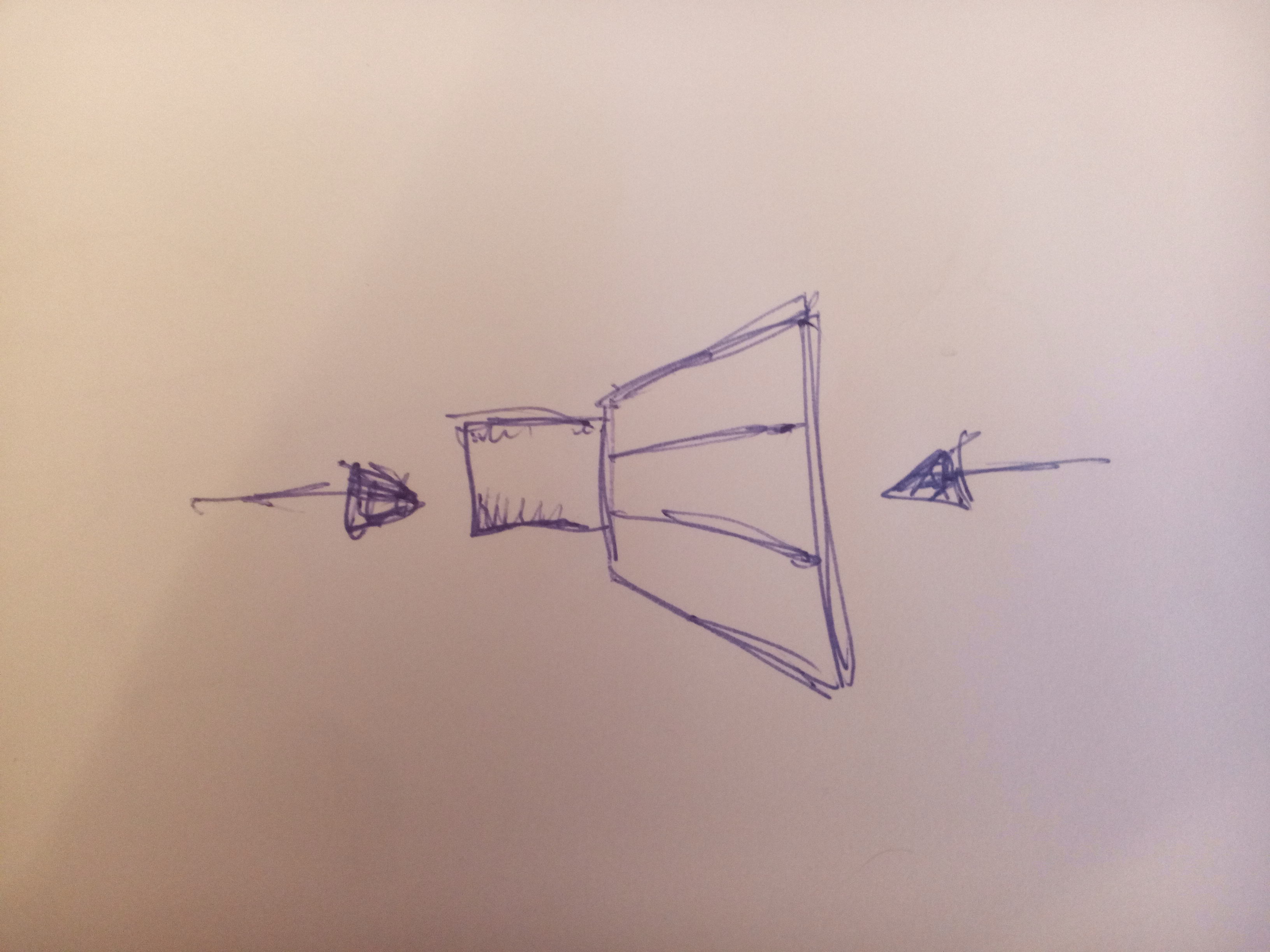

Better, for best playing, is, to clamp the drivers. Much more effectively than using of unlaqueured and corroded drivers;-)
Do not forget the backside;-!
1. The backside is inside the cabinet so is not exposed so why lacquer or wax the rear?
2. What do you mean "clamp the drivers"?

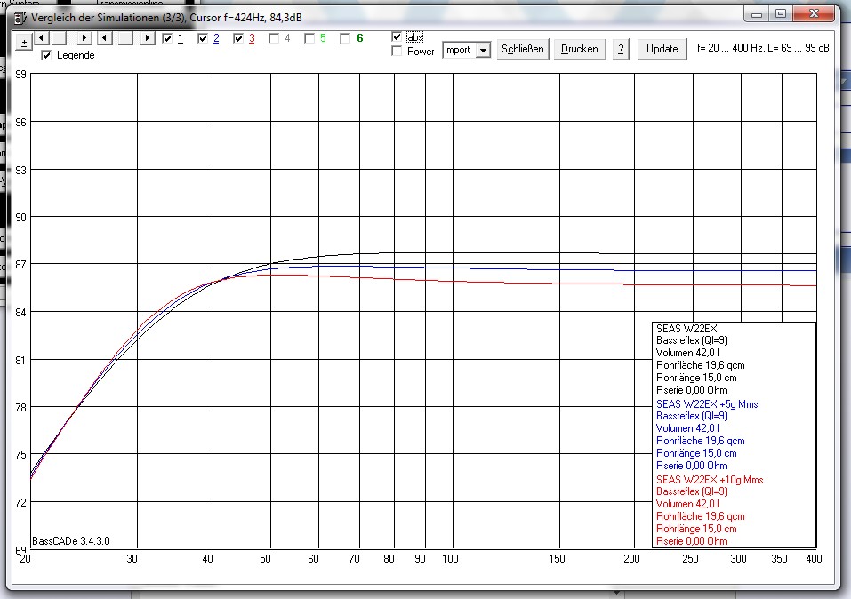

To add some kind of varnish to the surface add weight and so does wax. Probably less but it still adds weight. So, how much added weight is acceptable?
The W22EX got a Mms of 28,012g according to my simulation software, that is including air mass. Seas says on the datasheet 26,2g plus 1,89g air mass, which comes to 28,09g which is extremely close and probably only differs because of different rounding methods. The effective piston area is stated with 219cm², that includes no dustcap (-> Phase Plug) but the half of the surround. To protect the membrane, the backside of the cone has to be surface treated aswell ofcourse, otherwise it's only cosmetical and the destruction will continue there unnoticed. So, let's assume it's roughly 200x2=400cm² because to be sure to seal the surface, you'd probably go over a bit of the area twice while overlapping doing so, that seems realistic to me.
I've simulated it with +5g added the fs drops to 23 Hz, which is well within the tolerance, with +10g it drops to 21,4 Hz. I took these two weights because that's the lowest I could imagine you'd be able to cover the surface front and back with wax respective clear varnish. I'm not completely sure if that's accurate, I guess that's probably pretty close. Wax might probably be adding less weight, I'm not sure about that but it seems close to that number I think.
But let's just look what happens with +5 and +10g added mass:
So, in the bass it pretty much doesn't change anything worth mentioning. That seems plausible since the Fs is usually assumed to be normal if it's within +/-10..15%. The main thing here is, you are losing between 2 (+5g) and 4dB (+10g) from 80Hz upwards! That's a lot. And that means, the crossover has to be changed anyway.
Would I do that? Er, maybe the wax was an option since it is also relatively easy done but varnish is out of question. Regarding the success - I would not dare to lay out a complex prognostics regarding wax. I doubt it will save the drivers. Prolonging the remaining 'life' - yes, probably. Worth the effort? Well, since the drivers are already in a pretty bad shape, probably not.

The W22EX got a Mms of 28,012g according to my simulation software, that is including air mass. ...So, let's assume it's roughly 200x2=400cm² because to be sure to seal the surface, you'd probably go over a bit of the area twice while overlapping doing so, that seems realistic to me.

Clamp.
However;-)
If you use a wooden box, counter with/use metal. Screws, profiles. We do listen material-mixes too. More than THD, TMD, frequency-response... Wooden and metal are complement.
But better than wooden and metal: concrete or stone or some composites or so on;-)
Do not forget to clamp;-)
