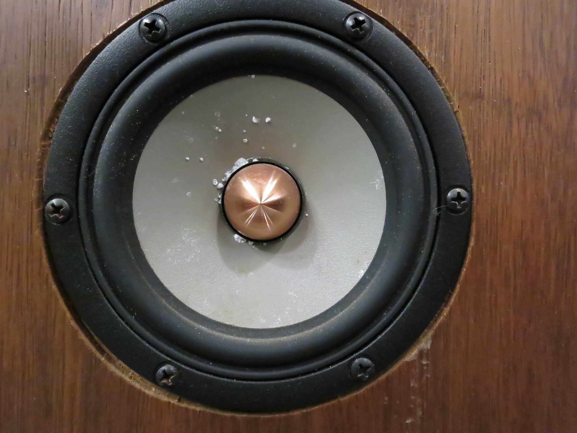

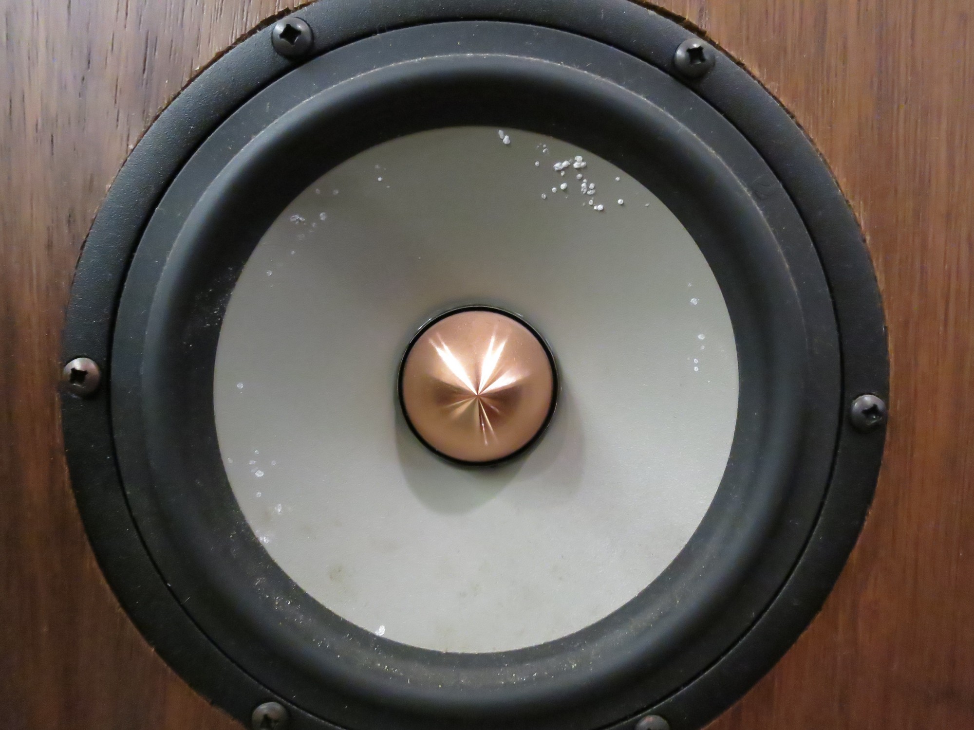

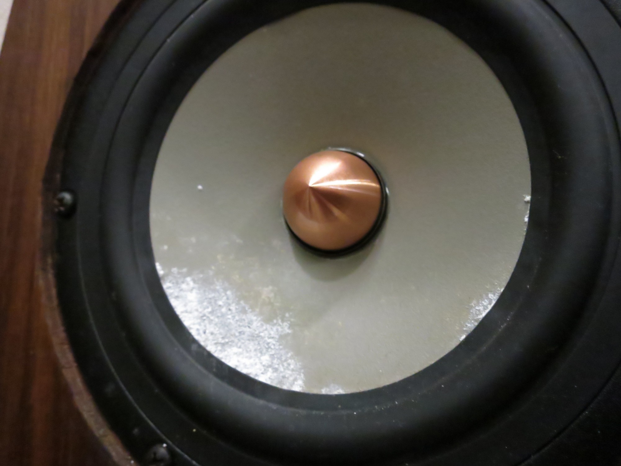

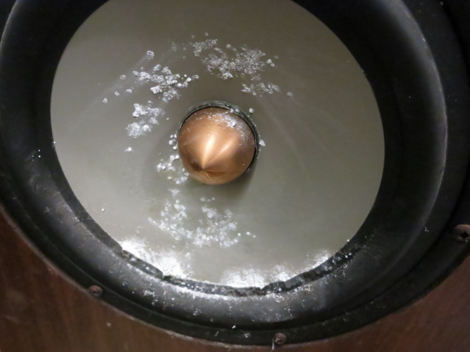

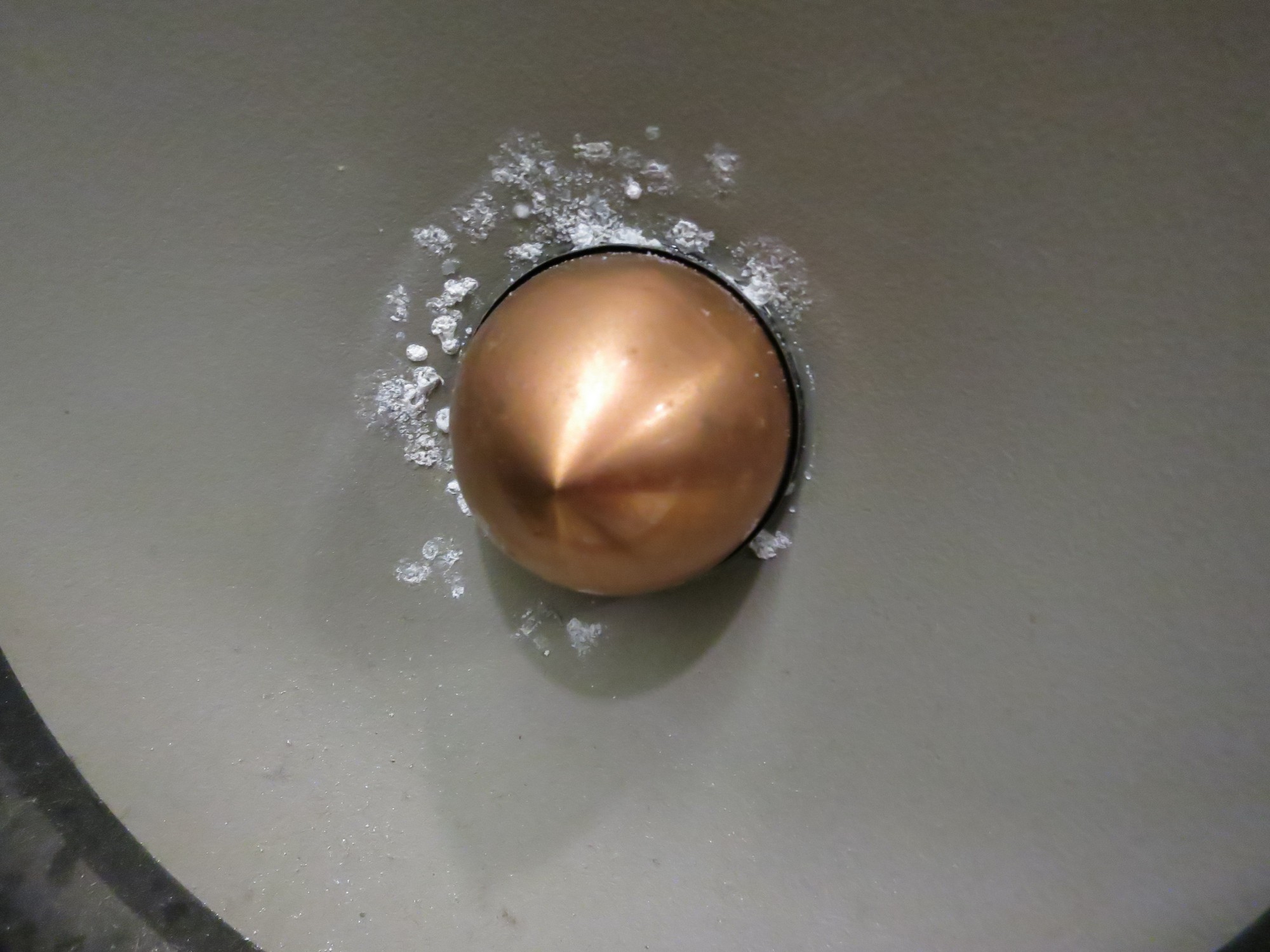

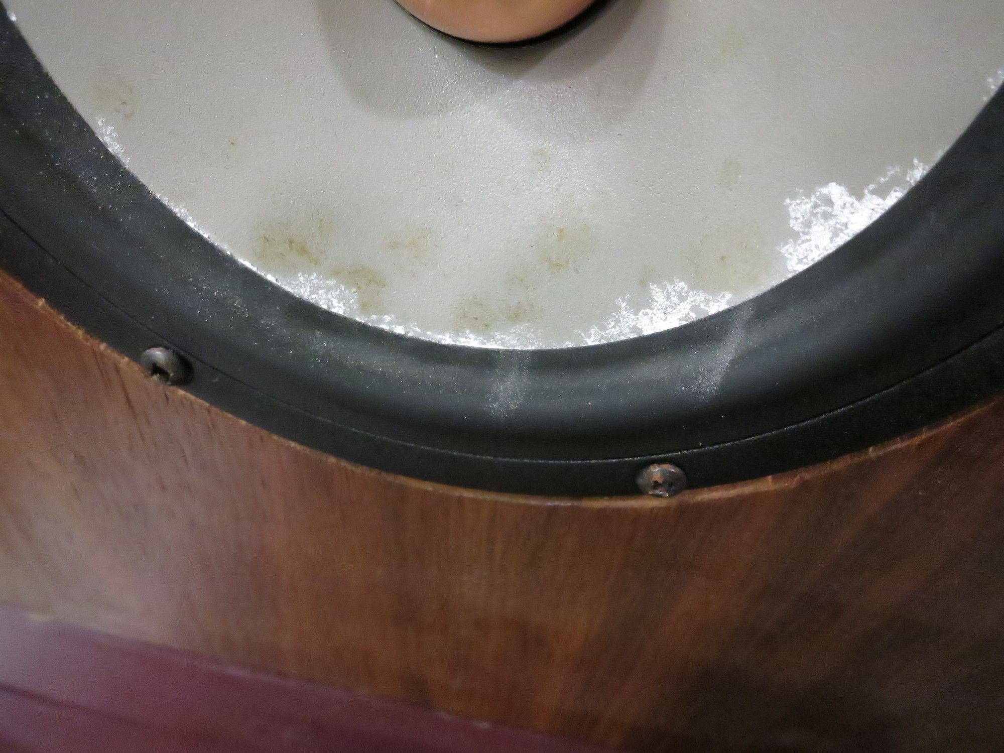

In 2012 I purchased 9 Magnesium Excel drivers (4 W22, 2 W18, 2 W15, and 1 W12) for the front and center of my home theater system.
All 9 show some degree of oxidation. The choices are:
a. Buy 9 more Magnesium drivers
b. Redesign the crossover and maybe using a different port length (tuning) retune the box to accept Nextel drivers.
The W22 and W18 are used for front and center bass AND the W15 and W12 are used for front and center mids respectively.
Which option is preferable? How much a redesign would moving from Magnesium to Nextel entail. The Nextel drivers are about 1-2db more sensitive but the W22NY woofer will not go as low as the W22EX woofer in the same box (about 42 liters per woofer) no matter what the tuning (even if I use Extended Bass Shelf).
I am not worried about the low bass (sub 100hz) bass response of the center speaker (W18).
The tweeters are Fountek Neo 3.0 for the front and CD 2.0 for the center if I remember right.

That's disgusting and shouldn't happen on these expensive drivers. SEAS needs a blast. I'd be spewing. 😡
I certainly wouldn't be using the Magnesium drivers again but the Nextel could be a good option but I'm sure there would be a lot of tweaking required. A cheaper option would be SEAS CA range but the sonics would drop.

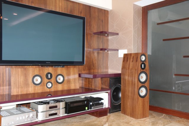

Thanks. These are pics of the rear speakers and my bedroom system as well (when they were first built in 2012).
I should check the rear speakers in my bedroom too.

I thought about Mg corrosion with Seas drivers. In my opinion it would need additional and unconventional care. I'm thinking about some liquid wax that is used for cars - sprayed on the cone. It would not add to the cone mass, it is clear coat so it would look good. There is some stuff guys here use with very expensive cars - wax that is activated by heat of hands and when applied it cools and hardens. If it's good enough for a Lambo, it could be good for Seas 🙂

Pure magnesium has terrible corrosion resistance, that's one of the reasons it is typically alloyed with aluminium. I wonder if the adhesive used to attach the cone to the former and surround accelerates corrosion, since in the pictures in this thread the corrosion seems to be more severe in those areas. They may also off-gas in hot climates.
As with a lot of drivers, it seems that they unfortunately just picked the material for the cone arbitrarily because it seemed exotic, instead of applying materials engineering. Annodised aluminium performs almost identically and is much more stable.
Automotive wax or silicone spray can be used to protect magnesium cones.

I doubt that Seas can verify anything about this.
I'm going by logic that salt and minerals that stick to the car ruins the paint job and waxes serve as an isolation from external conditions but without loosing any shine of the factory color.
I'm not into that business but i knew a guy who did only car polishing for extra expensive vehicles. He told me what i told you, so i guess that you can find out more on the subject on car forums than from me at this point.
Automotive 'wax' makes water bead instead of pool (hydrophobic), which makes it run off surfaces more easily instead of forming pools of standing water. The water running off onto the ground transports contaminants to the ground which would otherwise be suspended in pools of water, which would dry on the painted surface and result in unsightly water spots. Contaminants don't like sticking to a waxed surface either, so next time the car is washed they can be removed with less aggressive scrubbing methods, preventing scratching the paint during cleaning. Automotive paint is just plastic so it won't degrade quickly when exposed to moist conditions. Extremely acidic liquids (e.g. bird poo) can attack it (or slightly acidic liquid over a long period e.g. a damp car cover), but other than that it mostly degrades due to UV exposure. Contrary to popular belief the paint on a car will stay in excellent condition as long as you keep it out of harsh sunlight, clean off highly acidic substances promptly and prevent grinding dirt into it when you wash it.
We don't need to worry much about cleaning dirt from a magnesium cone so the above properties of wax don't help us much. What does make wax useful is that since it is hydrophobic, it provides a moisture barrier and after applying and buffing it off it is 'dry' so it won't attract dust. Silicone based sprays are also 'dry' and make water bead so they accomplish the same thing. Automotive 'wax' is typically not silicone based because silicone leeches into the paint finish and makes repainting a panel a nightmare since the new paint doesn't want to adhere.
Oil would serve as a moisture barrier but it remains wet and greasy so it attracts dust. Many oils (mostly petroleum based) will also dissolve plastic and rubber parts, adhesives.
Automotive wax or silicone based sprays (for lubricating plastic parts or for spraying on interiors to make them darker/blacker) should be reasonably safe for rubber if used sparingly.

Rather than throw them out, I cleaned off the corrosion as thoroughly as I could and then I sprayed the cones black and put them into a pair of speakers I made for my son with a Bluetooth amplifier and rechargeable battery pack from Dayton.They seem to have held together well. My assumption was that there was a protective coating on the W12s which was inadequately applied and I needed to apply a protective coating of my own. I hope this is helpful.
