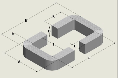

Window area and window shape: Let's define what we mean.
Hopefully all confusion will disappear if we agree on what we are actually discussing.
OK,
Here are the most important abbreviations used in "magnetics" and known to people who are into the matter:
- lfe = mean iron path length (yes mean path length around the core);
- Afe = net iron cross-sectional area (not the same as height x width!);
- Mfe = mass of iron core;
- ha = height of winding space;
- ba = width of winding space;
- lcu = average length of coil winding (average length of one turn);
- Acug = geometrical copper cross-section (ha x ba).
Source: "Strip wound cut cores" by Vacuumschmelze.
Which in books written in English might more often appear as:
F = window width [cm]
G = window length [cm]
MPL = magnetic path length [cm]
MLT = mean length turn [cm]
Ac = effective iron area (D x E) [cm^2]
Wa = window area (F x G) [cm^2]
Wtfe = iron weight
Wtcu = copper weight
Wtfe = iron weight
"ha" and "ba" are more accurate parameters.
F and G are geometrical core dimensions; F and G do not take into account the loss of space by the bobbin.
For example, for an SG89/51 double c-core Vacuumschmelze specifies ha being 20,1 mm, whereas without bobbin there is 22,2 mm of space.
