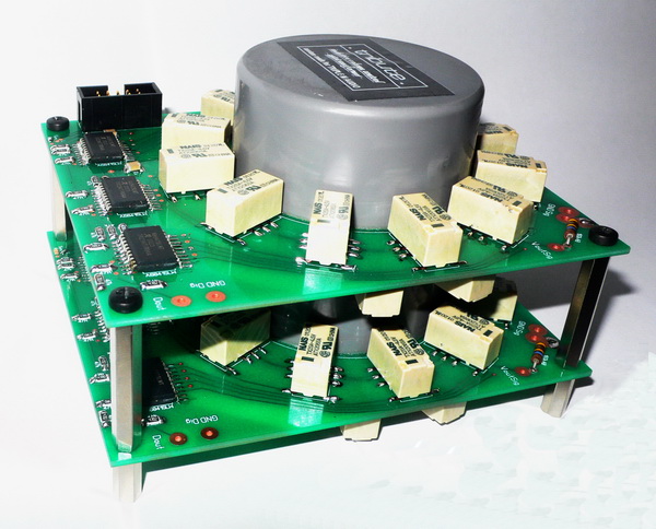

Autoformer volume controls are great (for audio 😀); they need some treatment however to give off their best.

Autotransformer volume controls work well because there is no real power being transferred. When the secondary does get loaded down for real power transfer, it (the opposing load current) pushes B fields out into the leakage L pathes, causing HF loss unless everything is interleaved. (which it isn't in the variable volume controls.)

I do have an early prototype of stepped volume control from Dave S. It has a strange garble to low level signals, but that is likely due to all of the flying coil leads randomly stuffed into an aluminum box.
