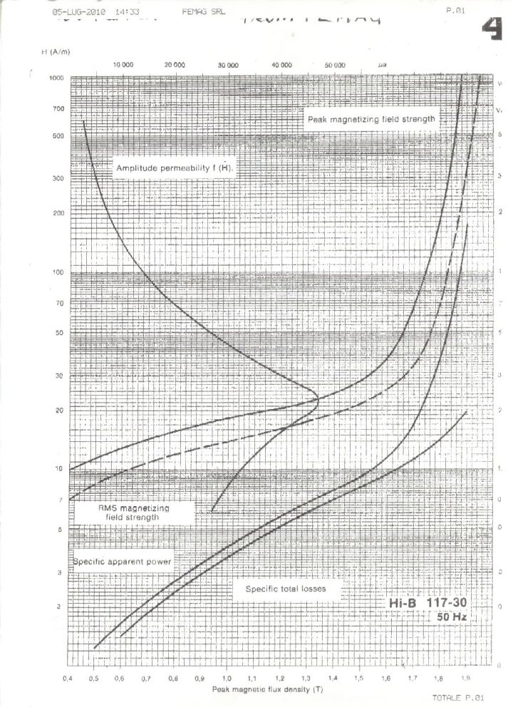

Inductance with gaped core and DC current and ungaped core without DC current:
3.2 X ( Np) squared X ((core square area)X 0.92) X permeability / mean path length X 10 to the eighth
Permeability with gaped core:
1/ (1/ permeability + total gap length / mean path length)
Flux density generated by DC current in Gauss:
0.6 X Np X DC current / full gap width
  • Commercial core DC perm chart.pdf
  • Commercial nickle core.pdf

Usage for the three charts has the following caveats.
The initial perm shown on the commercial iron charts is what you use for 1 vac & 120 Hz.
The max perm shown is for minimum DC permeability, you can expect up to as much as 60% better performance, but no worse. All depends upon the mfg and how well they match the chemicals and annealing on any given day.
The nickle perm charts are for AC. Nickle struggles with DC and can easily self saturate in incremental amounts.
The Hi B chart is for M6. The only interesting squiggle is the vertical oriented hump that shows perm in AC, up the frequency bandwidth. Very important to understand this performance difference between AC and DC permeability. AC permeability begins at the top of the DC flux density.
Now you need to think about the coil. Keep in mind that these are antennas signaling each other within the ferrous boundary of the window. The core is just along for the ride and regardless of the type, it is getting in the way.
