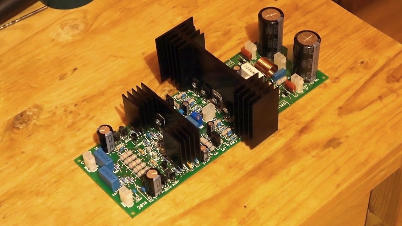

Well, I don't really like to have those transistors at the drivers' bases... At 4.5A per output pair protection will shut-down the amp.
Wow, those are some serious heatsinks.
Do those small transistors dissipate that much heat?
Well, that's definitely an overkill here. I will probably change them to something smaller and simpler over the time. Good for testing though 🙂

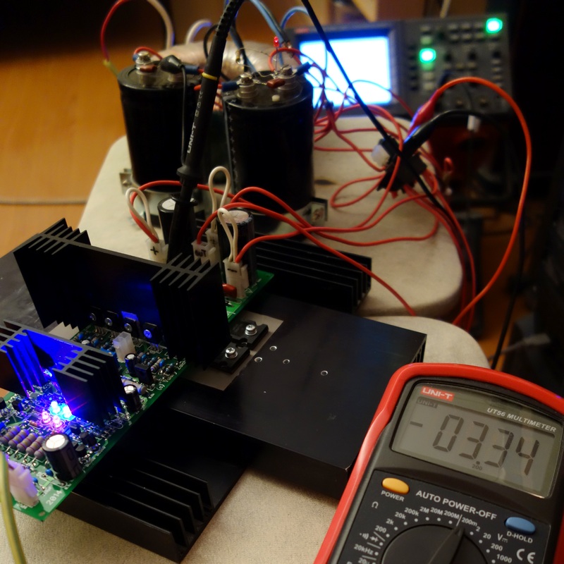

Just tested with no output transistors and no load.
Runs well. The funny thing - you were right, probably it will run fine with no servo, I'llll try it later - there's no power-on blip at the output at all. Not a short one or low-level one - just nothing 😱

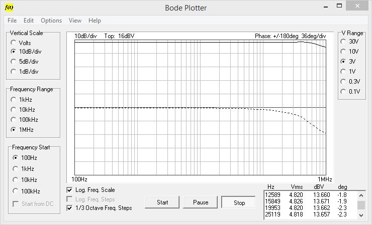

Measurements!
OK, finally - testing and measurements.
I tested it with MJL21193G/21194G at the output.
Only front-end to-92 transistors are roughly matched (within more or less 20%), all the rest - no matching.
First of all - it's very stable. No sign of any kind of oscillation whatsoever.

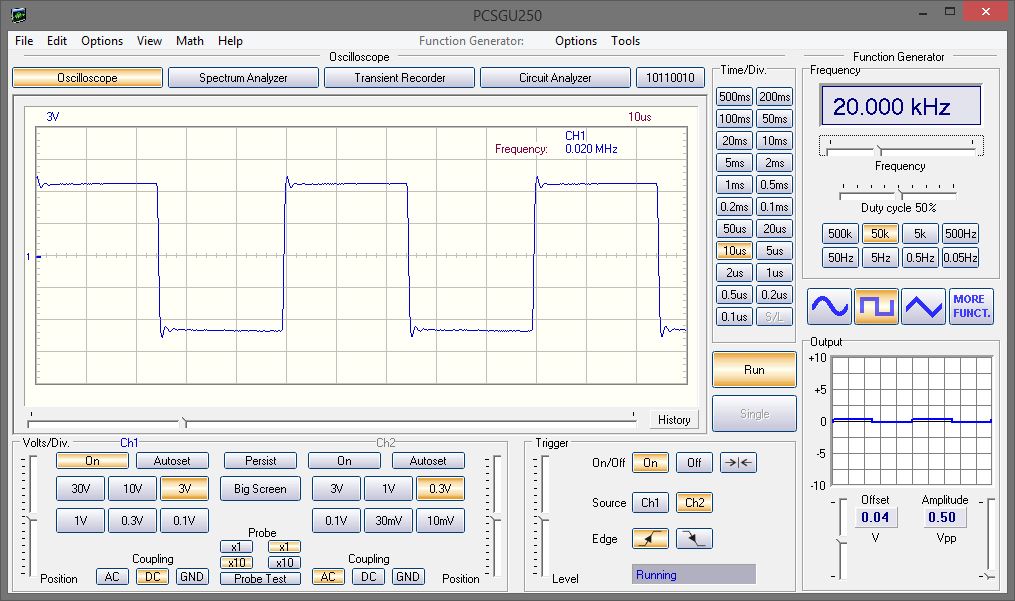

I have checked the offset with no servo - gives +230mV. Not bad, assuming this is a CFA with no DC decoupling cap. Servo makes it less than 5mV - you can see it at the first picture.
Bode plot shows wide bandwidth (close to 1MHz at -3db) with excellent phase response(-2.3 degrees @ 20KHz). Fast one.

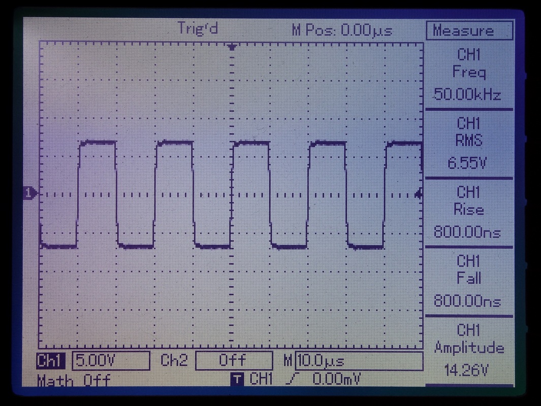

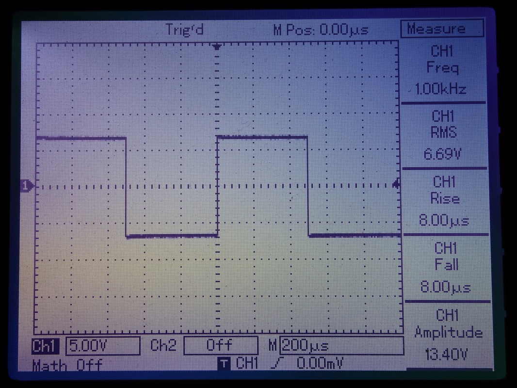

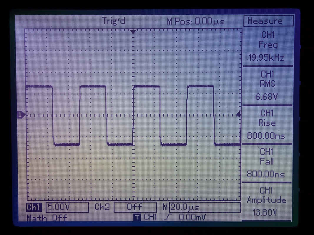

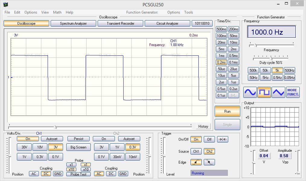

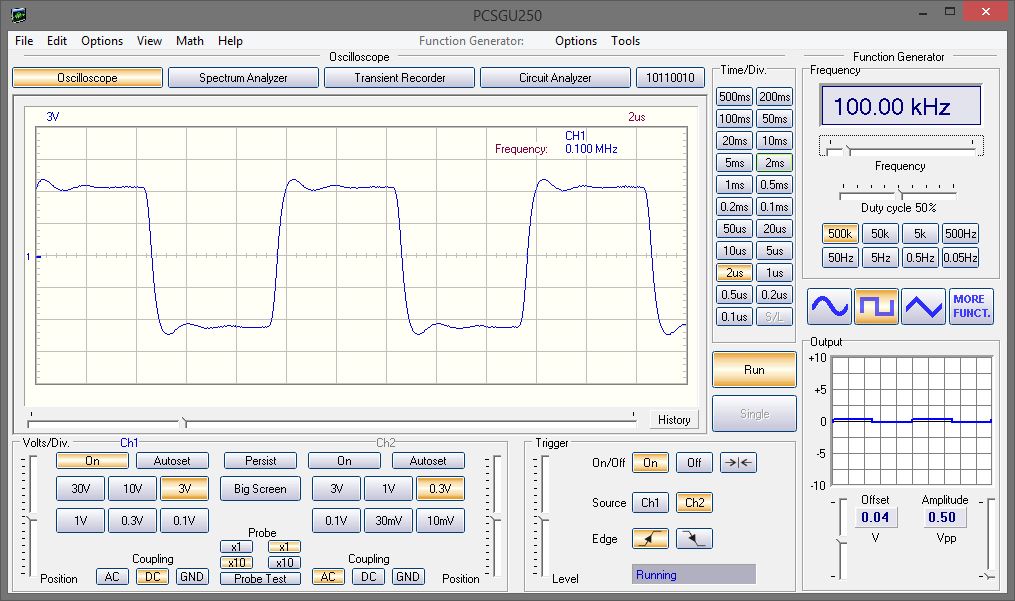

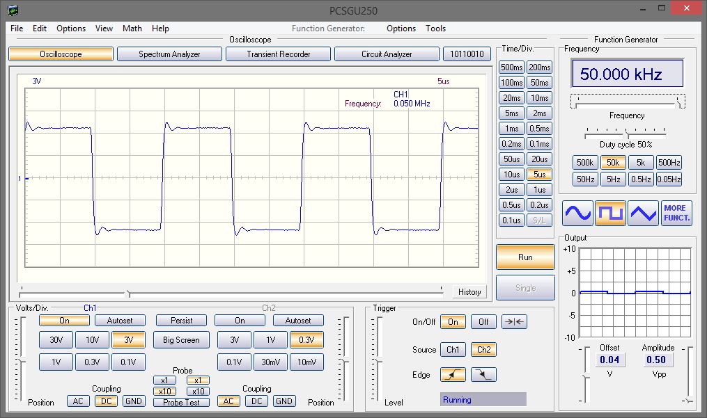

Square response - not bad, but there is some overshoot, clearly visible at high frequencies, with a couple of fading revolutions before it settles. This is something I don't like and I'm going to investigate it deeper.
The other point that slightly concerns me - thermal stability. I need to make the second heatsink (with the drivers) much smaller. They are barely warm and, I suppose, thermal feedback is not as effective as it could be with the smaller one. Output pairs run at 30-35mA with no signal - rather cold when idle, warming up at higher swing.

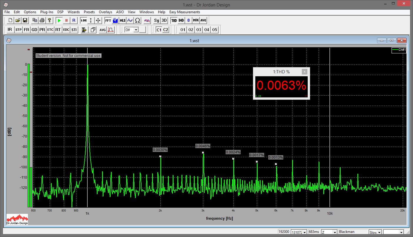

THD - not bad, higher order harmonics concern me a bit, however absolute level is low enough and I doubt, this is somehow related to the overshoot, mentioned above. There is an interesting dependency though - frequency wise, minimum is at 5-10KHz, slightly increasing towards the lower frequencies, as well as towards the higher ones.

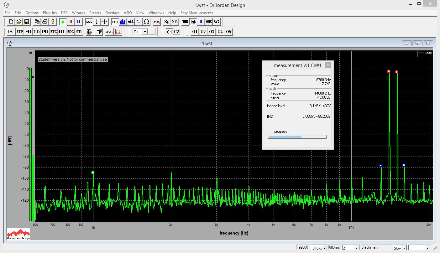

Intermodulation is good.

It's not surprising the drivers aren't warming up with that monster heat sink! Should Q15 be tracking driver temperature or output device temperature?
Definitely some experimentations with caps:
- C11, C12 too high or eliminate
- C8 too high or eliminate
- C9, C10 trimm to set
- C35, C36 1 uF or higher
In case of CFP output arrangement it makes sense to track the drivers. Heatsink definitely must be smaller. Otherwise, it's like trying to boil a swimming pool with tea boiler 🙂

Well, I have adjusted compensation, so that I get decent squares, but now the problem is - as soon as signal frequency exceeds 200KHz, the drivers and outputs heat-up significantly, and around 700-800KHz I get shoot-through (both output shoulders are open). OPS seems to be too slow...

The funny thing - I'm testing with no output transistors now (and no load except NFB, which is ok for these 2 pairs of drivers).
Giving it 2KHz square, 13.4V amplitude at the output - excellent waveform, no problem. Drivers are cold. Half an hour in this state - still cold.
Increasing the frequency to 200-500KHz (same amplitude). Within a minute the drivers get hot. No oscillation or other artifacts on the scope. How is it possible? It's not the case with my VFAs - they run at 500KHz same as at 1KHz.
I agree, MJL21193/21194 are slow (fT = 4MHz), but I have tried NJW0281/0302 with fT = 30MHz... same result.
Well, I don't want to connect the output transistors until I make the drivers cold enough at 200KHz...
