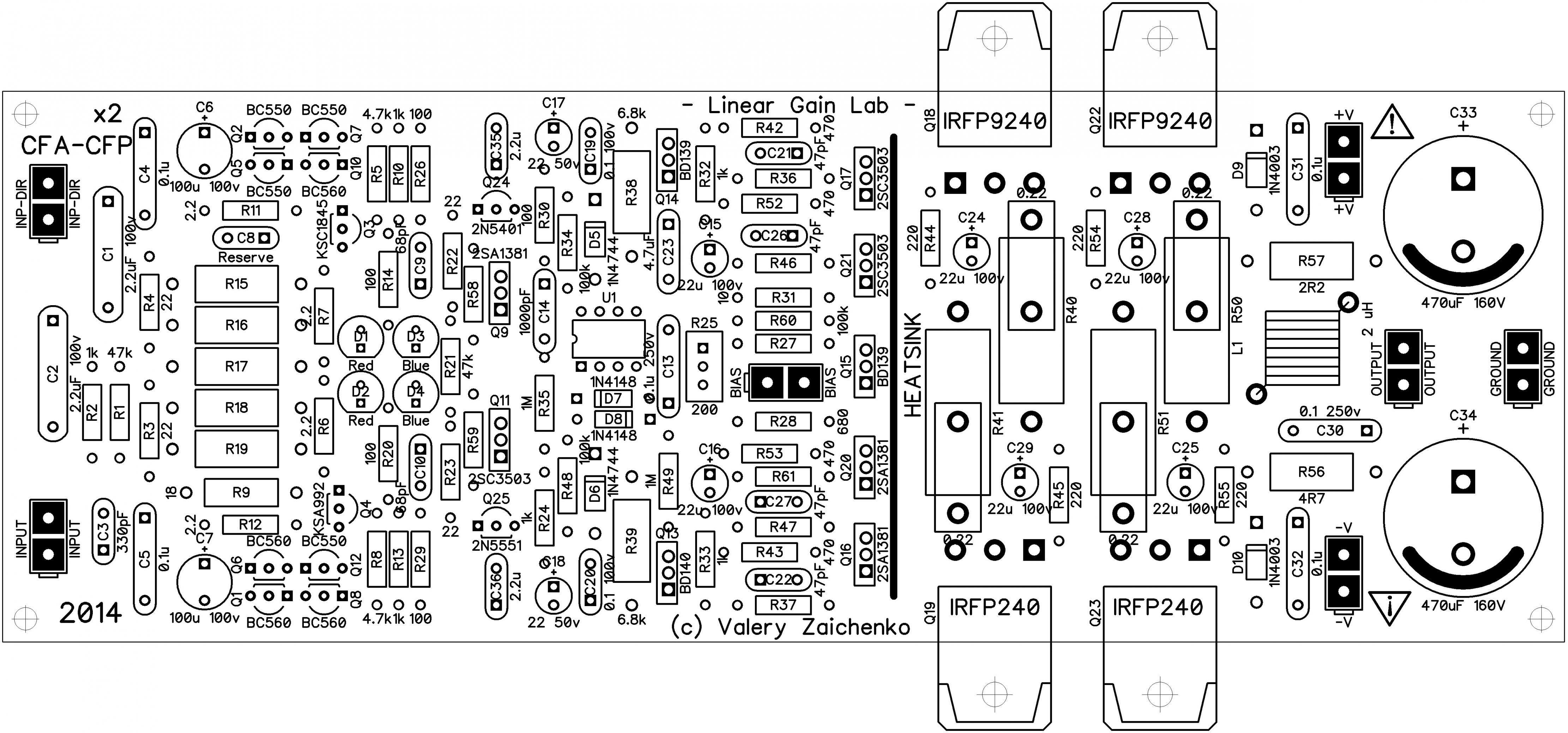

Updated PCB
Just updated the PCB according to prototype adjustments.
Silk screen is also significantly improved.
Gerbers are available on request as usual 😉
Valery

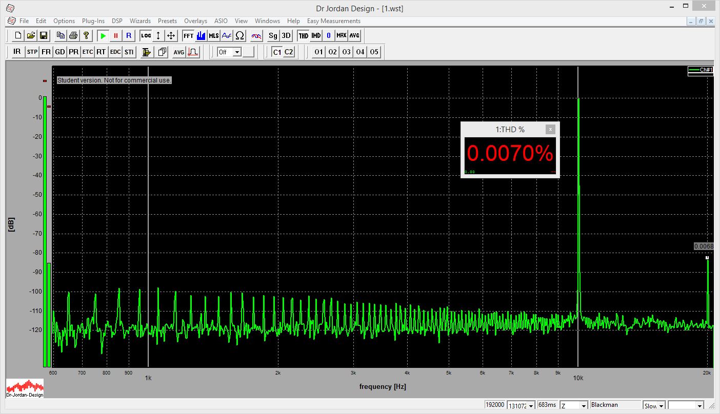

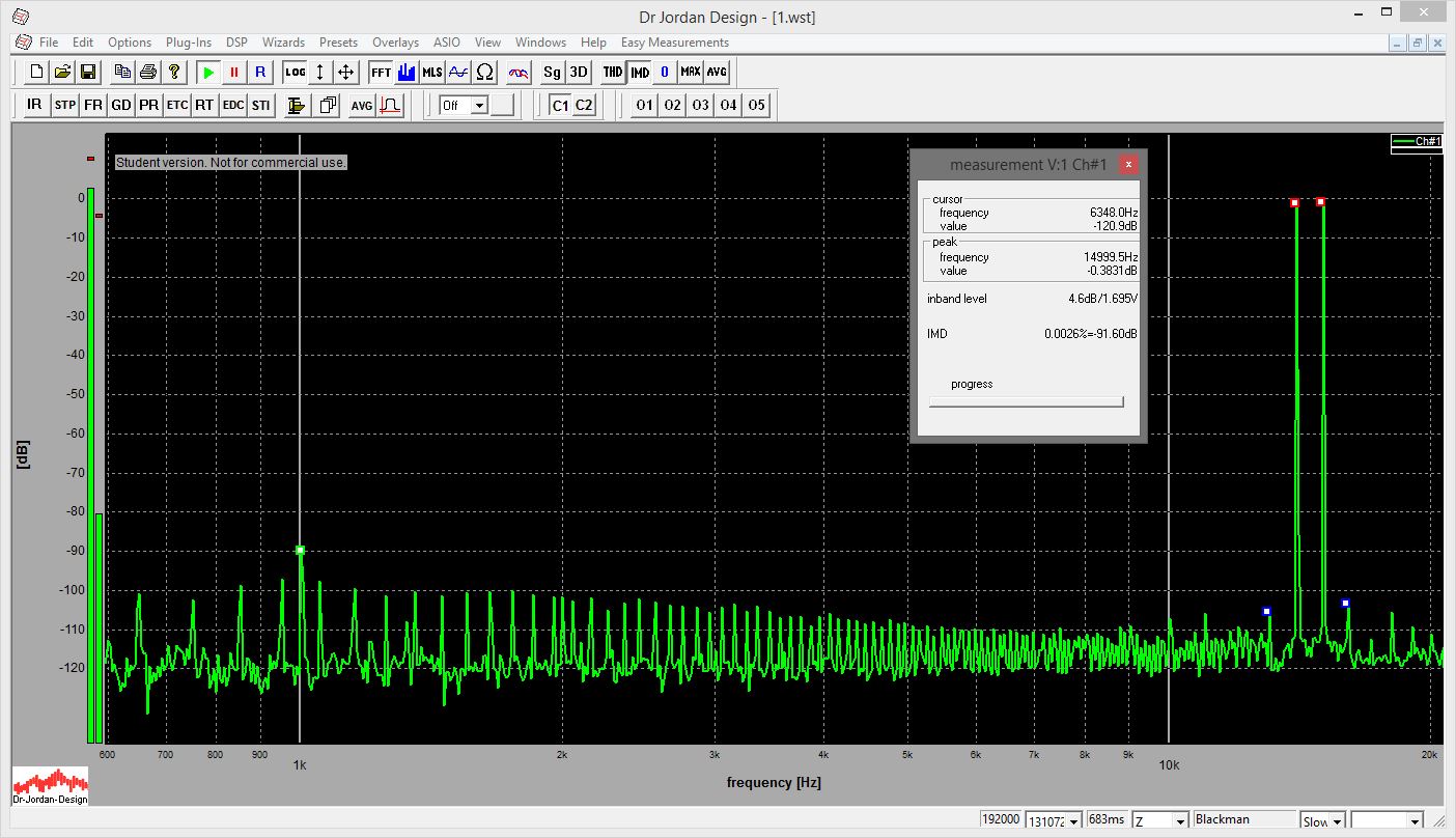

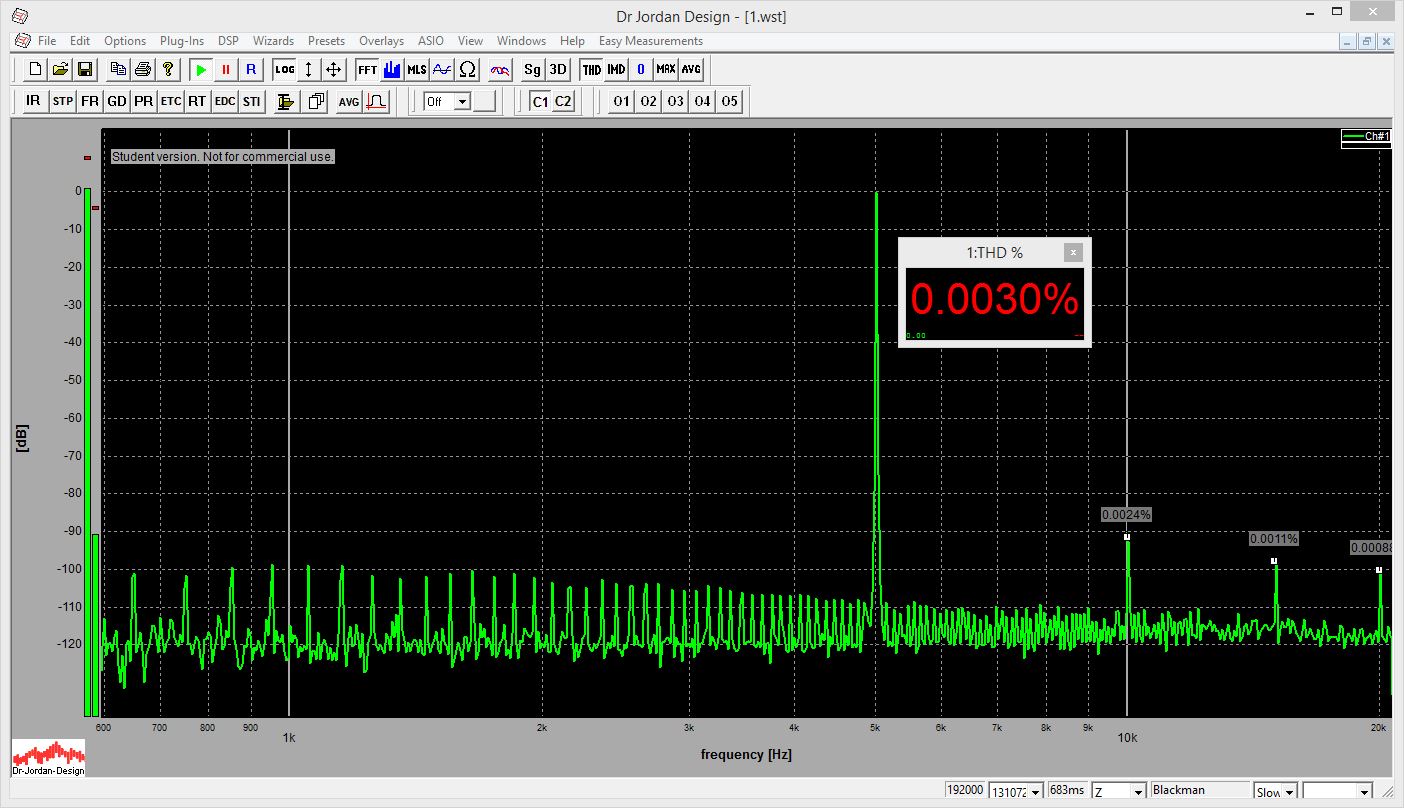

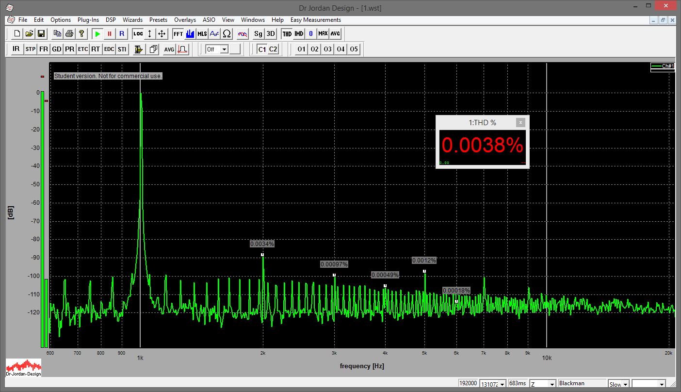

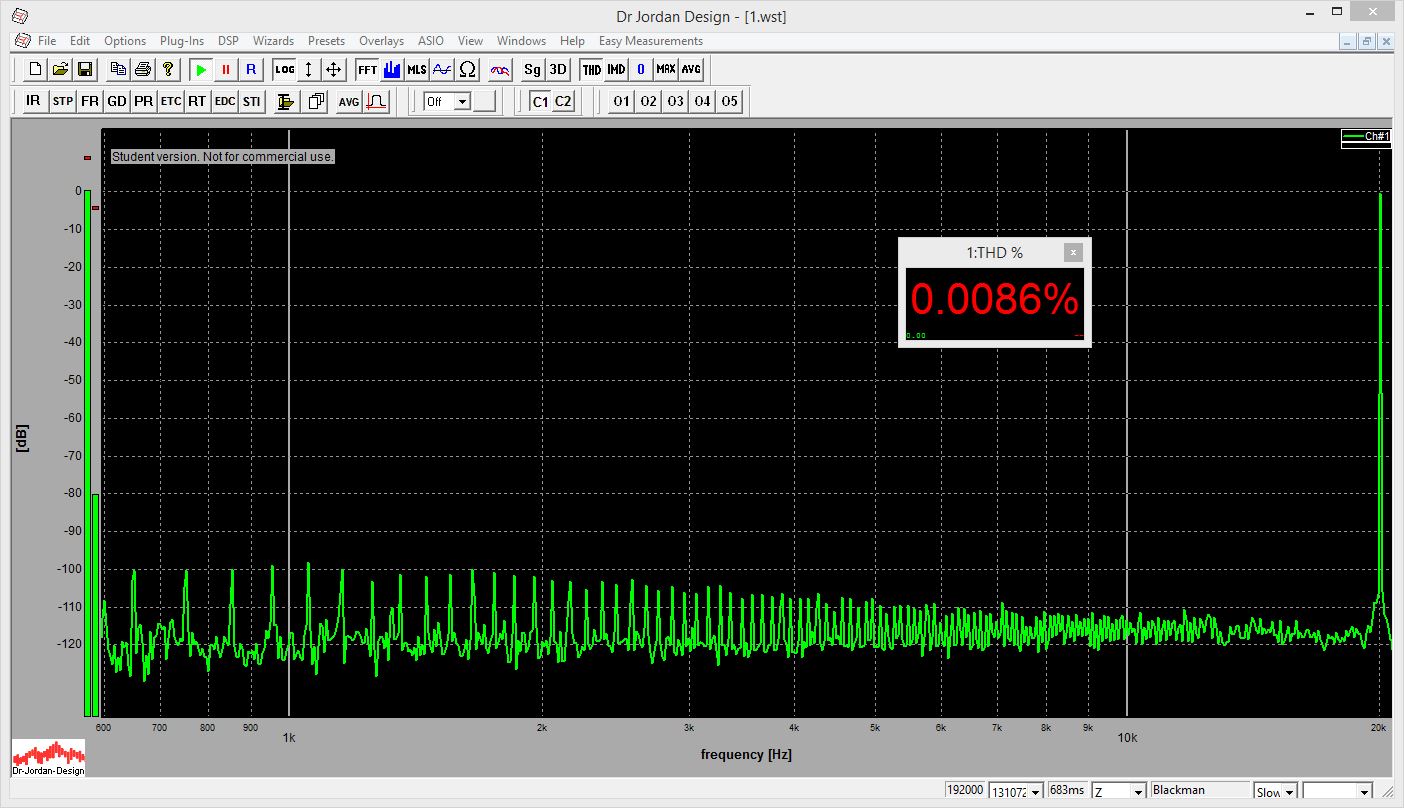

Increased VAS gain
Tried decreasing R26, R29 to 22R, leaving all the rest as is.
VAS current comes close to 40mA - cascodes are running pretty hot.
With R26, R29 = 47R, VAS current is 18.5mA. Optimal quiescent current for the output pairs is 35mA. Re-measured THD / IMD.
No noticeable change in listening tests.
Sounds equally good 🙂
