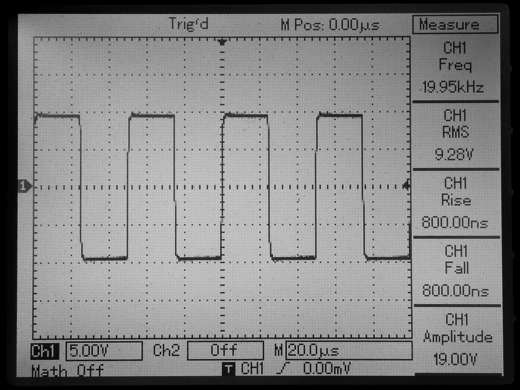

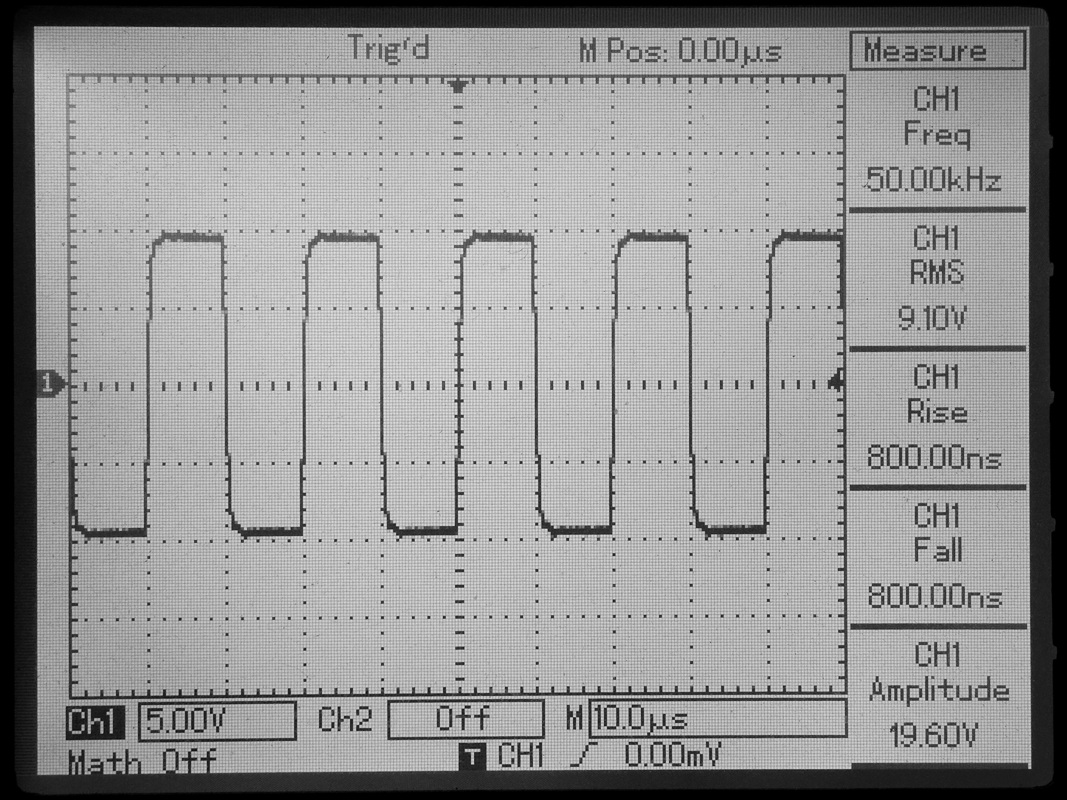

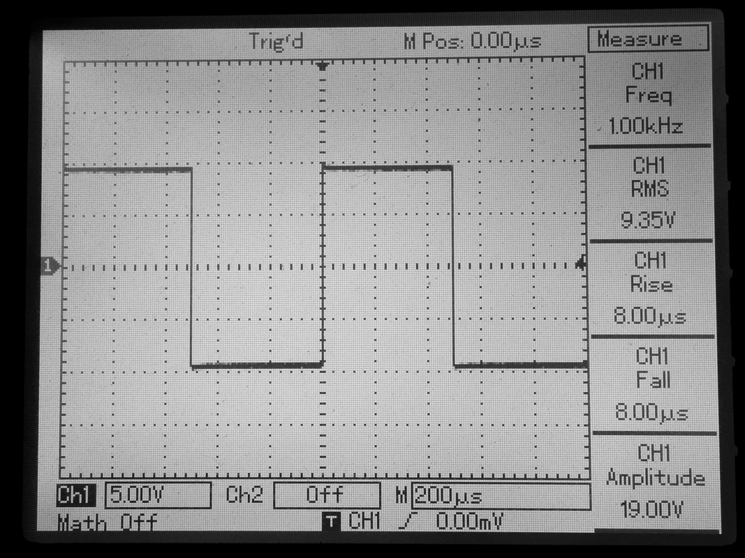

OK, I have tamed it. I would say, this is the first time I had to deal with IPS, which is that fast. MJL21193/21194 is not an option here. They work fine in audio range, but get killed easily as soon as 500KHz square wave appears at the input (closing too slowly).
I've got no MJL3281/1302 in hand at the moment. So what I did... you wouldn't believe it 😛 Or maybe you would, but it was a bit unexpected for myself - at least, I didn't plan it initially 🙄

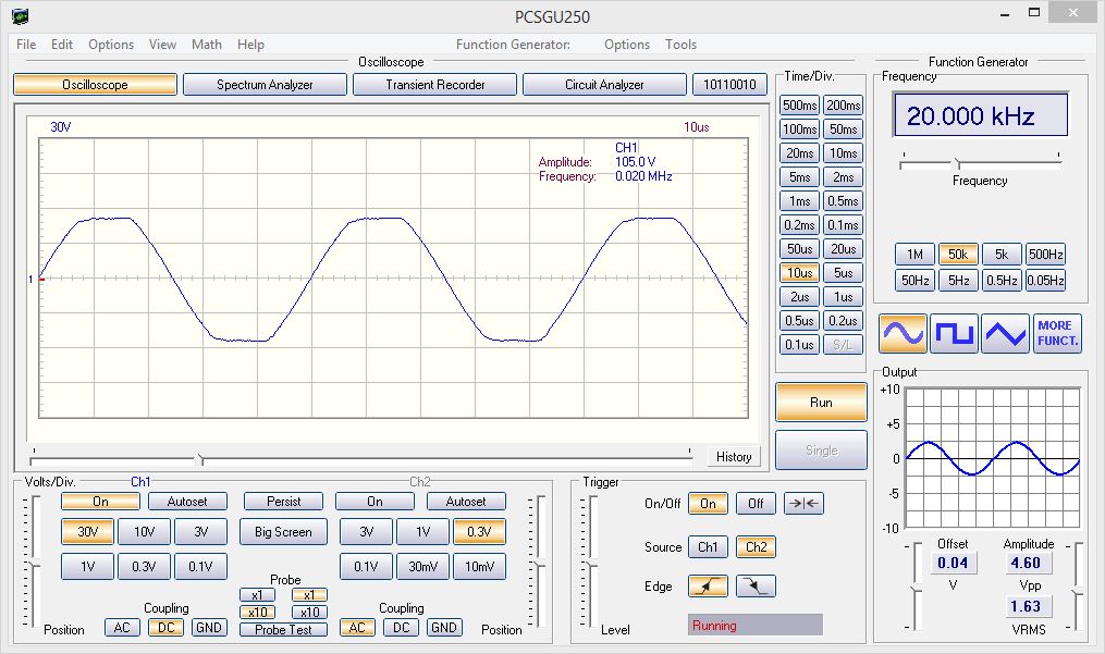

"Composite" Sziklai with HEX FETs. Good old rugged IRFP240/9240. Their high non-linear input capacitance doesnt hurt in CFP arrangement with its 100% local NFB. Otherwise - they are fast and easily deal with high currents if necessary. Base stoppers and shunt capacitors at the drivers' bases play an important complex role here. Being a part of the global NFB loop they also prevent the "evil" CFP pairs from local oscillation. Optimal values are 68R / 47pF each pair. Miller caps around the super-pairs are 68pF each. No lead compensation caps at all.
Just in case, I keep the input HF filter cutoff frequency at 480KHz (lower than I usually do).
The screenshots show the square wave response at 1KHz, 20KHz and 50KHz as well as clipping at 20KHz (superpairs in action).

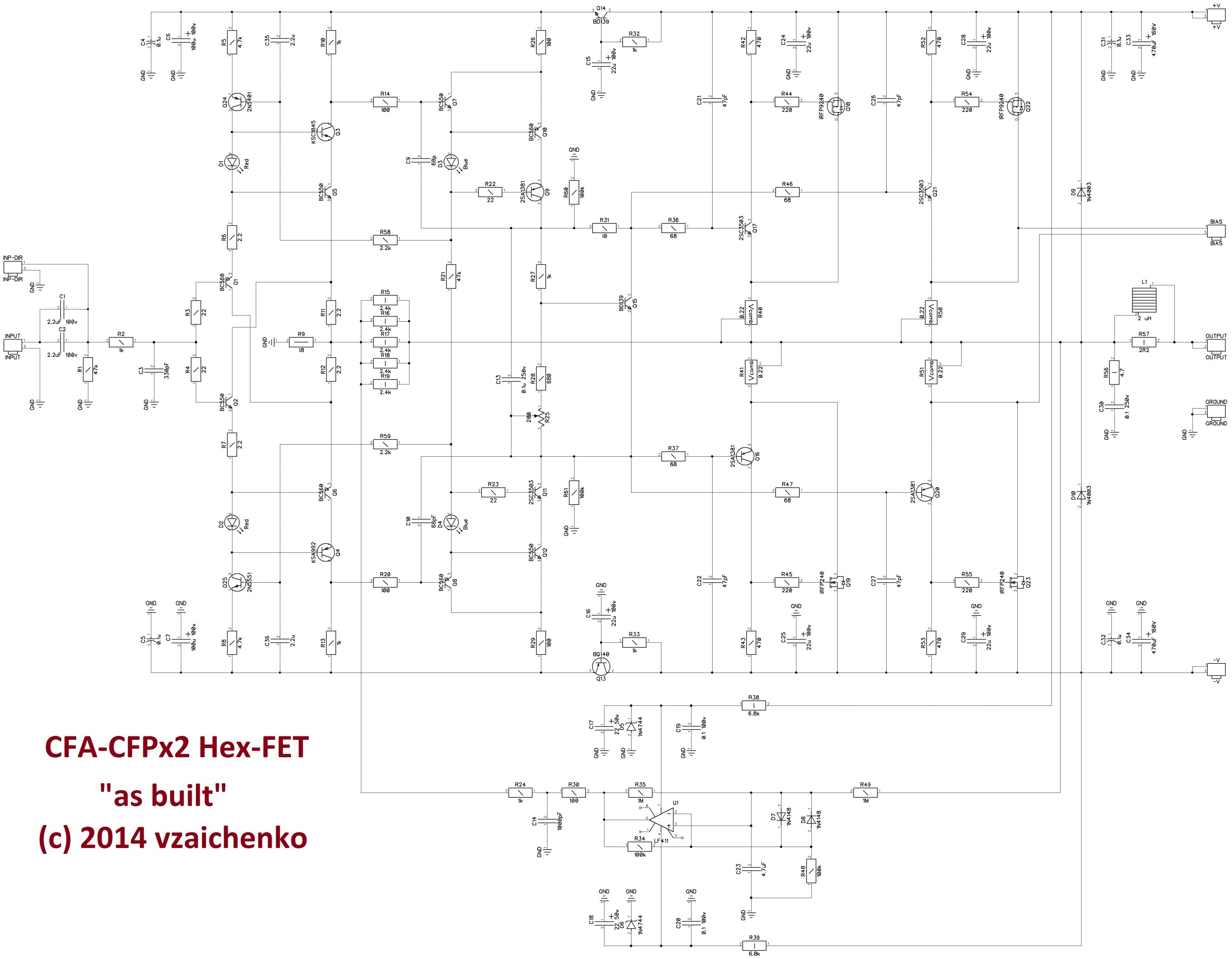

Attached is the schematic "as built" for now.
Updating the PCB 😉

You may have a question about some "strange" 0.22R resistors at the output - the only reason for them is having additional holes in PCB for the vertical type of resistors and still maintain compatibility with schematic in DipTrace. I use 5W cement ones.
BTW, PCB is fully compatible, regardless of what kind of output devices you use (FETs or BJTs) - no changes required except some parts' values. BCE <-> GDS 😛
