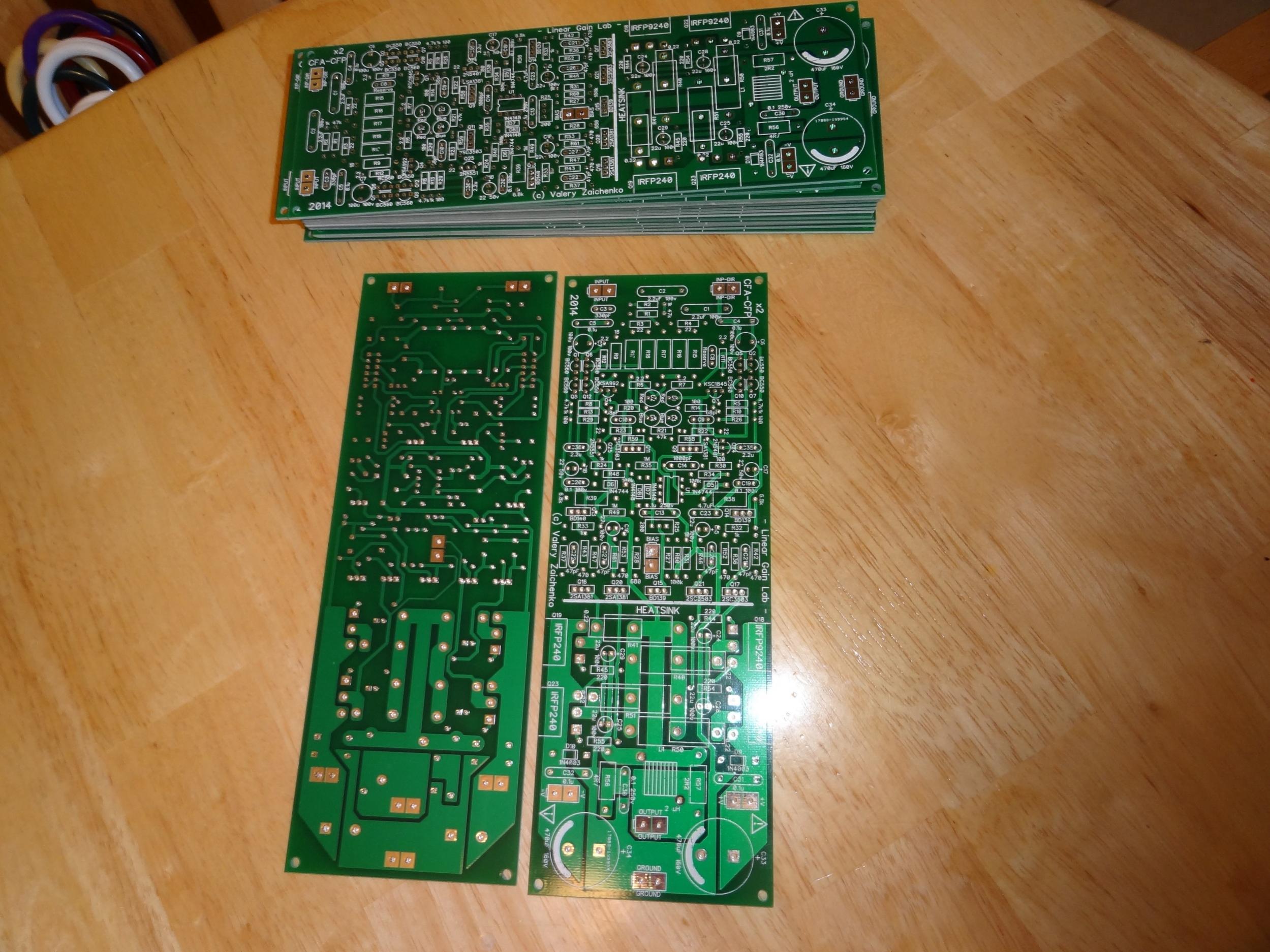

I've got a single-channel prototype running now, ordered two more PCBs to buyld a stereo amp in a nice compartment.
I've got a single BJT board up and running. I'm having very similar DC offset issues like I was with the Tubesomo boards for the last couple days. I'm really starting to wonder about this batch of op amps.

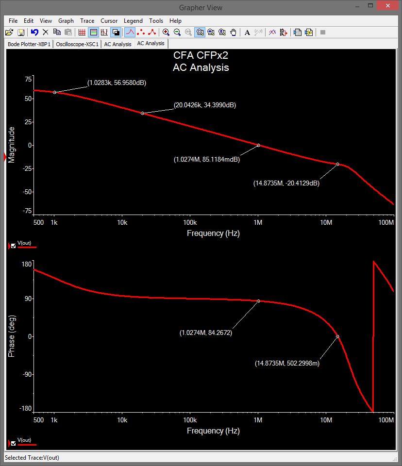

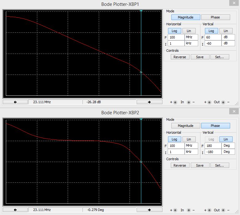

OK, I have finally reached my server remotely and have built the curves.
They are pretty "clean", as promised in the thread title 🙂)), showing the following key parameters (rounded values):
ULGF: 1MHz
Phase Margin: 84 degrees
Gain Margin: 20db
CLG: 29db (set by global NFB)
OLG(1KHz): 57db
LG(1KHz): 28db
OLG(20KHz): 35db
LG(20KHz): 6db
In overall, this is a rather low LG, high-linearity design.

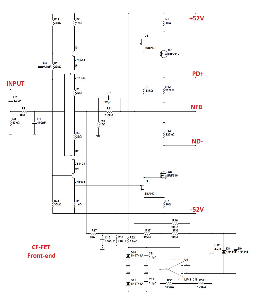

Here goes a simple one! 🙂
Ready for something new? 😉
Greetings from Switzerland, I'm still here. Skiing was limited during the last couple of days due to avalanche danger - no problem, spare time was used for testing some front-end ideas 😛
Of course, not prototyped yet - I will work on PCB over the weekend - however it is simmed thoroughly and looks very promising.
Only 8 active devices (excluding DC servo). Compensation - single lead cap. All the rest is done by the FETs' internal capacitance. Very simple. DIYer's dream 😀
JFET input stage, JFET-MOSFET "super-pair" VAS stage. That's basically it. Two BGTs are used as a cascode (common base) for limiting the input JFETs drain voltage.

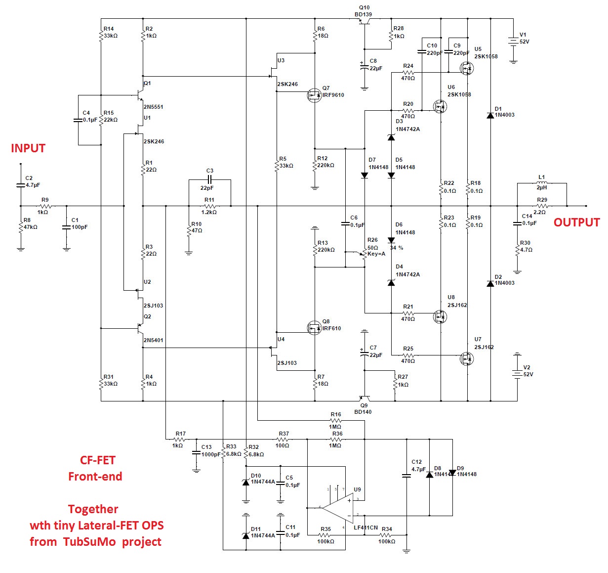

Developing this front-end, I actually had in mind my simple Lateral-FET OPS from TubSuMo project. Partially for that purpose, VAS is running at high current (20mA). If somebody wants to use it together with other OPS modules, designed for lower VAS currents (4-5 mA) - no problem, one can change R1, R3 to 43R. Similar performance with probably very slightly higher THD at 10-20KHz.

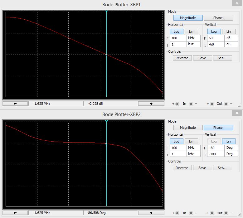

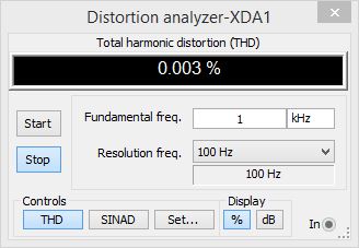

Attached files represent:
1) Front-end schematic;
2) Front-end together with Lateral-FET OPS (all further measurements are done for this particular combination);

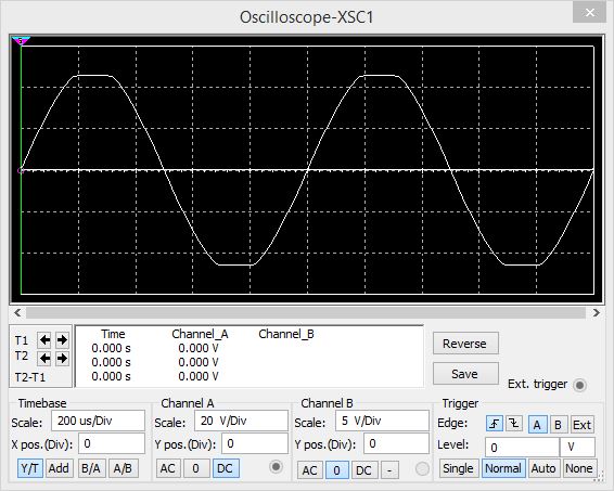

3) Clipping behavior - nice, soft, rounded corners;

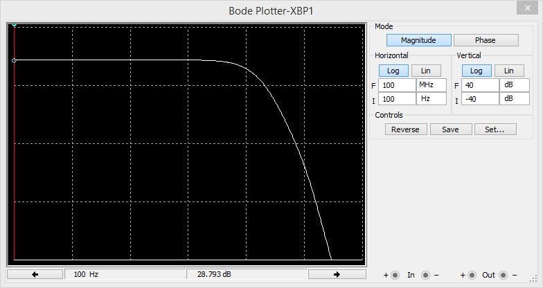

4) Closed loop frequency response (left edge is 100 Hz);

6) THD @ 1KHz (simulated value);
7) AC analysis - Phase Margin;
8) AC analysis - Gain Margin.
Key parameters (so far - per simulation):
Output power - up to around 120W @ 8R (with +/-52V rails);
Voltage gain: 29db;
ULGF = 1.625MHz;
Phase margin: 86.5 degrees;
Gain margin: 26db;
THD @ 1W: 1KHz<0.001%; 10KHz=0.002%; 20KHz=0.006%;
THD @ 50W: 1KHz=0.003%; 10KHz=0.016%; 20KHz=0.038%;

Hi Valery! FYI -- this is exactly the topolgoy I use for almost 40 years now.
THx-RNMarsh
I like the approachIt's a good low-noise jfet. Great for inputs.
This one fits the title of the thread a little better. 😀
Can this one be tailored to work with the Slewmaster OPS as well?
Blessings, Terry
THx-RNMarsh
Hi Richard - it's not so new then 😀 But it makes me sure I'm going in the right direction 🙂
