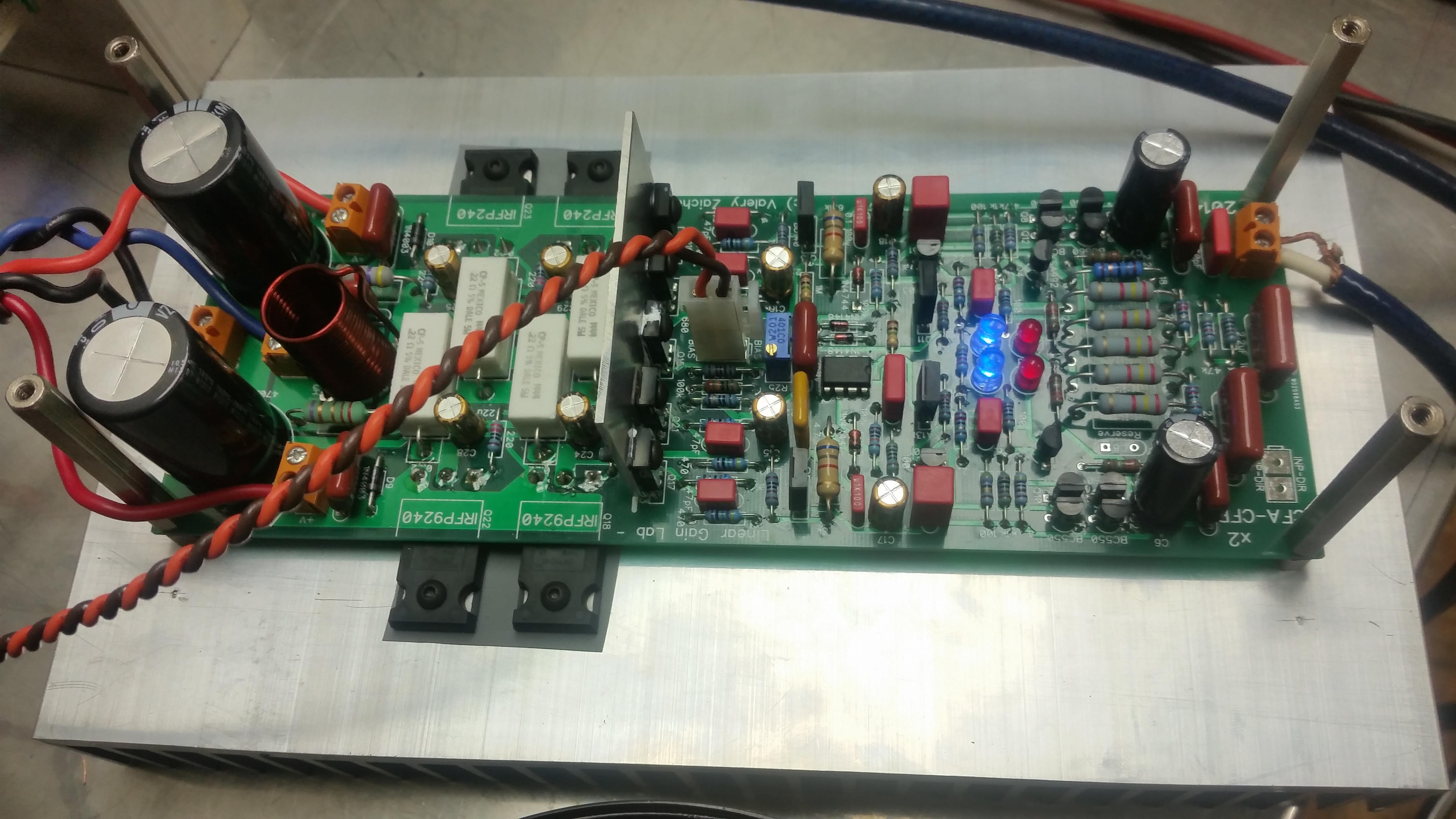

I think I had one channel go into oscillation after first connecting inputs and speakers. It had a bad 60hz buzz, then the protection board tripped from overcurrent.😎 I shorted the input to check it out and haven't had an issue since. New scope hopefully arrives tomorrow. I've purposely tried to induce noise into it. Very good rejection. It's silent. Time for a chassis and a test drive at home.

I would also recommend a small metal plate for the VAS cascode transistors - TO-126s near the blue LEDs.

I have some clip ons for them. Just need to figure out where I put them. Bias current keeps dropping on me. I need to get them warmed up properly and set them again. I think the driver heat sink may be too large. Too slow. Obviously I'm not driving them hard but the whole amp hardly warms up.

It's ok for this kind of design. My prototype fully settles in about 10 minutes.
Optimal quiescent current is around 35mA (rather low). After power-on it goes a bit higher and then comes back and settles. Distortion level is very low even during this process...

Measure a voltage drop on R26 from time zero (power on), no-signal warming up and later with 20 Vrms on the output. This will give you an impression of how VAS bias is fluctating regarding all possible conditions, you'll be amazed about the differences in response of VAS bias, caused by delta Vbe/temp of the input pair.

I'll try that next time I start it up.

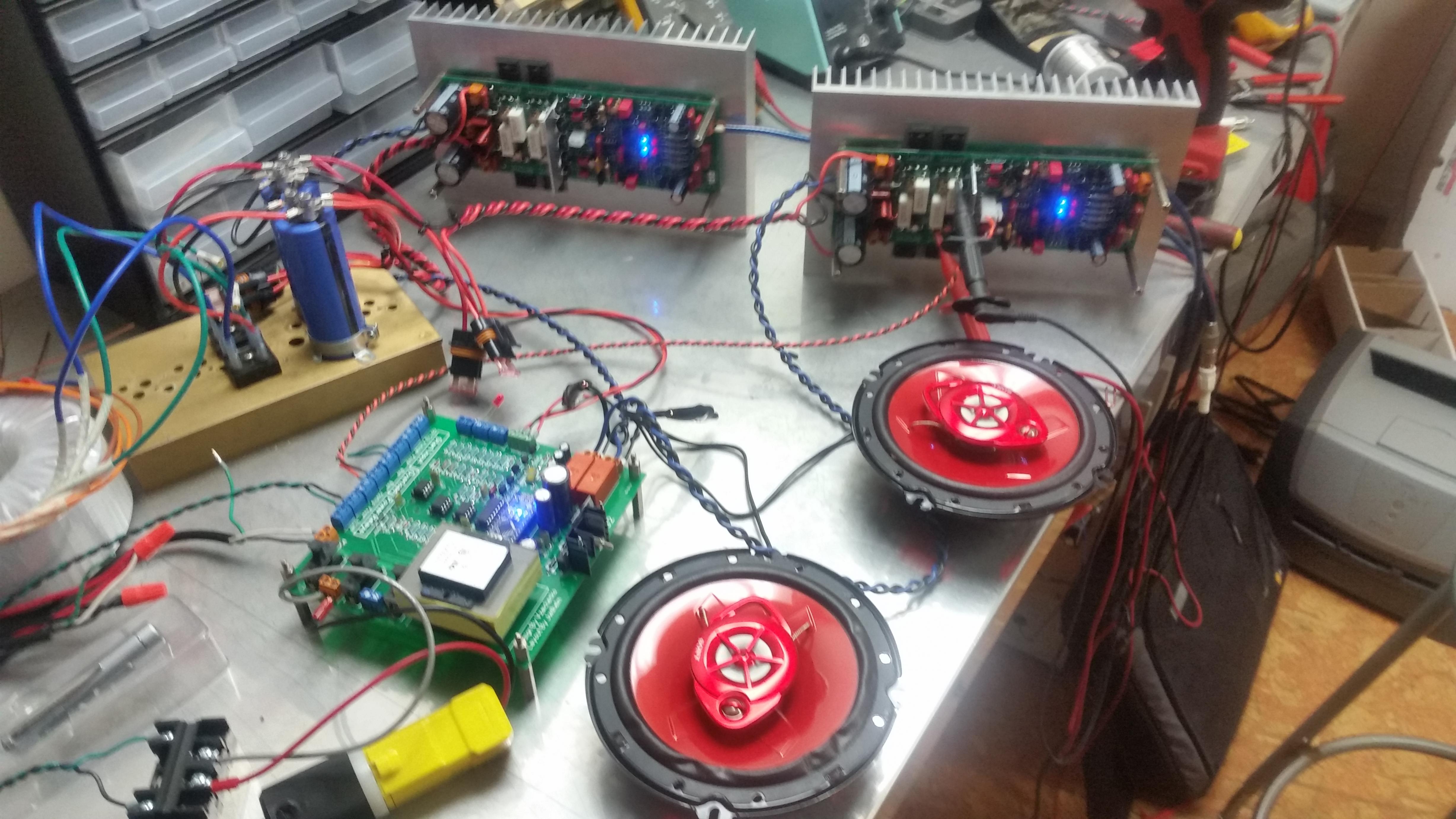

I broke down and dragged this one home without a chassis for a test drive. Sounds excellent. It's very detailed even at low volume levels (this is the first amp I've ever found this😀). It's pretty particular about input cabling though. It will go into oscillation if everything isn't perfect. That probably goes along with being very detailed though. Now I just need to figure out how to keep my stupid cat from electrocuting itself.
Hi Jeff, interesting - I didn't notice this specialty with regards to input cabling. Maybe I just had the right cabling all the time - I don't know 🙂

Yes, it's got excellent control over the speaker even at very low volume. Also - distortion level doesn't grow at low levels here.

Damn cat just tested the short circuit abilities of the output devices. It just tripped the overload on the protection board. No damage anywhere. No blown fuses even.
