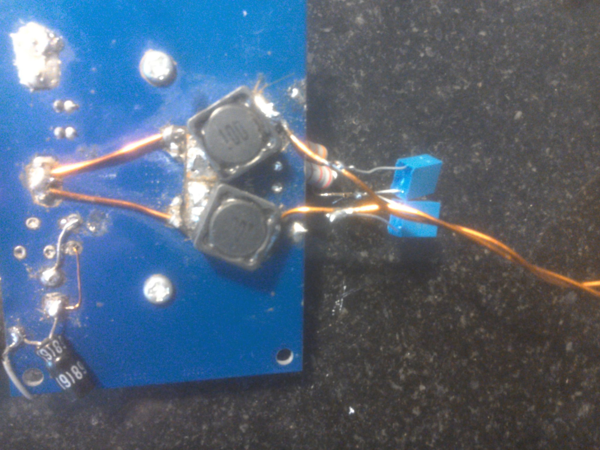

I worked on TPA3116 in pbtl to make it sound ultra clean as TPA3110. The bottleneck was the distance separating the inductors from the chip because of the heatsink. I drilled holes to wire the inductors from the bottom side and the resolution became as good as TPA3110. I listened several hours without any fatigue or ear whistling, but not a single time I was attracted by a spectacular sound as is the case with its sibling. I suppose the lower frequency 300khz of 3110 vs 400khz of the 3116 is the advantage. In BD mod. the lower is the clock the better is.
This experiment now convinces me that there is no any Chinese miracle transfer function, it is inherent to TI technology.
