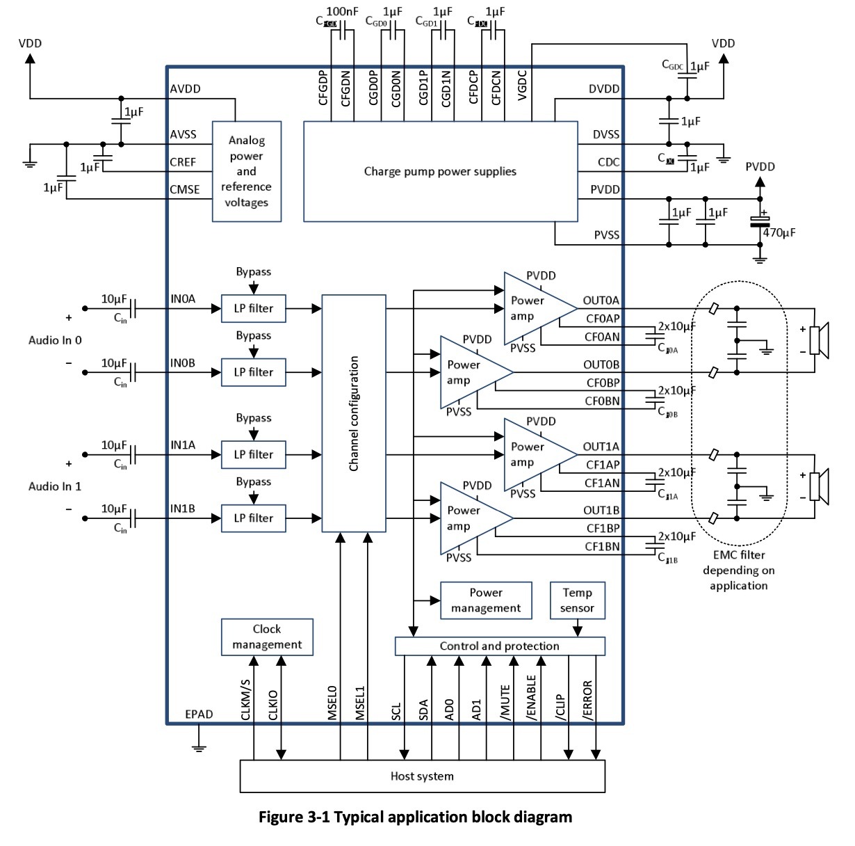

The TPA3255.

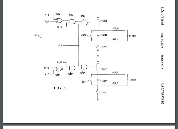

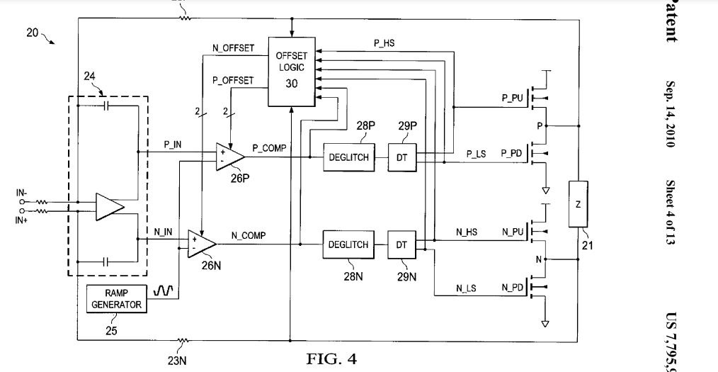

The 325X series are similar to TPA3221 with advanced loop filter added with error corrector. The patent bellow I think is the one implemented. The circuit shows adding an offset on either branch of BTL to apply positive or negative offset. This good news means in SE mode the error corrector cannot function hence disabled. If I look the distortion curves, indeed in SE mode is higher, even higher than the TPA3221 in BTL mode. What I find strange is the power capabilities of this chip. On YouTube I see with 2X68W for 8 ohms and 1X90W in PBTL. Above, the chip goes into protection due to overheat. The amp I ordered recommends to use it with 36V, I am disappointed for the price $22 cost where the TDA7498e board does the same for $12.

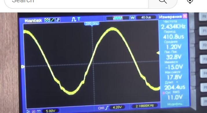

A NZ fellow measures the TPA3255 with 45V supply and gets clip light off at 25Vrms that is 35V peak giving nothing but 72W. How is this possible. The DS recommends 53.5V insane volts, where I got wrong? 6:25
Known problem of almost all TPA32xx, especially on cheap cards... At 25 dollars...

There is something fishy in this story. With 25Vrms on 8 ohm is 3.125Arms. There are four switches on each channel of 0.1 ohm max. this gives max dissipation of 7.8W. Say that such size of heatsink cannot cool it bellow 125° has certainly error in filter design.
I would not rely on adequate cooling on an al-cheapo pcb.There is something fishy in this story. With 25Vrms on 8 ohm is 3.125Arms. There are four switches on each channel of 0.1 ohm max. this gives max dissipation of 7.8W. Say that such size of heatsink cannot cool it bellow 125° has certainly error in filter design.

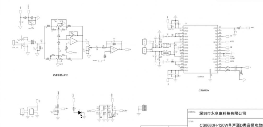

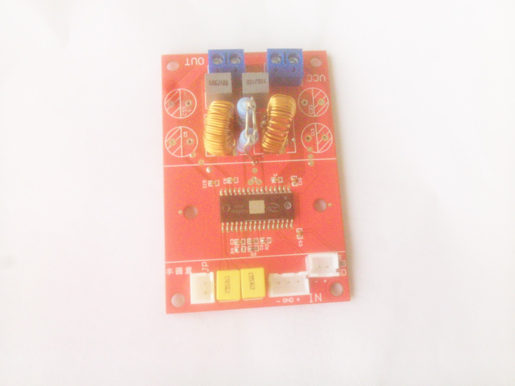

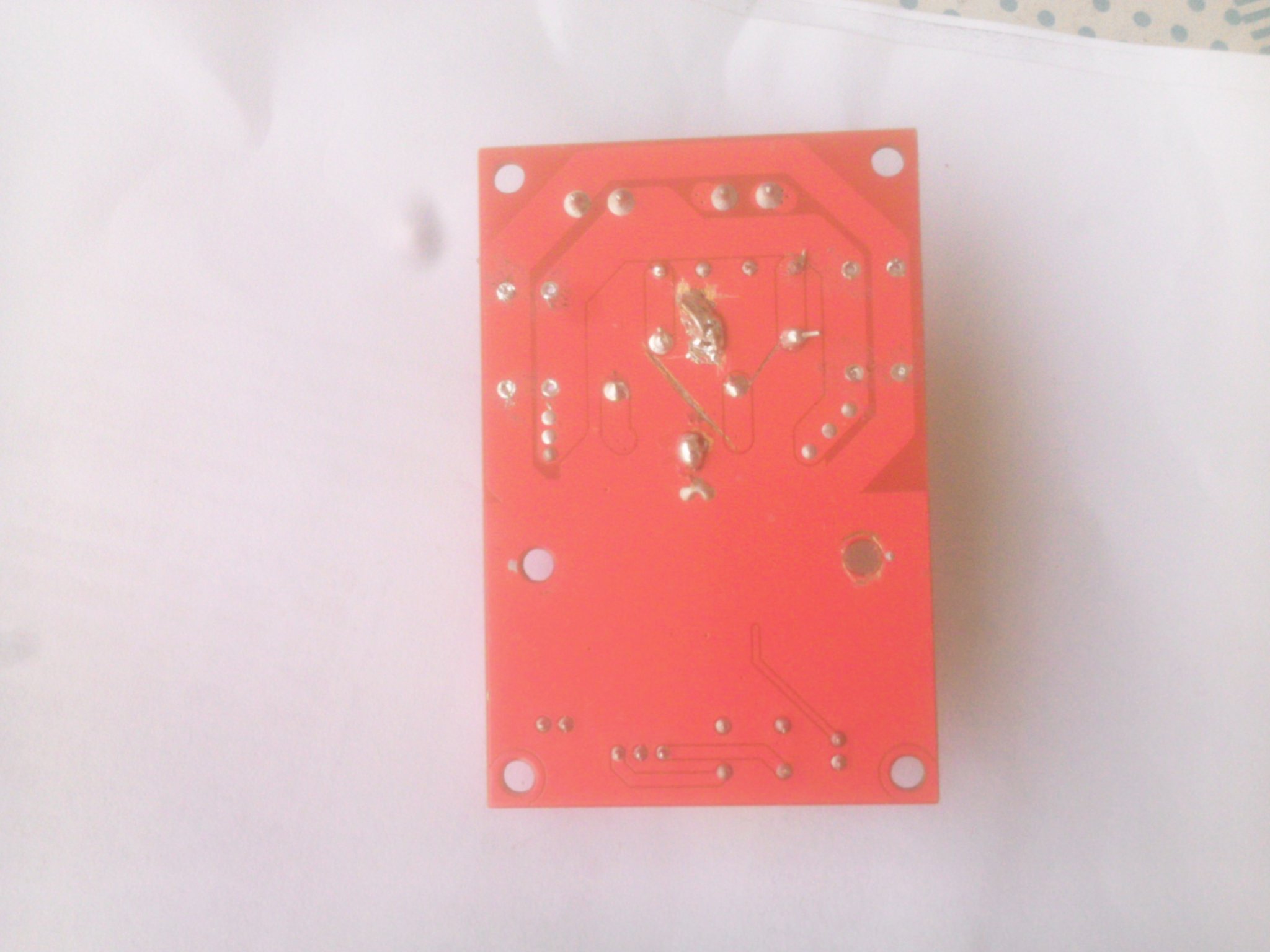

In waiting the TPA3255, I started converting the CS8683. This Chinese chip is very scarce to find, only one type of board available with two inductor flavor. The chip alone, I can't find, the mono board cost me total, about $6. Low voltage electrolytics need to be changed as this chip is designed to function with 36V. The frequency needs to be adjusted by shorting un applied R2, I unwind 18 turns the inductors to be 10uH. The ground linking the two output capacitors are cut on both sides of the board and a pair of 100 ohms/2W in series or 390 ohms in parallel is inserted to ground the capacitors.
On Chinese forum, I found an unclear image of the evaluation board, as TPA3116 that it imitates, the gain can be reduced by adding in series resistors to the inputs as the gain is 40 times or 32db.

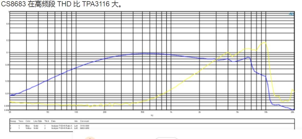

Those who like to read numbers, this chip can go down to 0.005% THD+N at frequencies bellow 1khz.
I am hoping that it has the same extraordinary transfer function as the Chinese TPA3110, presuming to be the same manufacturer.
I did this with one of my 3118 boards and can confirm what I encountered years ago, having this same idea: Beginnung with 10R series resonance, THD increases dramatically vs series resistance. There is a reason nobody applies this "ingenious" mod.
