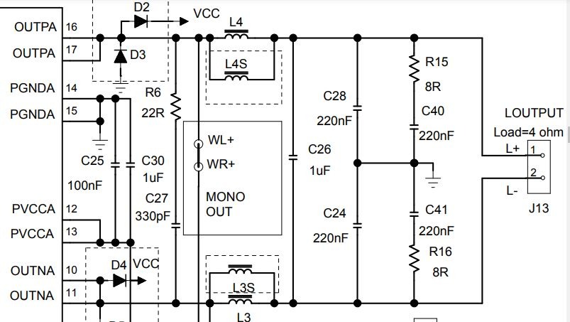

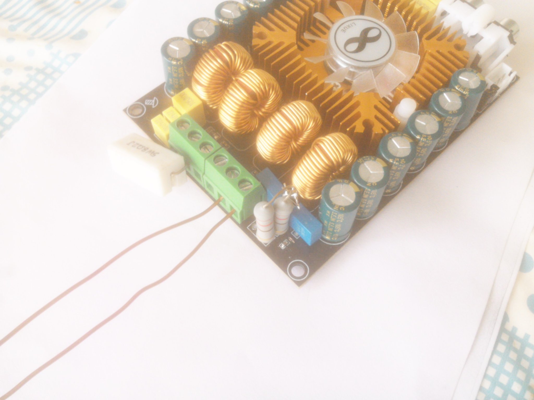

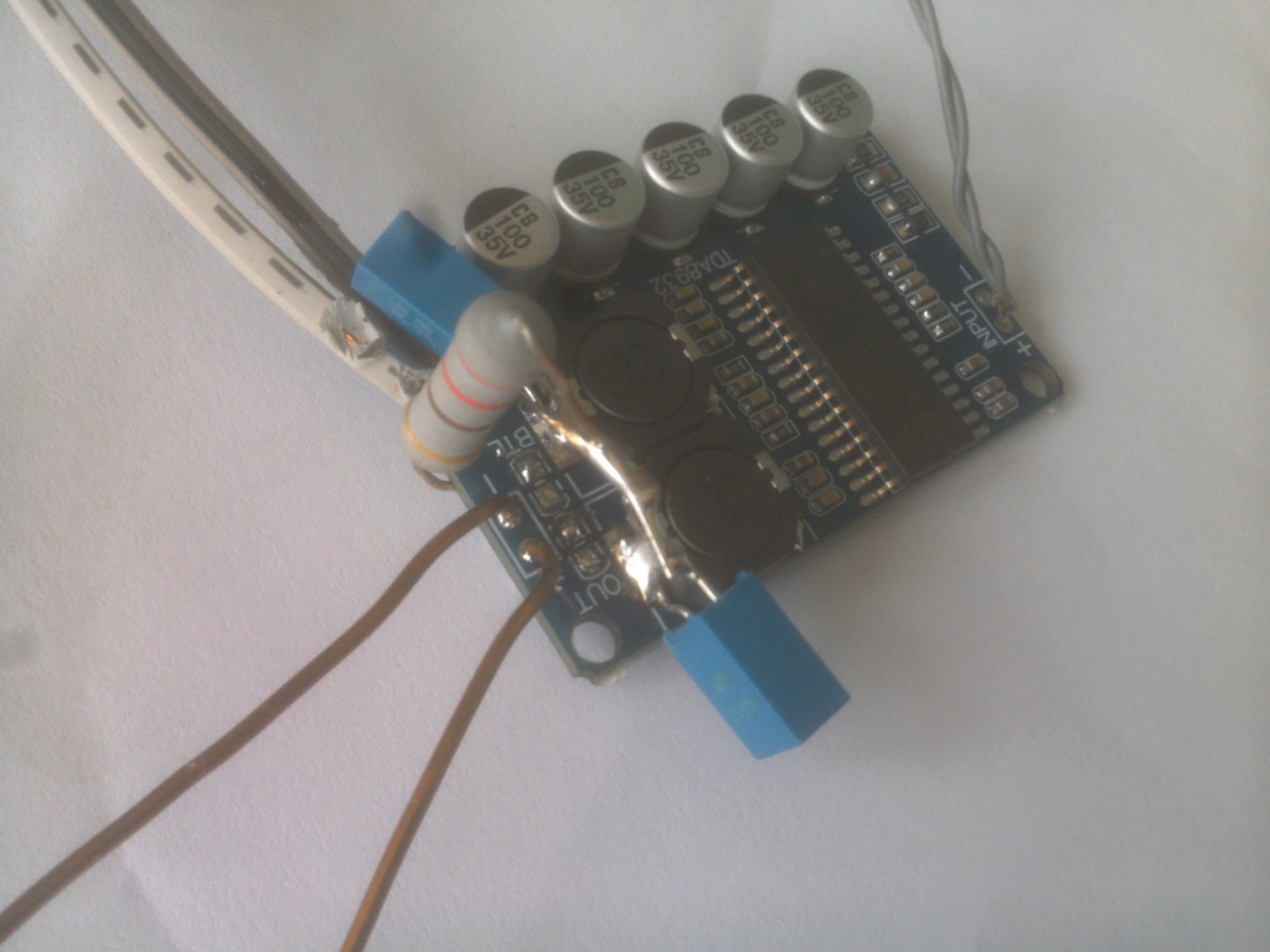

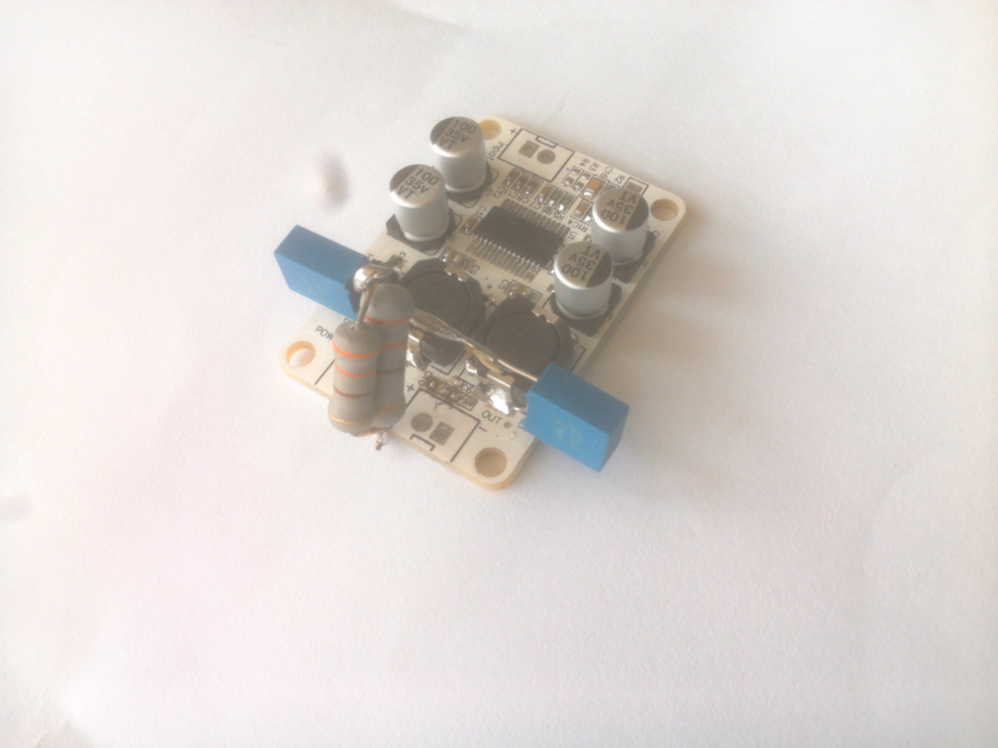

I worked on TPA3116 in pbtl to make it sound ultra clean as TPA3110. The bottleneck was the distance separating the inductors from the chip because of the heatsink. I drilled holes to wire the inductors from the bottom side and the resolution became as good as TPA3110. I listened several hours without any fatigue or ear whistling, but not a single time I was attracted by a spectacular sound as is the case with its sibling. I suppose the lower frequency 300khz of 3110 vs 400khz of the 3116 is the advantage. In BD mod. the lower is the clock the better is.
This experiment now convinces me that there is no any Chinese miracle transfer function, it is inherent to TI technology.

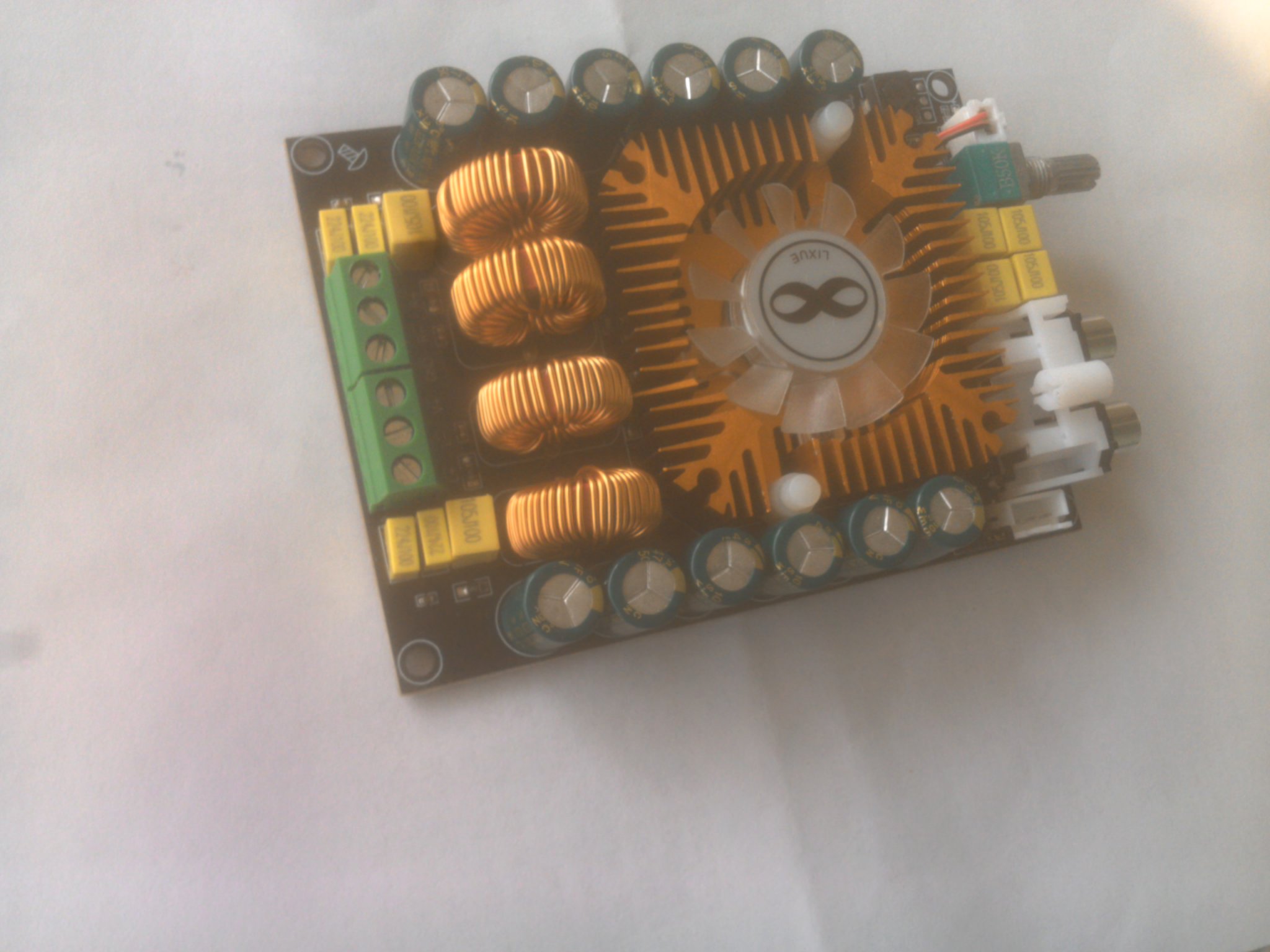

What concerns the CS8683, I couldn't make it sound ultra clean. For the cost of a pair better get the TDA7498e.

$20 without and $24 with BT5. In description gives distortion numbers that looks to be pffb. Will it be easy to make it 4x SE? but I don't have much hope to make it as spectacular as the 3110.
I will use the TPA3110 as driver to power STA516B in PBTL mono, I am hoping to get at least the same sound with 100w/8ohm.

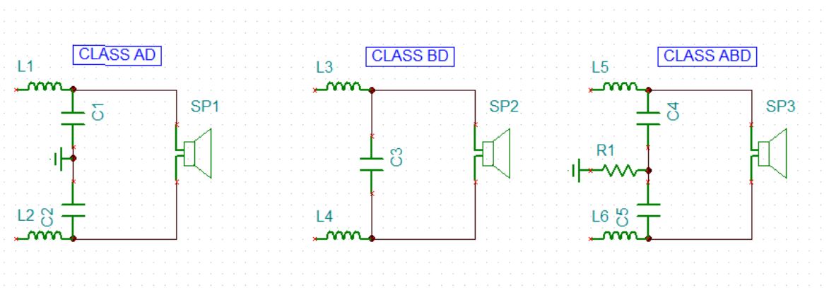

- Class D
- Convert your class D into ABD modulation
