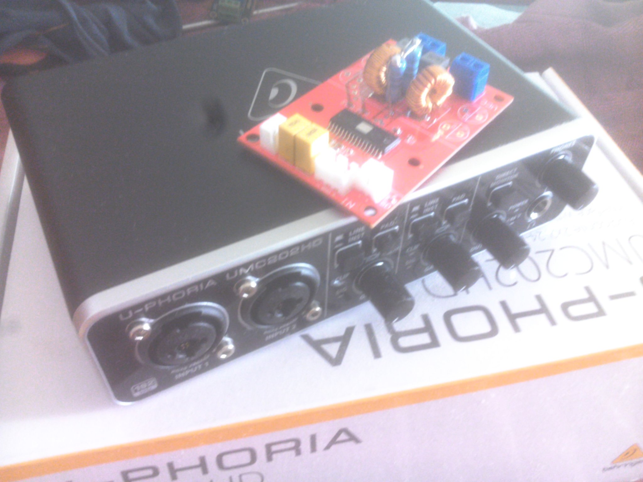

I do have a Behringer UM202 to measure in differential, unfortunately the keyboard of my MSI lap top is stuck. Most amplifiers I converted, have been measured by many, it can only be better specially at low power.

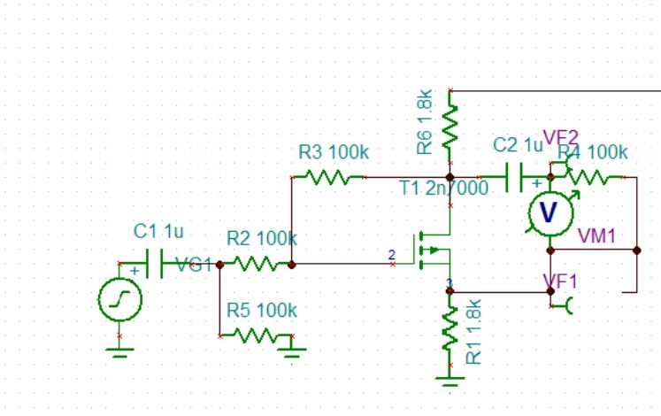

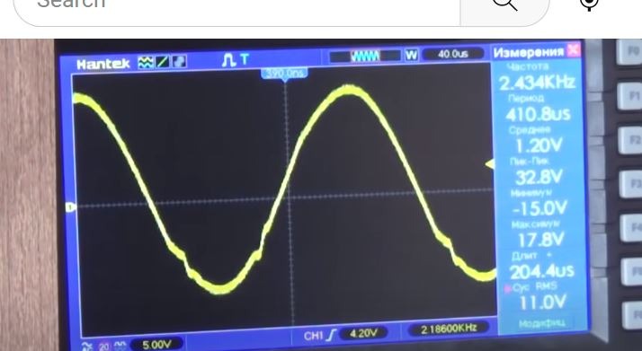

Distortion numbers do not speak about sound quality. This what I show. What makes it sound bad is the data loss that the ear cannot correct. It happens with crossover, saturation and shown on the signal bellow, dead time when the signal is cut. With analog amplifiers is possible to inject harmonics but not the case with class D. For TPA3255, I prepared a phase splitter instead of opamps that inject 0.02% 2nd harmonics to the signal, in sort of adding sugar to a lemonade.
Retry adding resistor of 120 ohm on the board bellow and listen and measure again.

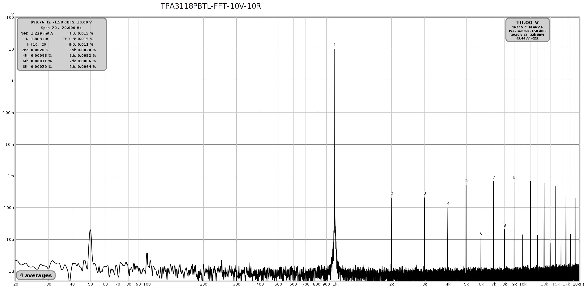

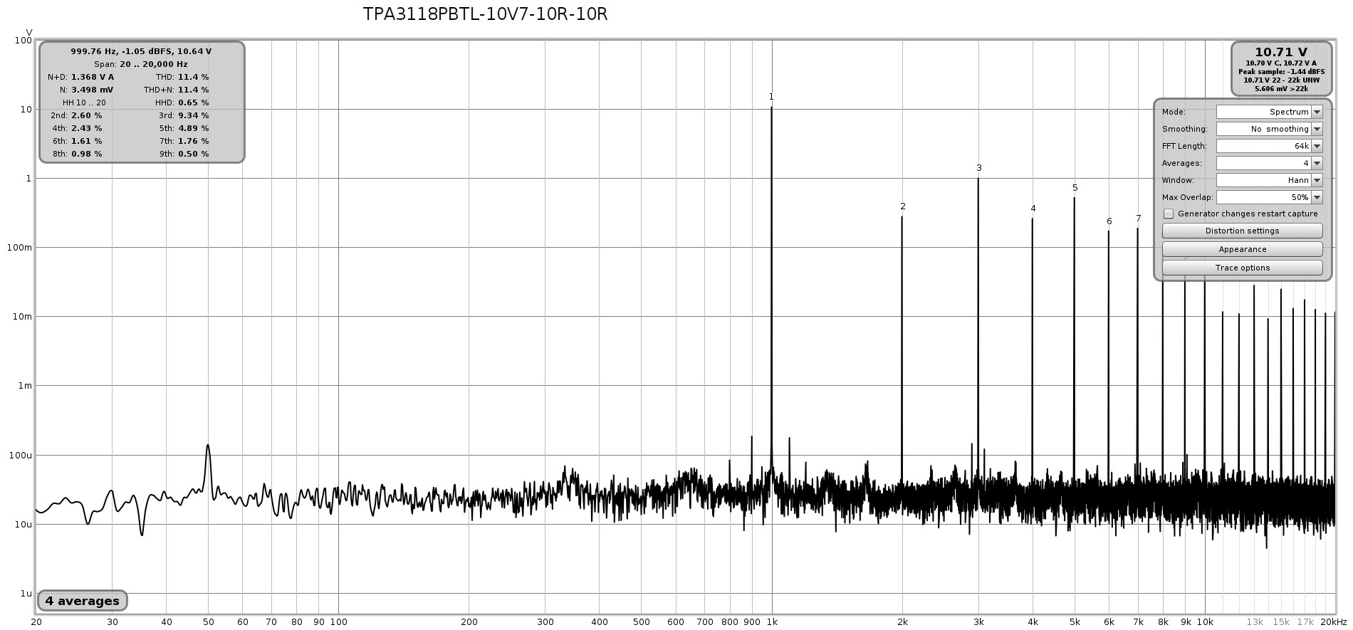

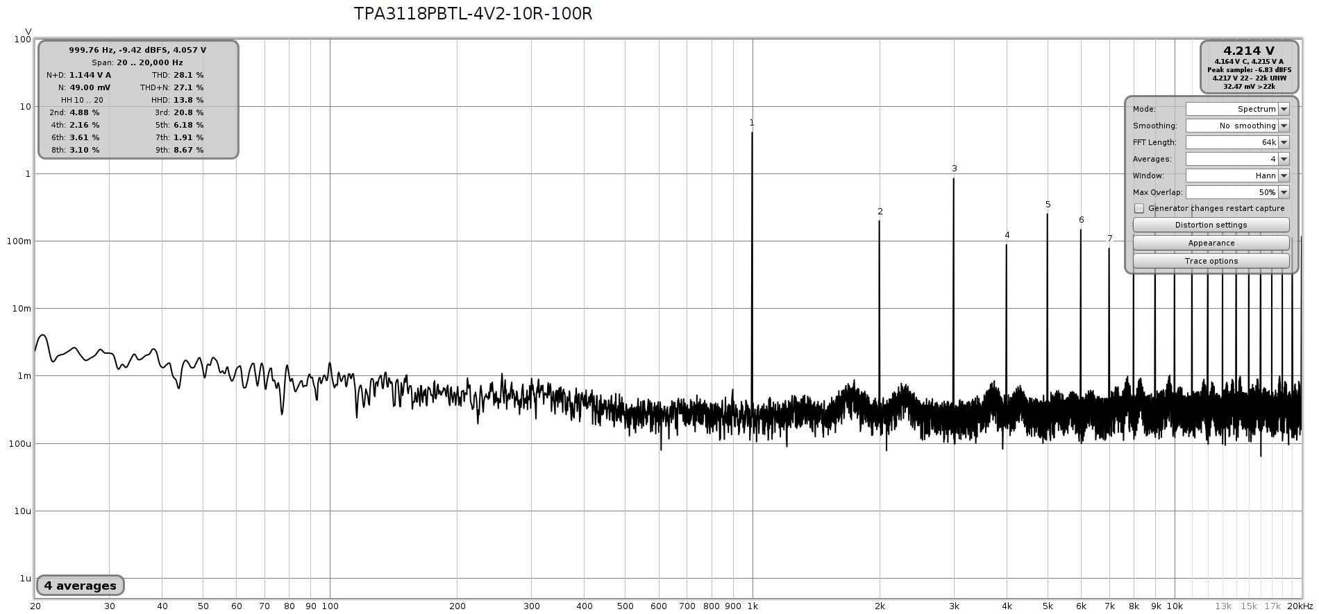

Here are THD-plots I took 2 days ago testing my TPA3118 PBTL module operating in BD-mode, powered with 18V= feeding 1kHz/10Vrms into 10R dummy load. With all settings untouched you find the result with 0R, 10R and 100R. This tells more about this promising mod than any comment.
27% distortion is visible on scope with sine wave, and I don't see my deformation on sine wave specially such high 2nd harmonic should make it vertically dissymmetric . Why perfectly symmetrical output would generate dissymmetric distortion? Something wrong in your differential measuring, probably you are using single ended input sound card.
I'll try to fix my laptop and measure it.
