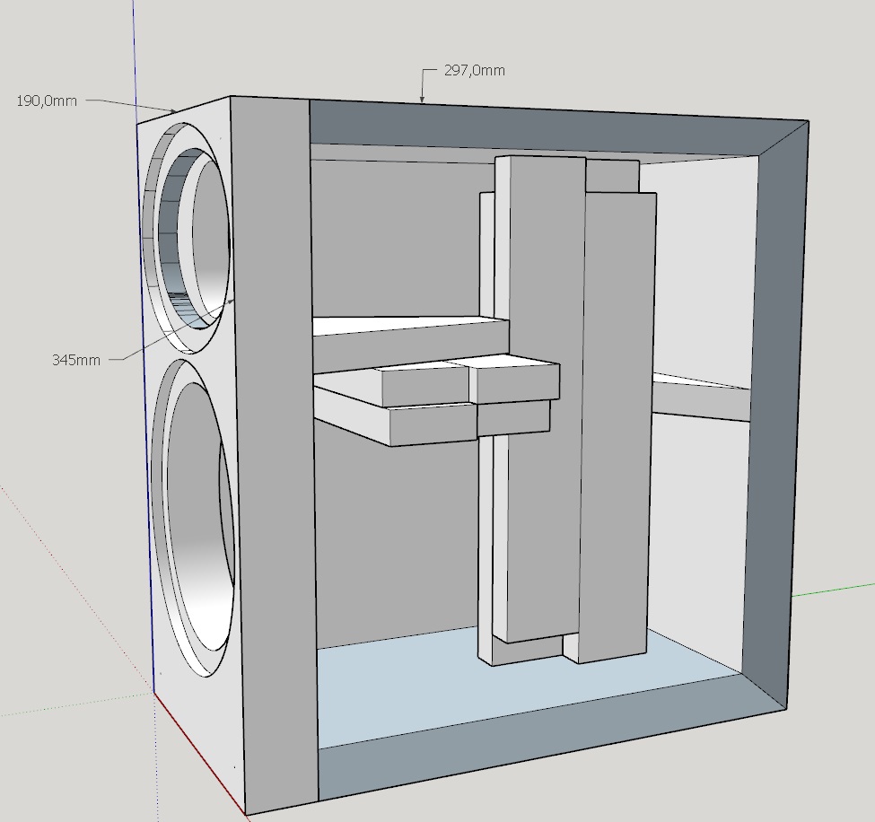

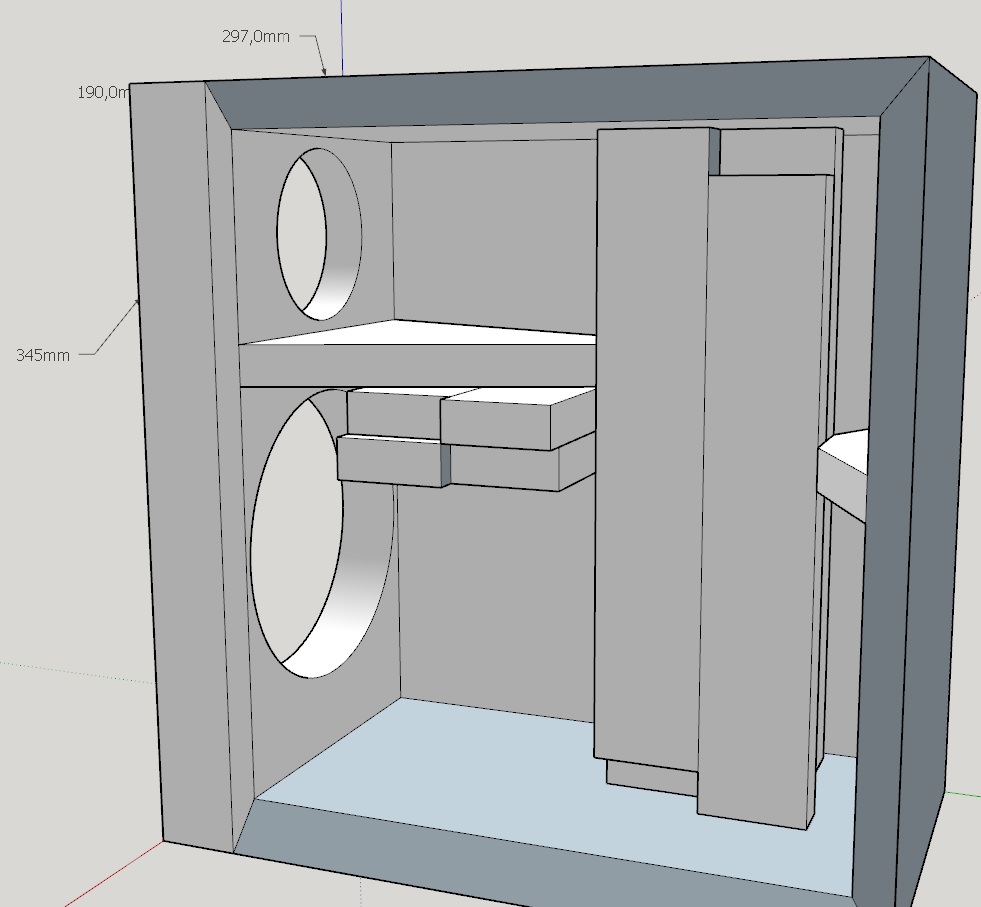

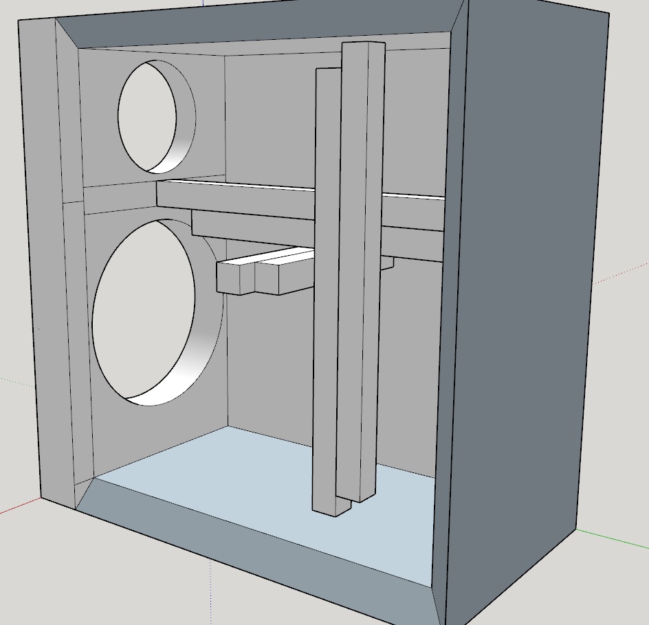

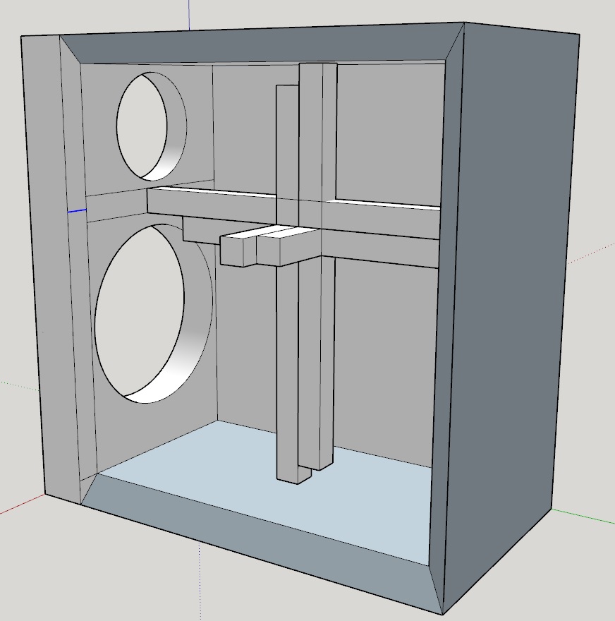

I have been sketching up a 2-way box in Sketchup. After reading Mr. Gedlee his patent and all the tips from this thread. Below you can see the result.
The braces for the top- and bottom panel, as well as the side panels-braces were made from 4 panels. This is done with the thought that the shear dampen forces are now possible in two axes instead of one. To not clutter the box too much, the baffle and backpanel-brace are connected to the other two.
I would really appreciate any feedback on this.

Looks like something I once considered. It can be humbling to remember that some resonances can be damped by touching a panel in one place with the tip of a finger.I would really appreciate any feedback on this.
It looks very sturdy designed. Did this one make it in real/physical life?
You have the right idea, but I don;t see the need for such large braces. The braces act in tension and compression where materails tend to be quite strong. In my speakers the cross braces are only 1" x 1", which is more than enough, especially if they are oak.I have been sketching up a 2-way box in Sketchup. After reading Mr. Gedlee his patent and all the tips from this thread. Below you can see the result.
My approach is this. Think of a strong X-brace from front to back and side to side, but instead of connecting each end to its panel, you double them up along their length with CLD and attach only the "floating" part to the panels. This technique works very well. There should be no connections from any panel to the brace or other panels that do not go through the elastic absorber.
The best place for this brace to attach is in the exact middle of each panel. This offers maximum effect.

Thank you for your feedback.You have the right idea, but I don;t see the need for such large braces. The braces act in tension and compression where materails tend to be quite strong. In my speakers the cross braces are only 1" x 1", which is more than enough, especially if they are oak.

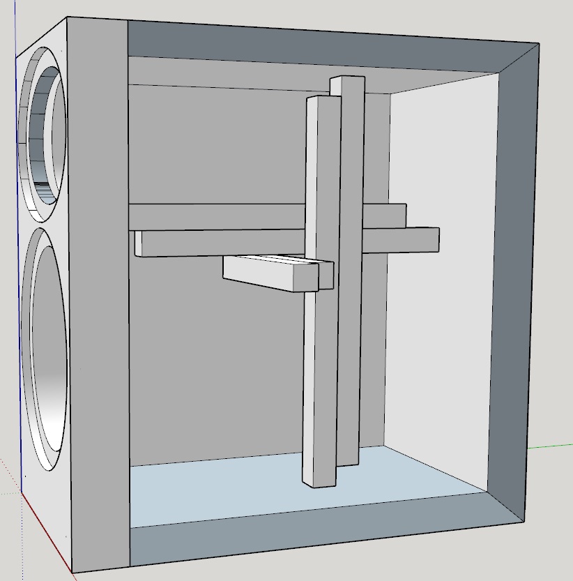

Do you mean this kind of bracing would be enough? (See images below) No braces are touching each other, only the ones in the same axes, but it's hard to see.
Close. All the braces should be joined together at the center creating a fixed point in three dimensions. Then the legs are isolated from this fixed point.

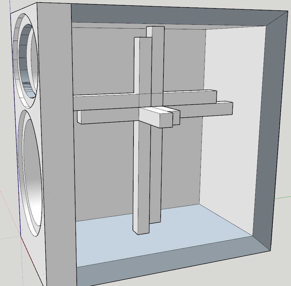

Third time is the charm, hopefully...Close. All the braces should be joined together at the center creating a fixed point in three dimensions. Then the legs are isolated from this fixed point.
Do you mean this? See below.
