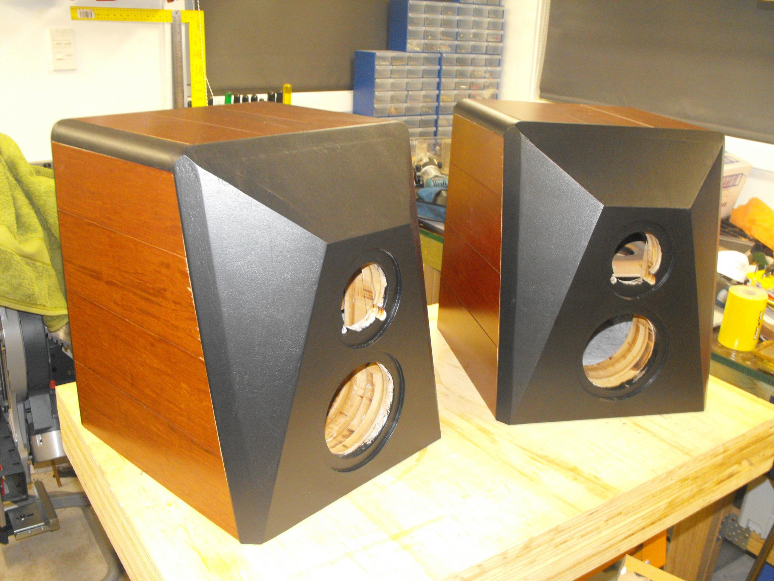

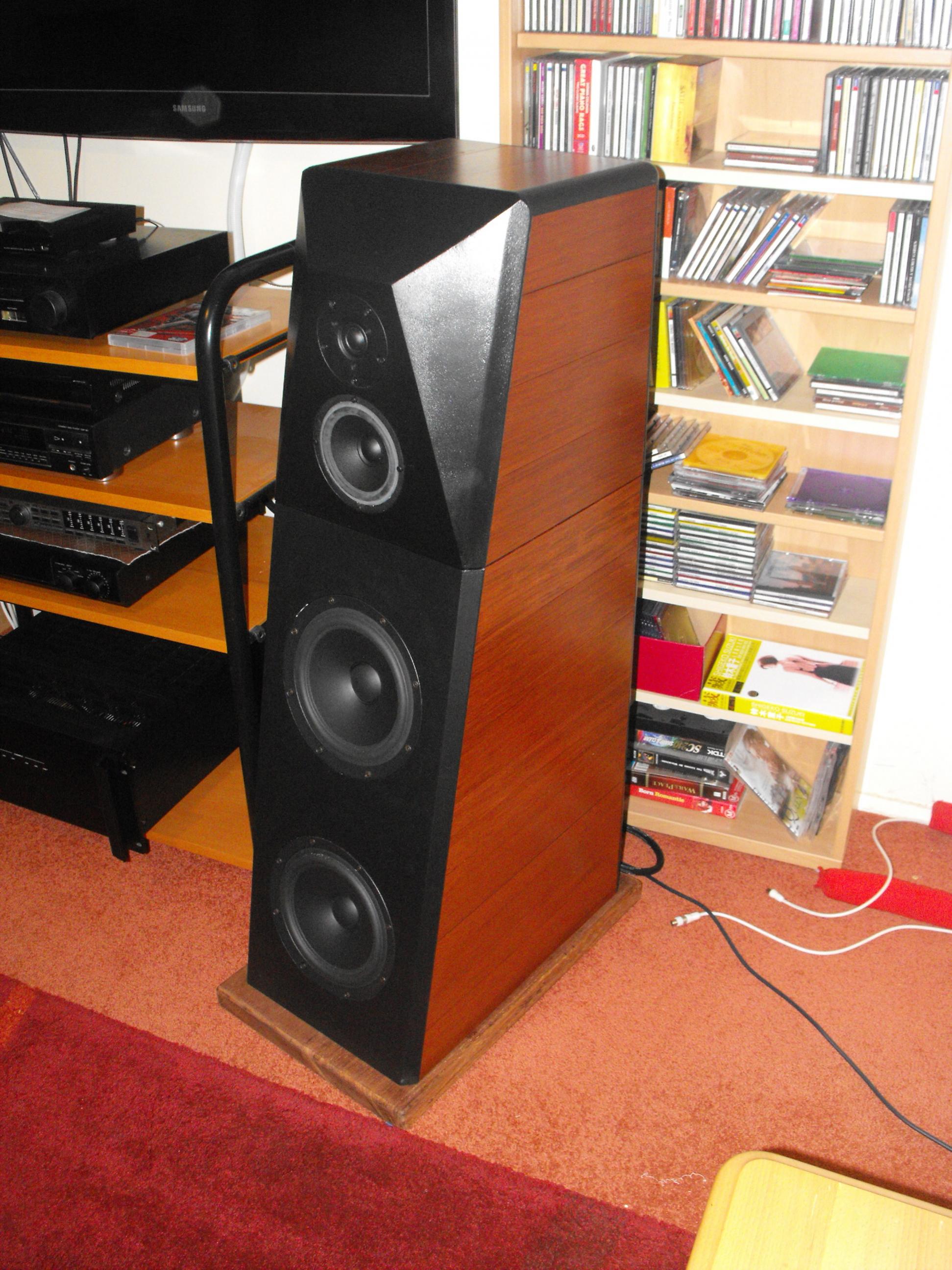

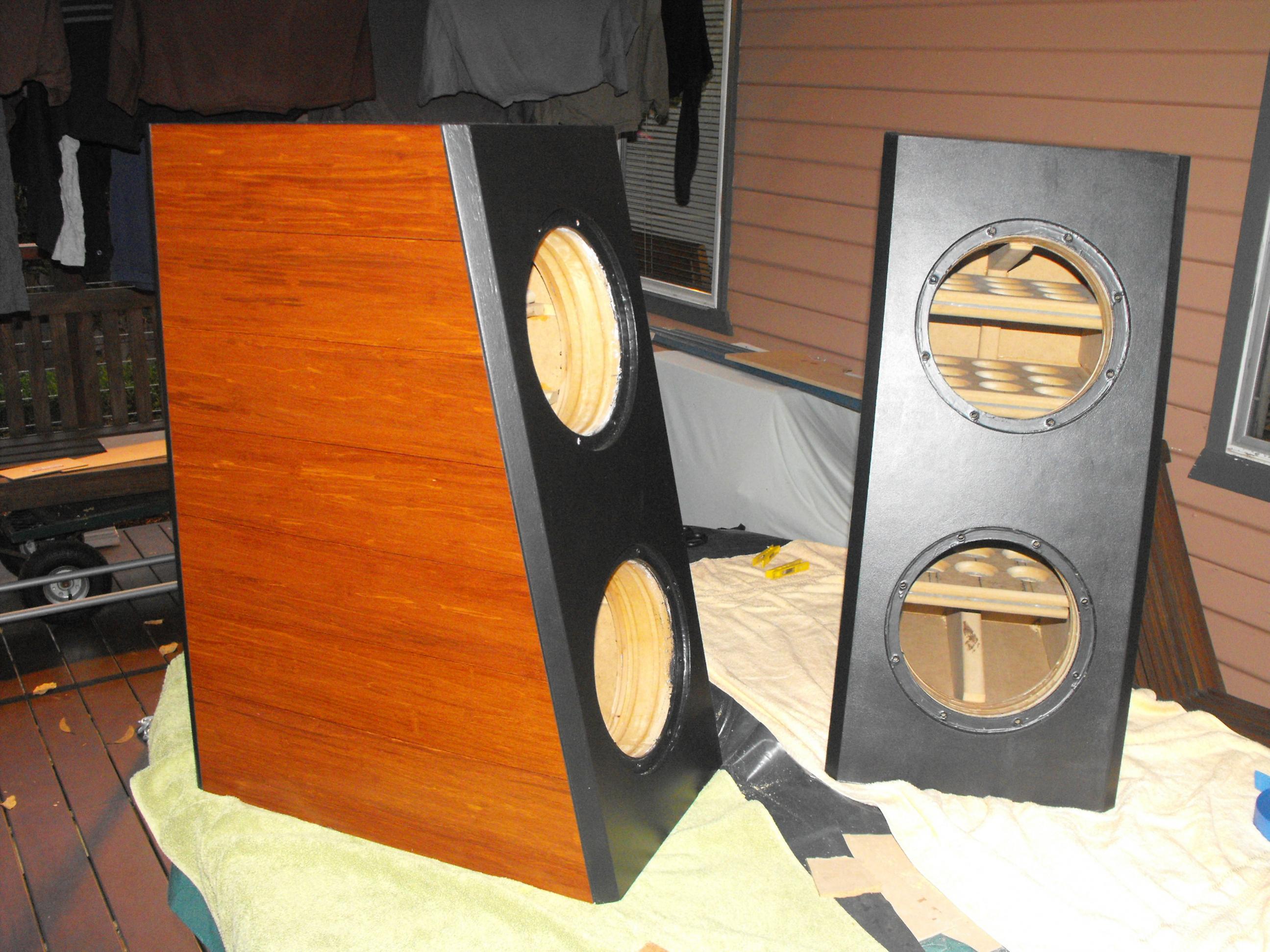

This thread seems to be wandering from the question of whether constrained layer box construction works and how best to implement it. This is separate to the question of isolating the the box from driver induced vibration with compliant mounting. KEF and others tried this in the '70's and abandoned the technique. To my knowledge no-one is still seriously using this technology. It goes against the physics of accurately converting the electrical input into cone motion.
IME the most problematic enclosure vibrations are induced by bass frequencies. When the woofer enclosure is a separate box, which is acoustically isolated from the mid/tweeter box, the problematic enclosure vibrations are confined to the woofer box. Of course this is not an option with a 2-way design. Physically separating the woofer enclosure has the benefit of reducing the intermodulation effects of woofer induced vibration on the mid/tweeter outputs.
There is still the issue of air pressure induced woofer enclosure vibration (box pumping), especially in a sealed bass enclosure. This is where bracing+CLD can make a significant improvement. Bracing raises the enclosure resonant frequencies where the CLD is most effective.

Hi Earl. I appreciate your insights. I agree with your comments about front mounted woofers. I take the mass+stiffness+securely grounded woofers mantra very seriously. In fact, if you look at my post #267, the first photo shows a side view of the front woofer baffle thickness. It is at least 3" (75mm) thick. The fasteners are 5mm hardened steel bolts into rear embedded inserts. It is this type of build that got me looking at other solutions, which don't require such extreme bass enclosures. This is how I arrived at the reaction cancelling opposed drivers. As mentioned previously, even with a stiff enclosure, the internal air pressure flexing can still benefit from CLD.
