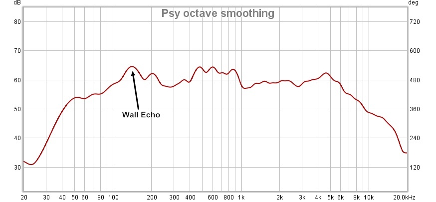

I recently ran into a problem with a new installation that had both my friend and I quite confused... there was a 10db bulge in the SPL scanns of his new speakers. But where the heck was it coming from?
It took a few days to figure out, but it was a wall that was being extremely reactive to sound. At about 100hz it vibrated like a drum head... but only from certain spots in the room, and it echoed voices rather badly.
813971d1580762217-troublesome-wall-echo-jpg
My point was that you probably do need to analyse the baffle as well, to know what it's effects (or lack there of) really are.
